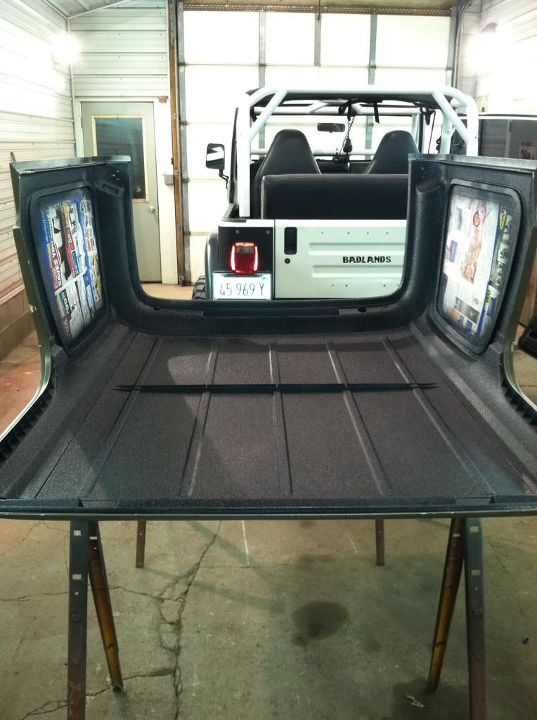

I am really happy with my raptor u-pol about 110 and that included the gun. Did the inside of my hard top too.

MROLSON1, Looks great, but I can't help to notice your better half in the background of the first picture. She looks pissed!!!
If you don't mind I wold like to use this picture and put 20 seconds on the clock like Tosh.O. Who can come up with the best comment...........

I think it's cause he used her sale flyers to mask off the windows in the hard top

Haha I just noticed her in the picture, she is actually my friends girlfriend and I think she is pissed cause he was spendin to much time in the garage
