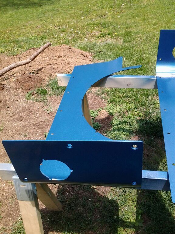

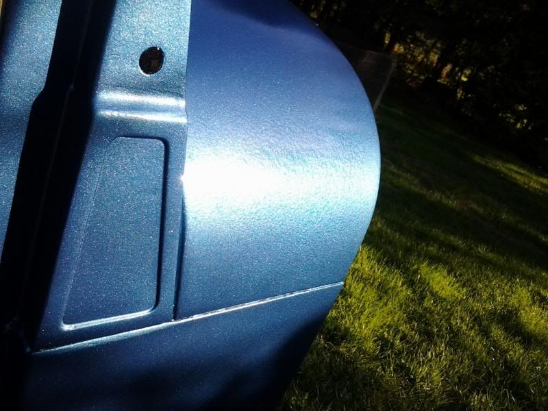

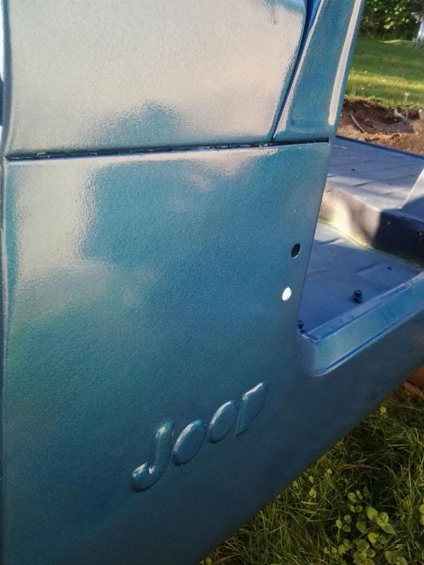

Guys looking for some tips here. I sprayed my Jeep with a single stage acrylic enamel metallic by Trinity 1945 and the gloss could be better. It is smooth with very little orange peel but I would like it glossier. So I am ready to spray over it with their acrylic enamel clearcoat. My question is should I lightly sand the paint with 2000 before I spray the clear, or do I just clear it then sand it with 2000 when the clear dries? I know I am past the paint window for clear since I sprayed everything yesterday. Thanks for help

Lightly sand, new final coat of color, then Clear coat within the window. Bad adhesion if you miss the window. Ever notice all the cars with peeling clear that looks absolutely horrible? You're doing a lot of work just to end up with a bad paint job.

Been through their paints years ago,never a good shine from their paints..always kinda of a "blah" finish..
I think your best bet is to do a 600 sand since your way past the recoat window and if you have any left spray another color coat,then spray the clear within in the recoat window for a good bond,did a tractor with their acrylic enamel and did the same as you and then just did a light sand and cleared,the clear pealed from the color a year later....
Do your clear..then sand n buff..thats the best shine you'll get out of that paint.

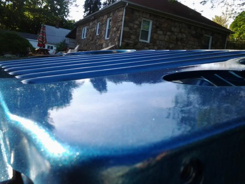

Hard to say how much shinier it will get. Quick and easy test, pour some water over the finish and see how it glosses. Water will simulate clear, to an extent anyways. Just remember that this is 'wet' and you will get something shinier than most clear finishes. It gets you in the mental ballpark though.
If it's not an OMG difference do some color sanding and polish on a panel and see how that looks. Taking out the orange peel alone can do wonders.

Lookin at it all closer now,looks like you might of sprayed it a little too dry or held the gun too far away..just do a good sand and re-coat and add a clear coat.

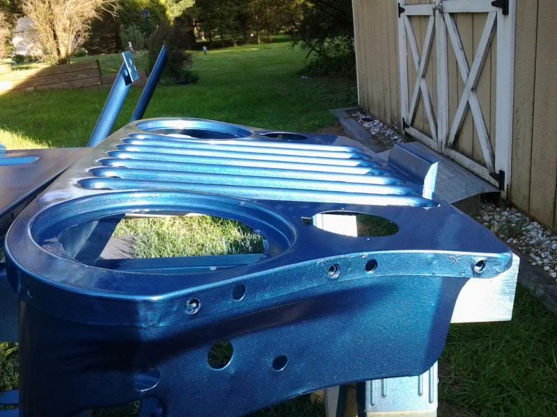

75 is way too high. Most paints will go betwen 30-40psi with a regular gun. You want to use just enough pressure to get an even pattern, the paint mfg should have a guideline on the paint itself along with what reducers to use. Shooting metallics is more of a fine line as well, too much pressure or too close will bury the metal in the paint and you'll lose the metal.
ALL paintjobs will have orange peel, look at any car on the lot and you'll see it. Color sand and polish gets rid of it. If you go with a clear worry about it then, dont worry about the orange in the color coat.

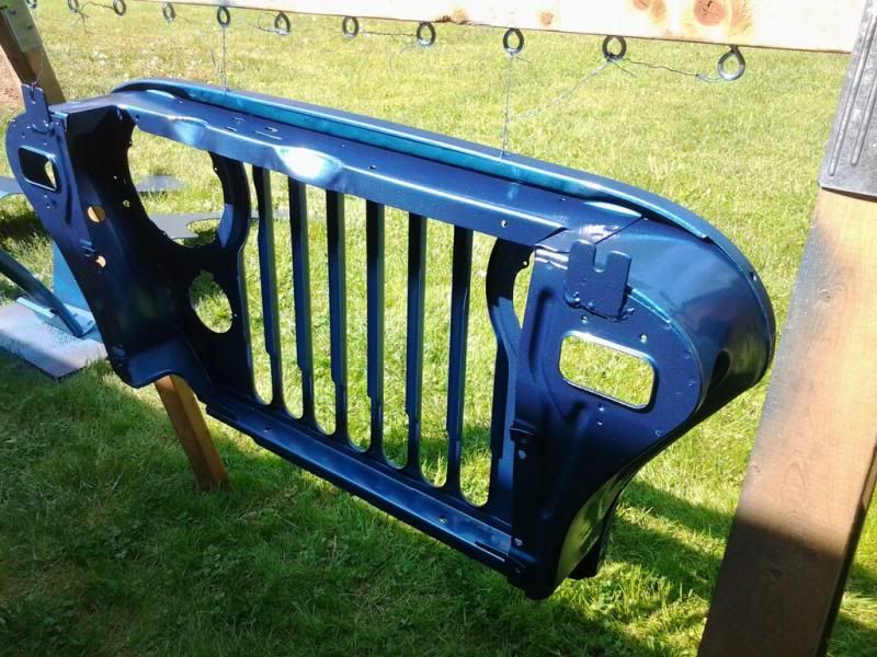

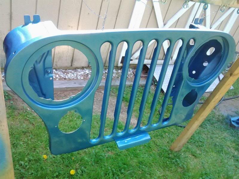

Thanks Iron for Barry's site, I'll have to check that out. So I adjusted the gun to 35psi. Definitely wetter and better but got some peel on the sides. The grill didn't come out too bad. I also am using a different acrylic enamel reducer by MSA from Napa. I know I prolly should have shot the clear but I didn't b/c I didn't want to shoot it over the orange peel. If I can get this paint to lay a little flatter by just buffing it out, then I'll leave it. If not then I'll reshoot and I'll hit it with the clear right away. Thanks for your help guys, I gotta play with it a little more but I'm getting closer
