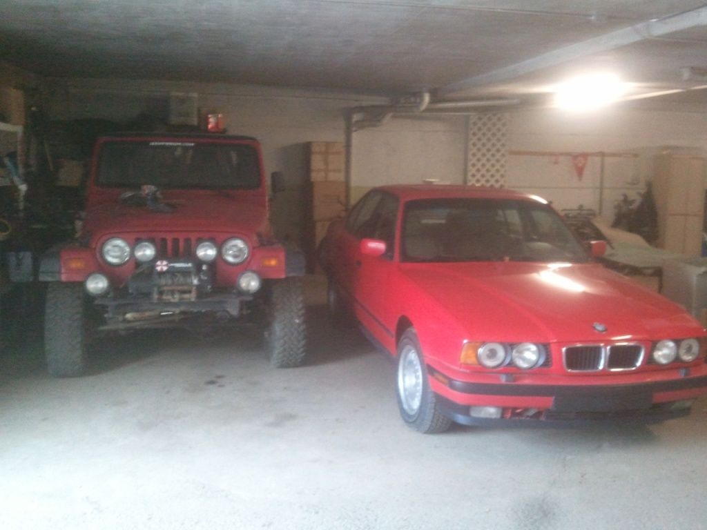

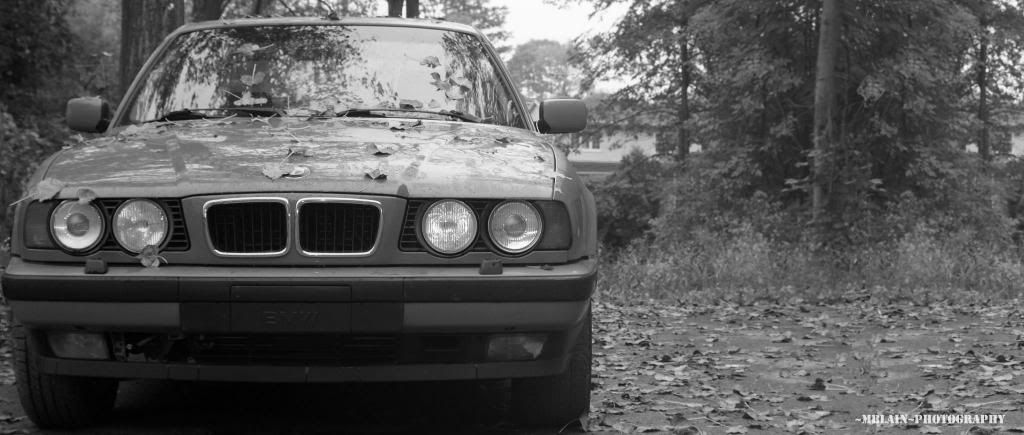

I picked up this red Bmw in october of 2012, it was the first European car that I have owned. Ive only owned American vehicles prior.
I swapped a 1987 F-150
For this:
Apon driving it for the first time I fell in love with its power and maneuverability, Its fast with its 5 speed manual gearbox. The 3.0L V8 runs great.

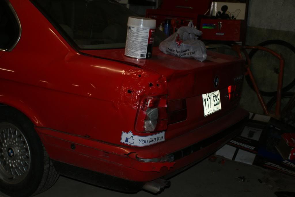

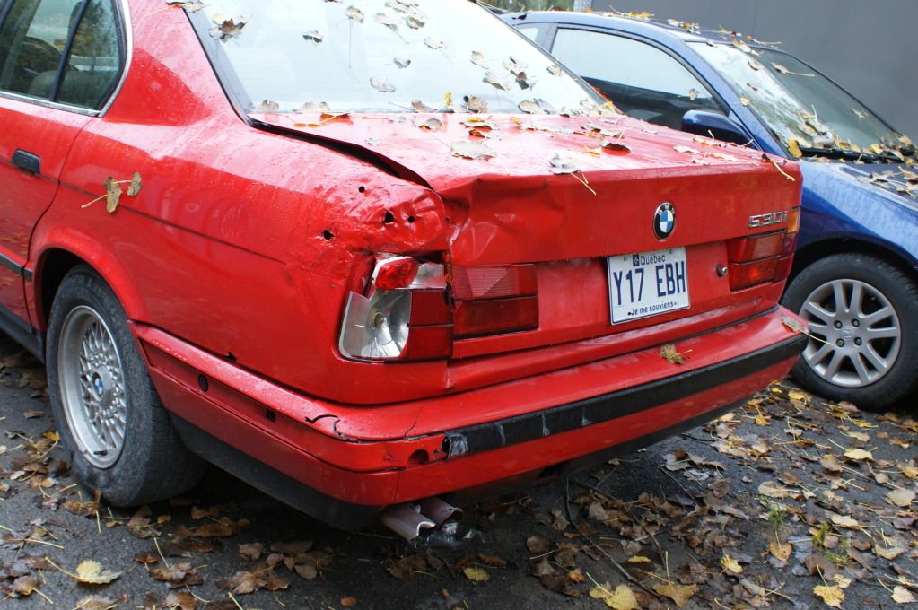

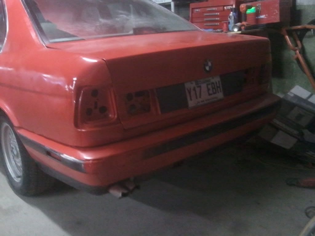

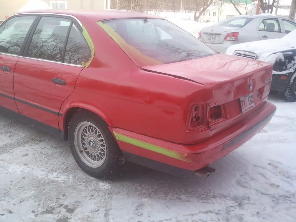

For such a nice car, it had been involved in an accident prior to my ownership, the rear of the trunk had been smashed in due to a rear end collision.
I don't have a picture of the original damage, those "Bullet holes" were there because we had used a pickup truck with a leaf spring ubolt going through the steel to pull it out to its relative shape, plus alot of rubber hammering and even bigger sledge hammers and a few car jacks. sprayed some cheap red spraypaint ( Its the exact same color) and then it ended up looking like a fat girls bottom. Psshhh
IT felt so WRONG taking a hammer to a BMW.
So after all that, winter came and I brought it into the garage to work on it.

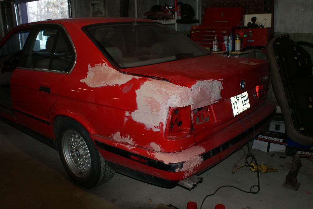

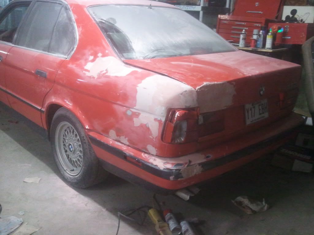

Im not new to the car repair scene and have done a bit of wrenching. I have done some body work before, but nothing this serious. Oh well i'm gonna go all in on this one. So after a trip to the store for some bondo and sand paper. ( And dust masks!, safety first. )
YIKES. "You like this" That's how I rolled for the few months before winter
So down to the nitty gritty, apply bondo, sand, apply, sand, sand, sand. ~6 hours later...
Still looks like ****e.
After ~9 hours, its starting to form together quite nicely
Thats where its at for now, I have new lights on order, should get here in ~two weeks. And im going to be looking into getting a new trunk, this one is warped beyond repair, but it will have to do for now.
Whats your guys opinions on my work so far?

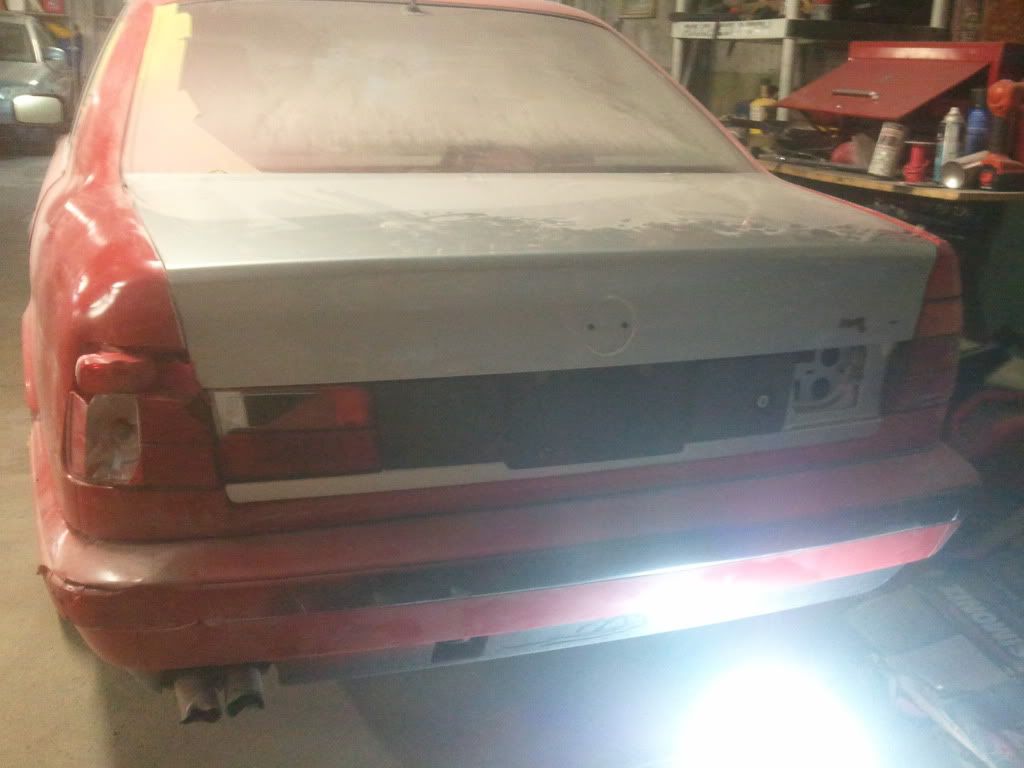

Allright, so bit of progress.

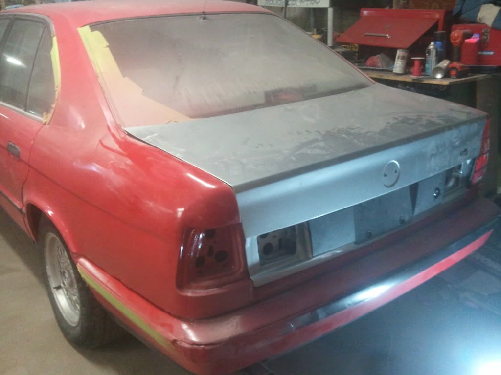

Started by priming it and painting it with one layer of red paint.
Its looking good, but that trunk is still messed up.

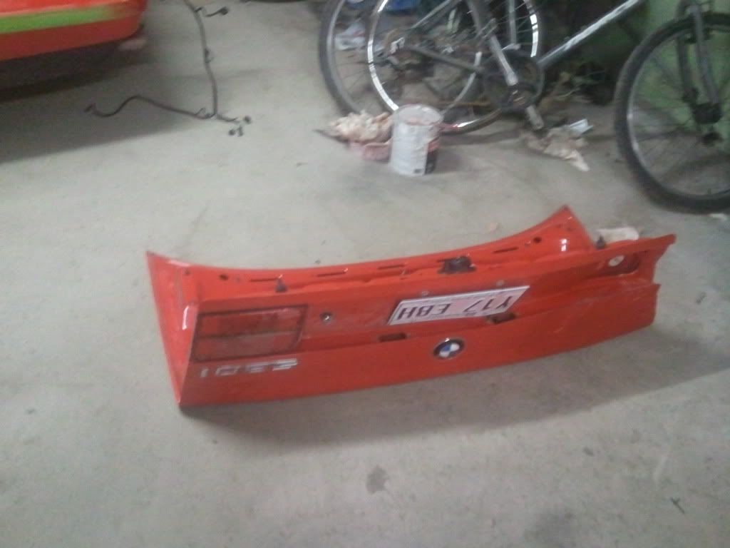

So off came the trunk, and after a trip to a scrap yard a new trunk lid was picked up
I pulled the wiring pigtail and lock mechanisms from the old trunk lid and got it all together, except the electronic lock. Mines a newer variant and i'll need to drill holes to mount it.

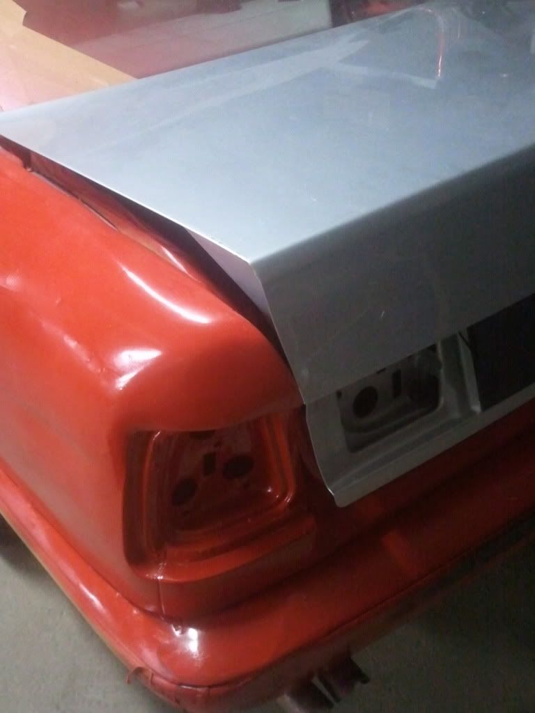

So the trunk went on... and... YIKES. Looks like my guesstimation was off a bit..
So tomorrow is fixing this issue, gona grind down the corner so it will fit. See how that goes. I dont thinks its coming along so bad, considering its the first time ive ever done major body work like this. Its only about 1/4" off, so a flappy wheel disc grinder will be used.

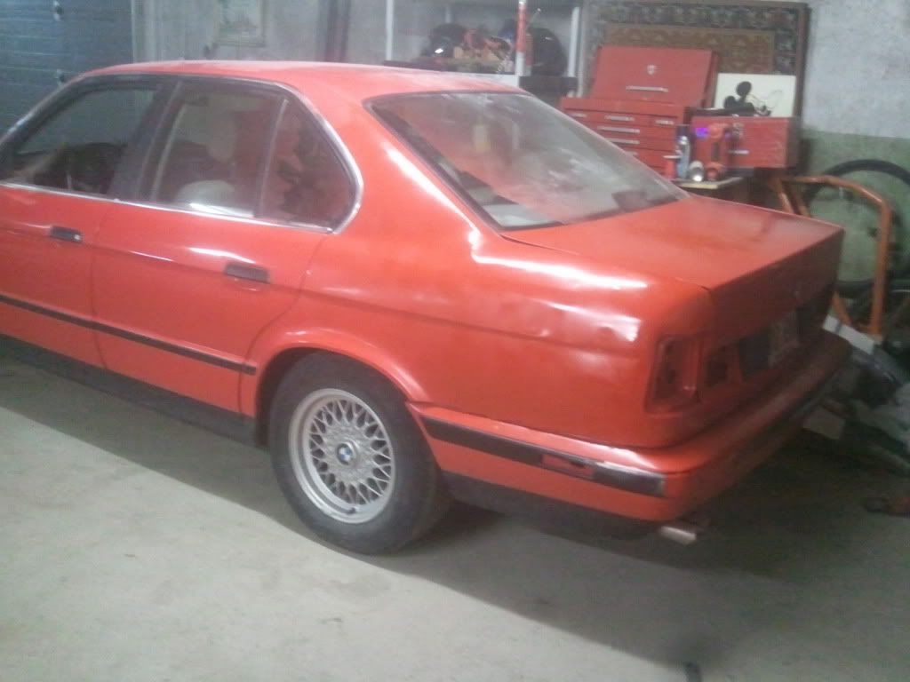

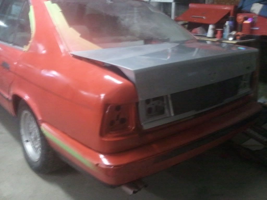

Went down today, and after a bit of grinding, the trunk is closing fine. even started to paint it. works coming along good. Got approximately a week to wait untill the new taillights arrive.
sitting kinda flush with the old busted lights in. that corner is bugging me a bit though, its too curved lol
rough sanding the silver trunk, primed and now a layer of paint

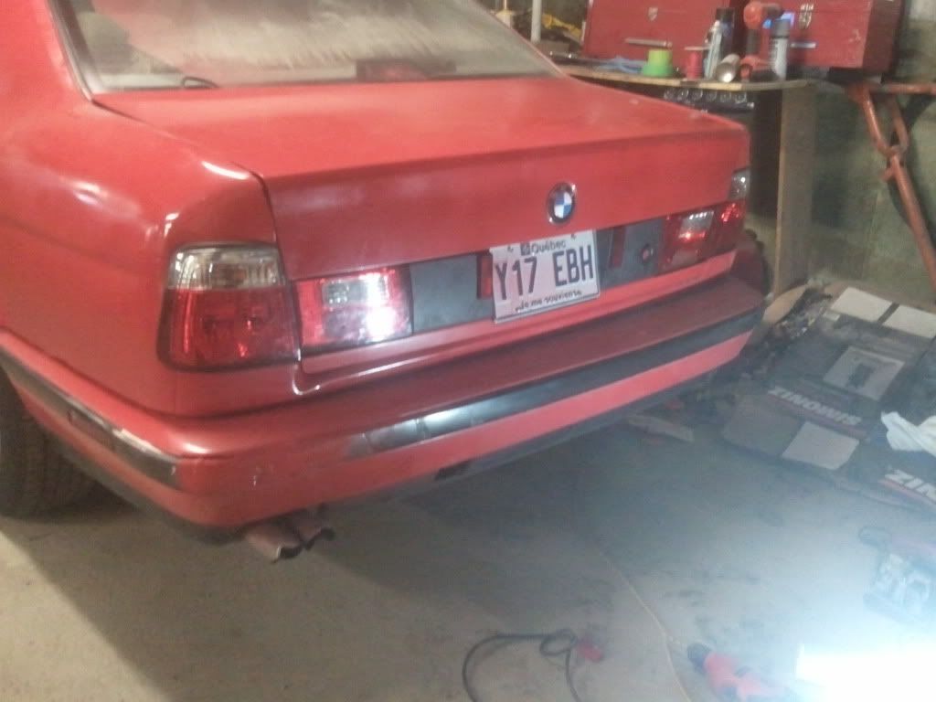

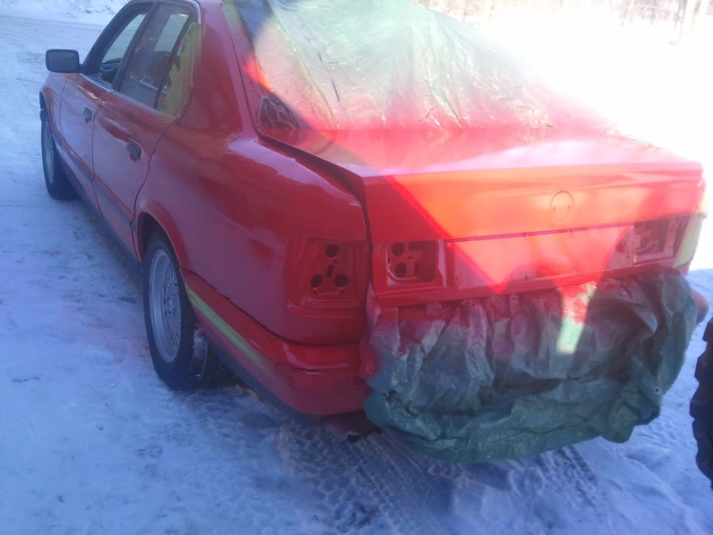

Well im pretty happy with the way its turning out, got a bit of over spray on the windows (More wind outside then i had anticipated lol) , so i'll need to clean that

Not Bad.Im assuming you are dong all this in your heated garage?I just saw snow on the ground in one of those pics.Reason i am asking is because it is not good for the fillers or paint to do that in the cold weather..And as you found out already make sure you fit all your parts before you start to do your mud work...It helps tremendously.I don't know how much pulling you did on that corner before filling it but it looks like that mud is pretty thick..Shouldn't be over a 1/4" really..And it looks like yo are missing your body line that meets the trunk..Ok now that im done being a Negative Nancy..lol It looks pretty good over all..Cant complain..Good for a trade and quick fixer..

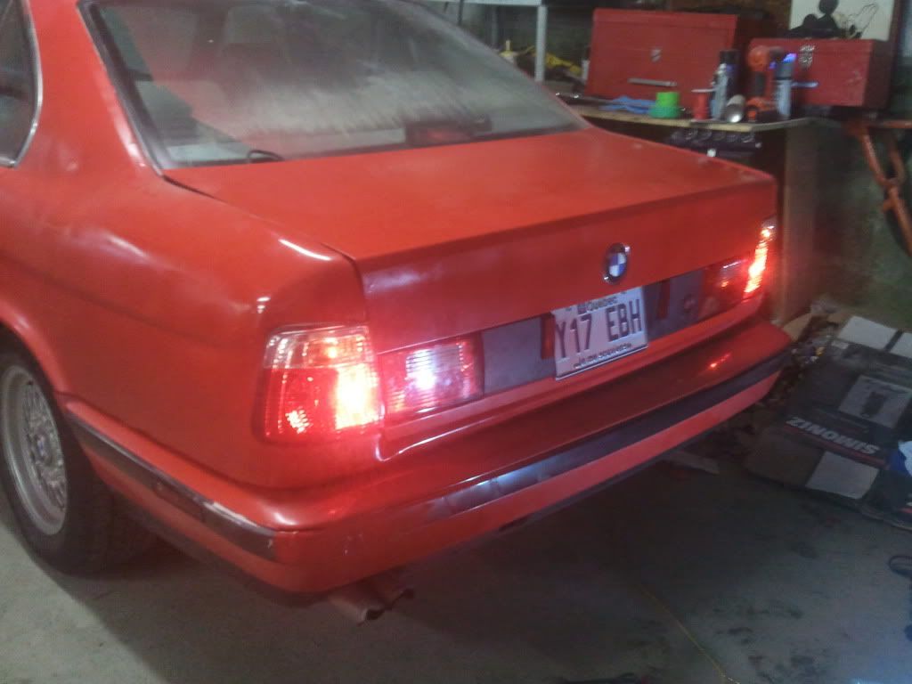

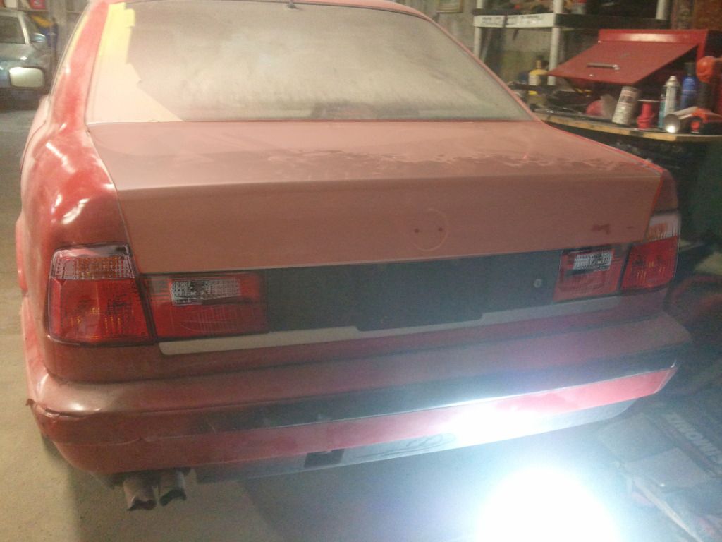

Thanks for the reply, yeah definitely getting replacement parts first would have been a good idea, i was limited to the ammoutn of pulling and hammering as im doing the work in my apartment buildings garage, and i did not want to disturb the neirgbours. the paint was done outside, due to the poor ventilation in the garage.
Heres how it is now with the new lights, i just put in today.
