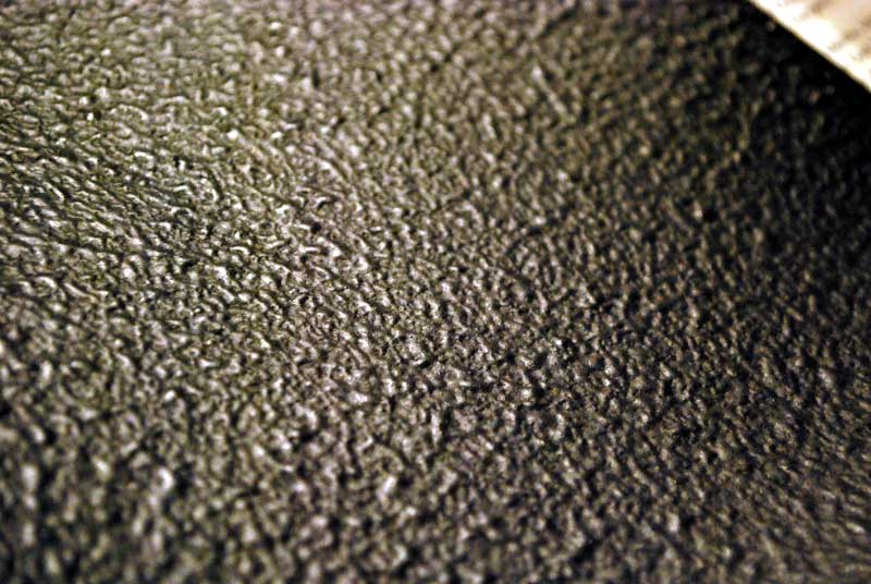

This is a small S-10 pickup I did personally last Friday. If you take your time with a roller just look how impressive this can be.
Monstaliner will give greater film thickness than Raptor which will work to deaden sound better.
Both are UV stable. Monstaliner will give better traction because you can't get this depth of texture from Raptor.
Spraying also requires that you do extensive masking to protect the rest of the vehicle.

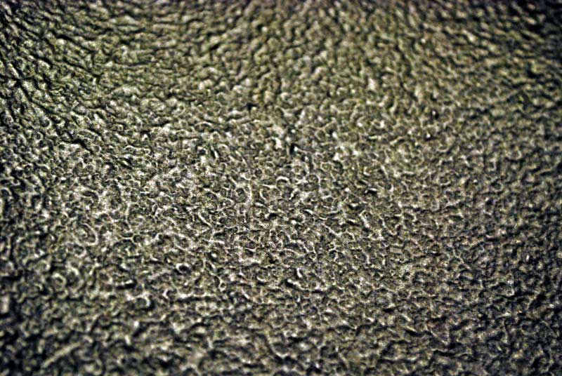

This is Monstaliner sprayed. Photos are way too close to see what it really looks like.
Don't have others right now. In the next few weeks we plan to spray a pickup bed and take more shots during install and after.
