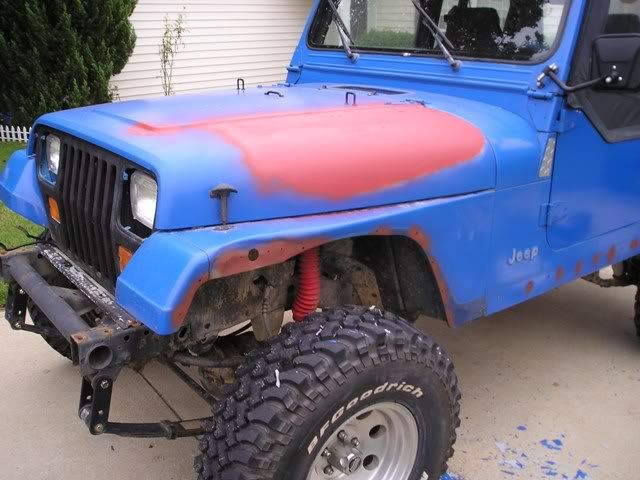

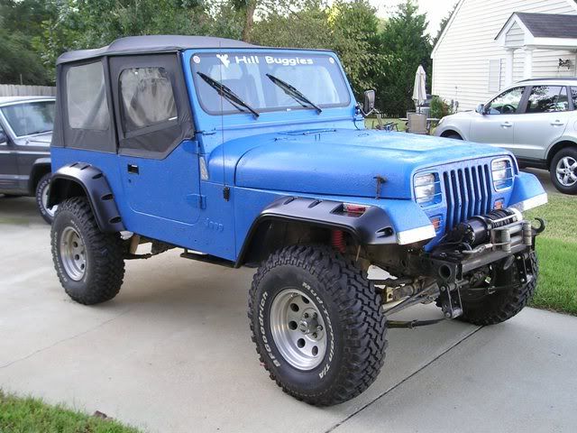

post #28 of 77 Old 12-05-2009, 06:55 PM
mrmud4x4
Location: Rocky Mount, NC
Posts: 394
1 Gallon Dark Blue Durabak 18uv rough exterior, two coats brushed/rolled.
Prep work is key - follow all instructions
