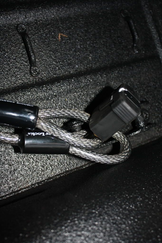

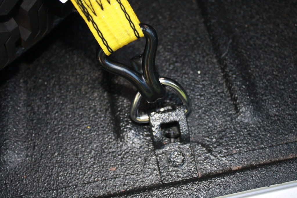

Another vote for Raptor liner. I can't stand the look of herculiner...looks cheap and ugly and very hard to get clean, also it fades fast because of no UV protectant. Raptor looks professional and is rough...but not too rough and easy to clean and has a UV protectant in it so no fading.. To be honest, i think roll on liners (monstaliner and herc.) while they may be a good product, are a waste of time, you can't control the thickness and quantity that goes on. With a spray on liner such as Raptor, you control the flow of the spray and how much comes out of the gun.
Here is mine.
the texture

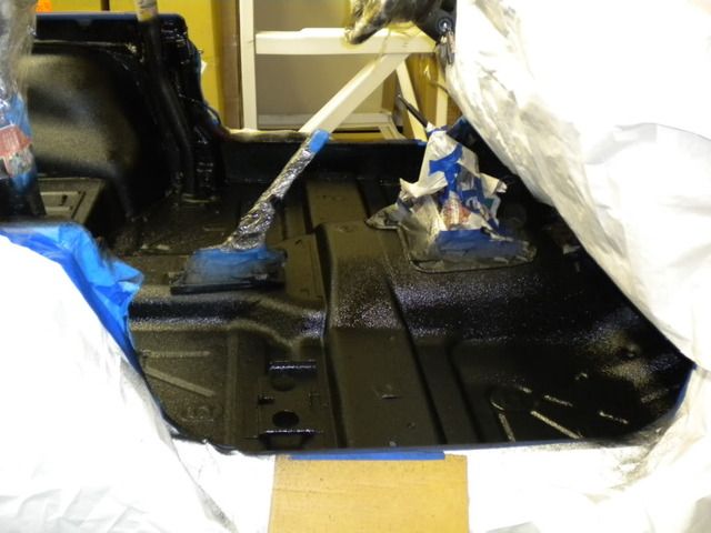

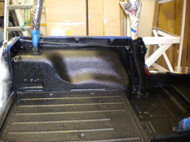

UltimateCC
Location: College Station, TX/Peekskill, NY
Posts: 1,029
Here is mine:
Well I was looking for a liner to put down in our project K5 blazer at the shop and was debating between herculiner, U-POL and rhinoliner or lineX. There is no budget with this build but I have used the roll on herculiner in the past and was really impressed with it for the money. Then came along Monstaliner and after some discussion/research I was sold and figured we would give it a try. Check out monstaliner.com for more details about the product. The big selling point for me was the finish. I really hated how hard it was to clean the herculiner being how gritty it is. The monstaliner had a much smoother finish more like some of the spray on liners. The kit comes with everything you need and has some very detailed instructions that I highly suggest you reading if its your first time using the product. It will save you a lot of headaches and time while installing the Monstaliner. After having this stuff in our blazer for over a week now I have to say I am pretty impressed with not only the finish but the durability. I will update this thread in the future with how it last long term but I have no doubts it will be holding up great.
All photos were taken by AMCPHOTOS: more pics can be found at Zenfolio | AMCPHOTOS
ONE OF THE FIRST SHOTS WE HAVE OF THE RIG
MONSTALINER AND ULTIMATE COLLISION CENTER
ADDING THE CATALYST
MIXING
THE MIXER SUPPLIED WITH THE KIT
SCUFF THE AREA TO CREATE A NICE SURFACE FOR THE MONSTALINER TO BIND TO BUT DO NOT GO ALL THE WAY DOWN TO BARE METAL
CLEAN THE AREA
PRIMER ANY RAW METAL
POUR SOME MONSTALINER INTO THE SUPPLIED TRAY
USE A BRUSH TO GET ANY AREAS THAT WOULD BE DIFFICULT WITH THE SUPPLIED ROLLERS
USING THE SUPPLIED ROLLERS TO LAY DOWN A NICE THICK FIRST LAYER
MAKE SURE YOU REMEMBER TO PUT GLOVES ON OTHERWISE YOU WILL BE WEARING MONSTALINER FOR A FEW DAYS
BEFORE
AFTER FIRST COAT BUT STILL WET
AFTER A FEW DAYS OF CURING
