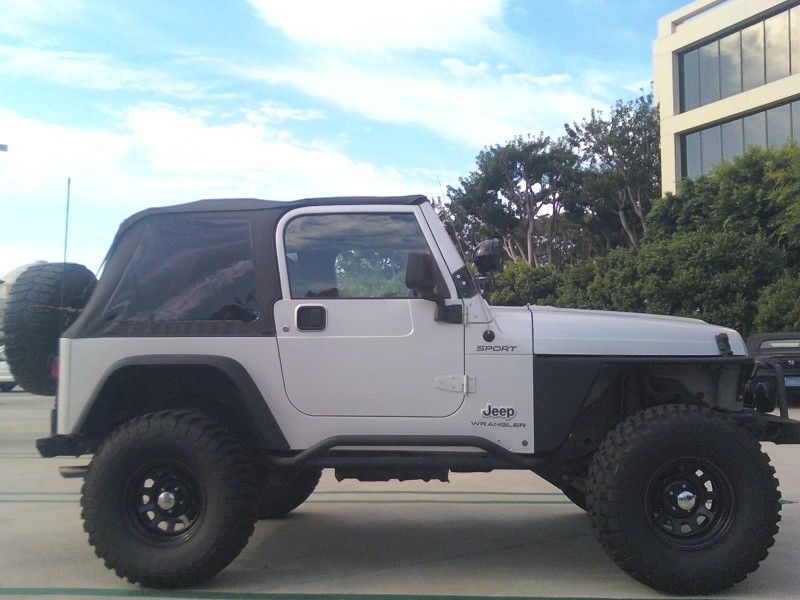

Thanks for the info, I worked on them today....taking them off proved to be a pain in the *** due to the little thread inserts spinning in place so I had to get my baby vicegrips out to fit up in the front fenders in order to hold them in place, after several hours of work removing the flares and wiping them down with DuPont prep wipes then spraying them with black bed liner spray the finished product turned out very well

Here's some better pics of the finished flares in the daylight
