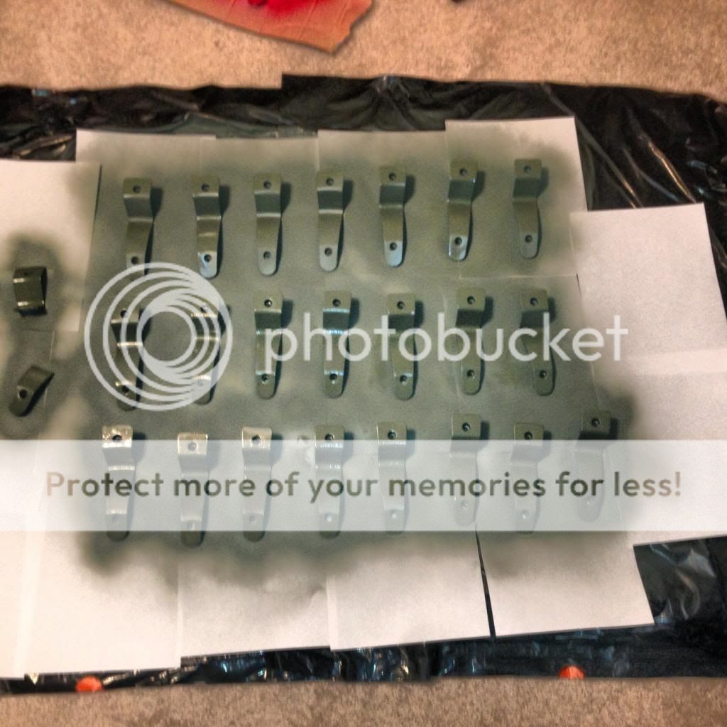

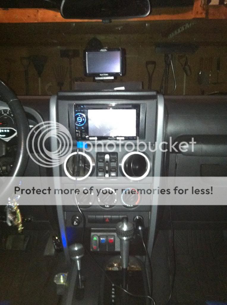

I have an 08 4-door JK. My theme for the jeep is black and red and I would like to paint the dark grey and silver accents black and red. Things like the interior dash by the gauge panel, the dark grey inlays along the center console, etc. Any suggestions on procedures to painting this. Should I sand it, if so what grade? What kind of primer should I use? Self-Etching maybe? Also specific paint?
I recently painted the inserts on my wheels and they turned out very well so I have some experience but I certainly would rather not do it if its going to turn out bad.
Here's some pics of what I've painted and what I'd like to paint. Thanks guys!

Good idea. I would suggest using a gray scotch-brite pad for sanding. Clean it with A LOT of wax and grease remover, and alcohol, then use adhesion promotor and spray paint for plastics.

After that, hit it with about three coats of clear coat, lightly wet sand, and add a few more coats of clear. Repeat until you're happy. Then wax it with whatever wax you've got laying around the garage. It'll look much more like a real automotive finish, as opposed to spray paint.
The end result completely justifies the little bit of extra effort.
