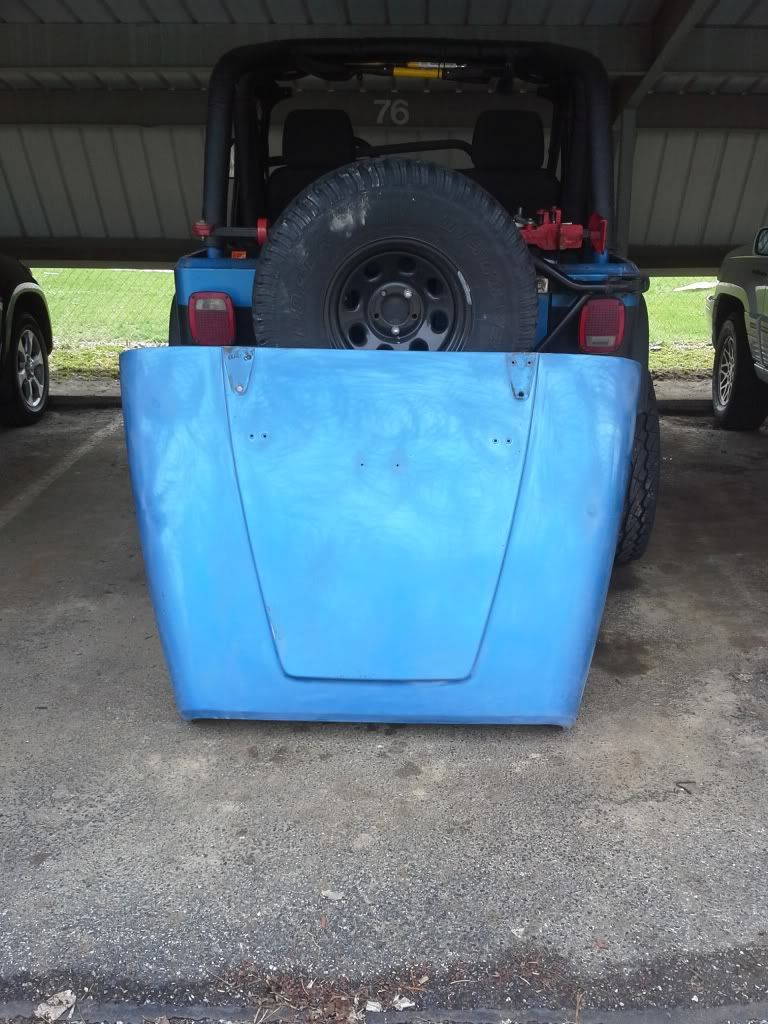

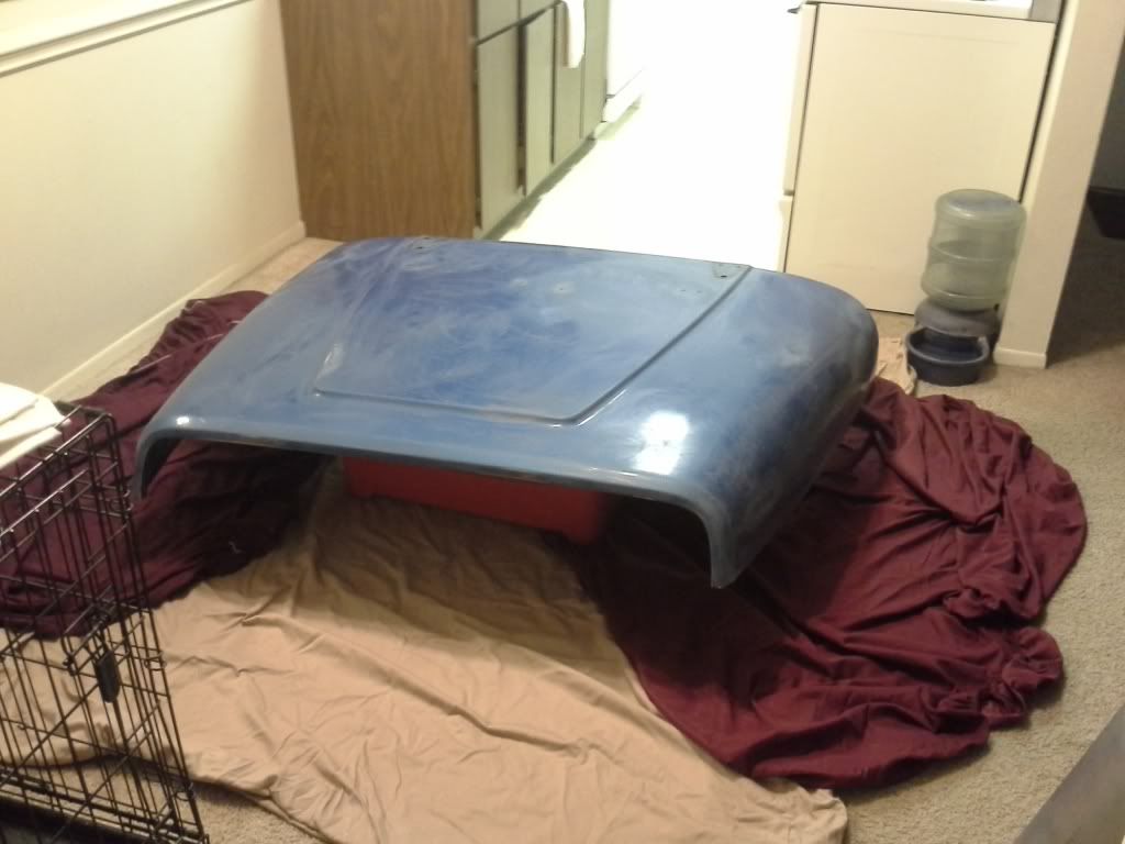

Well, I've started tearing everything down in preparation of paint. I was only able to work on it for about an hour today but I'm still happy with the progress. I should be painting tomorrow :-)

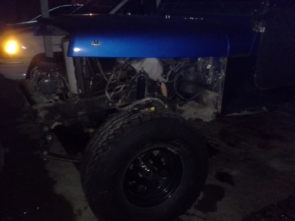

This look may not be for everyone but I rolled on Rustoleum High Heat Satin Black without sanding afterwards. Very happy with the results and a lot of people stop to compliment. It was so easy and cheap, I wouldn't mind if I had to redo it every 1-2 years. Hell, might even change the color that often for something different. Sorry, it's a little dusty in these photos. Any line marks or swirls aren't from the paint, it's from rain & pollen.
Super sharp man! Hope mine comes out nice!

A guy the other day complimented the looks and then asked if was some new type of bedliner or industrial coating. I just had to laugh. He had a perplexed look on his face when I told him it was rolled on Rustoleum BBQ paint.

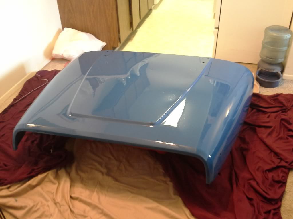

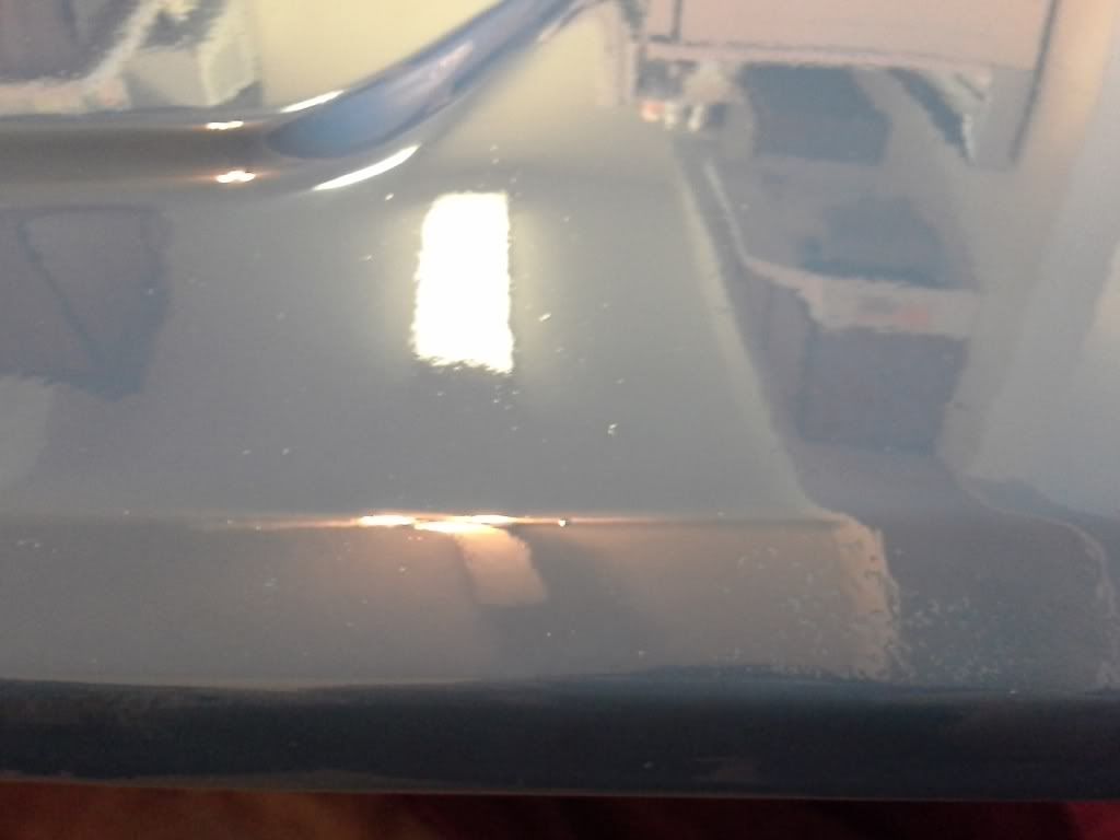

Well here's the first coat. Already looks really good although there a bunch of tiny bubbles in it. they should come right out when i wet sand it though.
Sanded with 220
Wiped down with paint thinner
In to the paint booth :-)
First coat, no wet sand
ashland82391 is offline

Did you get the bubbles out? Where they there immediately or did they just appear?
Haha wish i was that fast! I have to let it totally dry before i can hit it with sand paper. But about 5 hours of drying I've noticed the majority of the bubbles have gone away.
