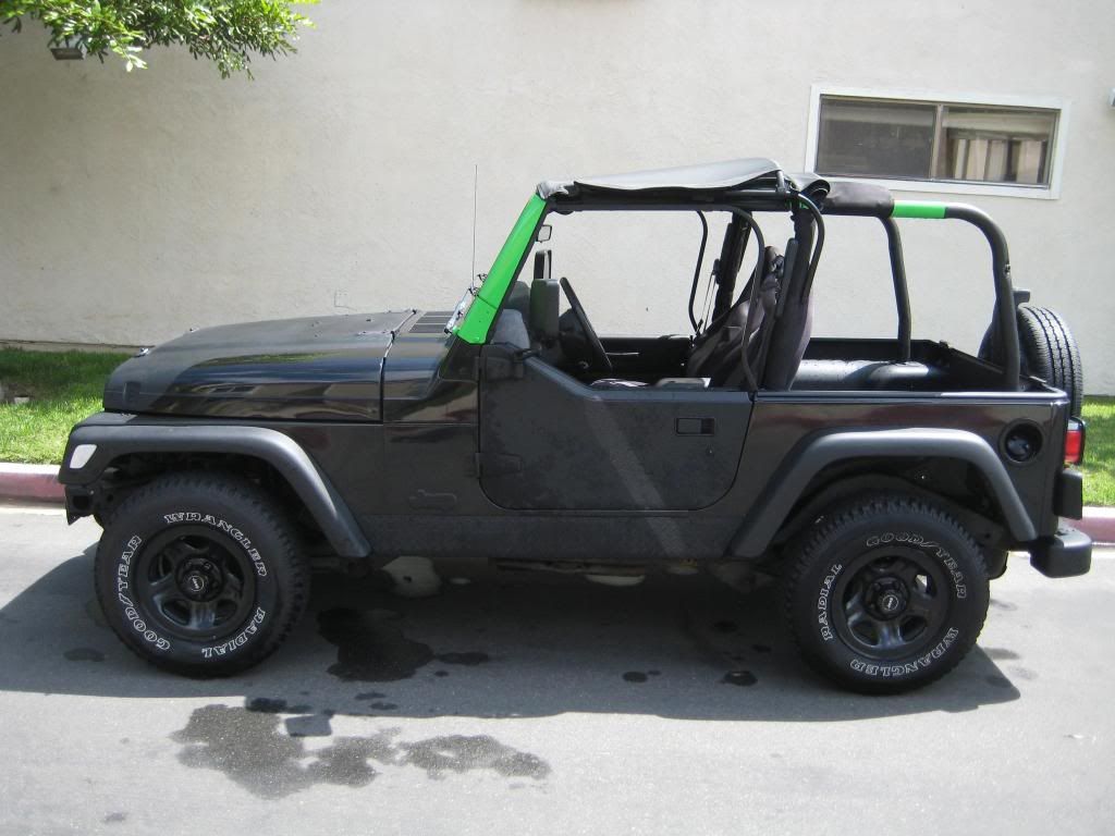

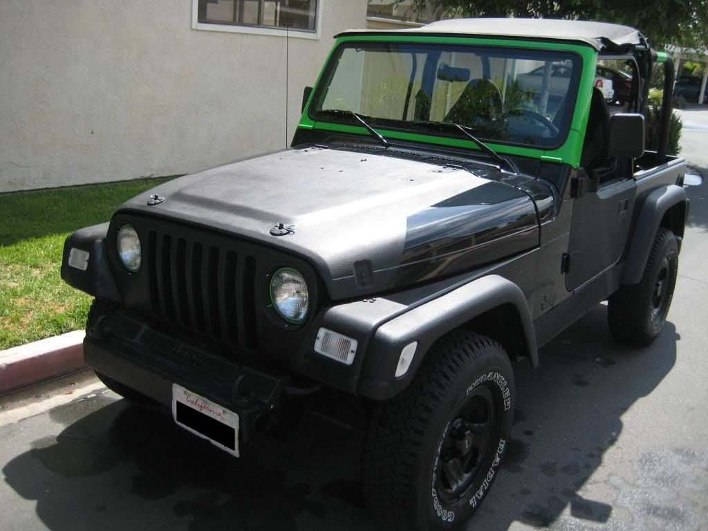

That looks great... I bet nobody even knows it's rolled!
I did mine with rusto, engine enamel, and rusto bedliner spray...
Before:
After:
Before:
After:
Looks good!
