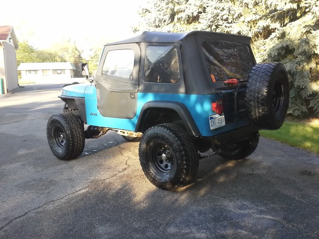

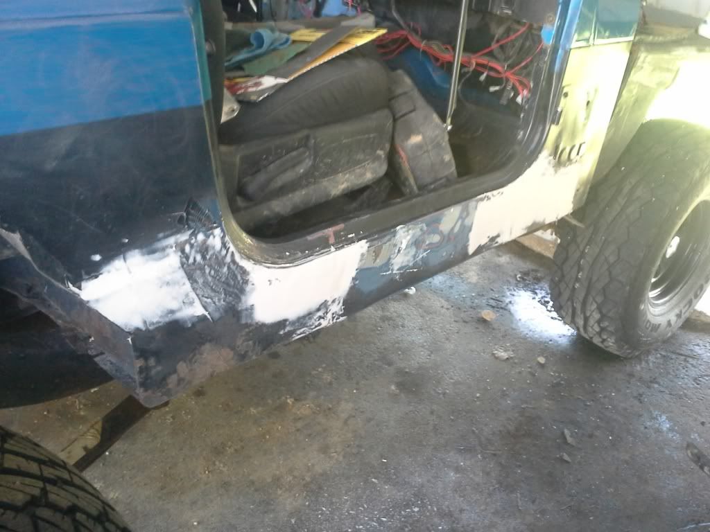

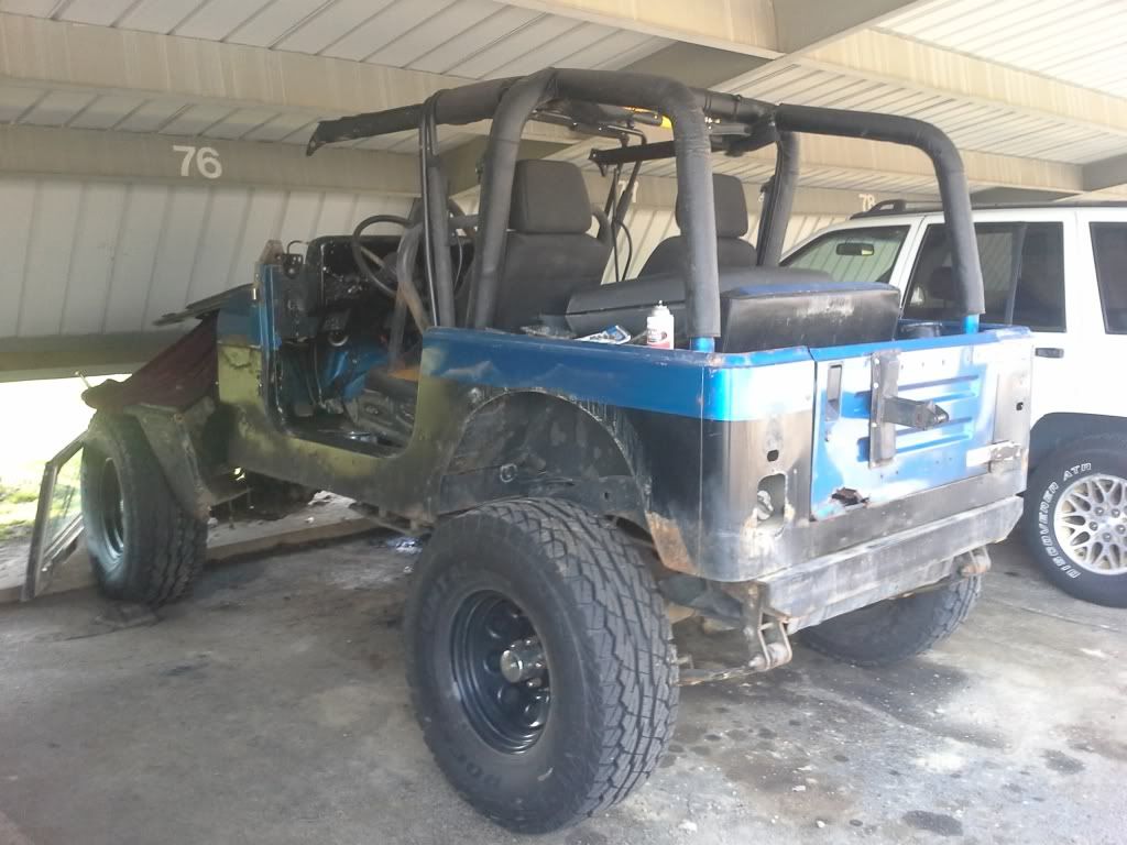

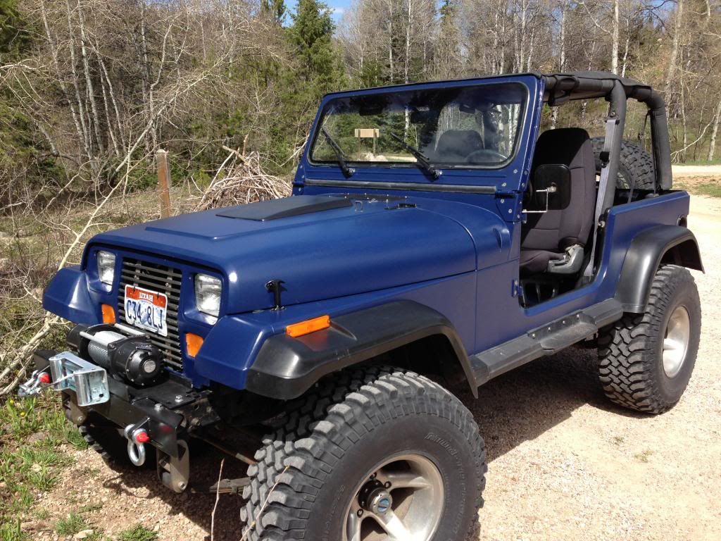

Just wanted to also share my experience with this roll on method. I was looking for something, easy, cheap, fun to do by myself, and not worried about the paint. I can scratch it, dent it, slide into a tree, and not be all uptight about it. I can re roll it if I want to in a few years should I need to. I used a Sherwin William acrylic enamel paint. I did about 10 coats. About 6 coats in I found it was coming out way to purple so I changed the color and added more green to the formula. I probably could have done about 6-7 coats total but I didn't want to cut it short. I did not end up wet sanding between coats as I thought I was going to. It came out with a textured look that I really liked so that is why I did not wet sand. I protected it with a cheap turtle carnuba wax and it looks great...seems to hold up well too.
Below are a few pictures. Here is a link to all the pictures I took of the project from purchase to roll on paint job, bed liner and winch install.
http://s1160.photobucket.com/user/jp...35674599954197
When I purchased:
Tested the color on the door and started prepping:
Got it out into natural light and it is confirmed, I don't like how much purple:
Did a few more coats and here is a close up:
Monst-lined the bed, mounted winch and some d-ring on front/rear bumper:
93 YJ I6, 5spd, Dana300, twin stick, 35's, D44 front and rear, 4:88 gear

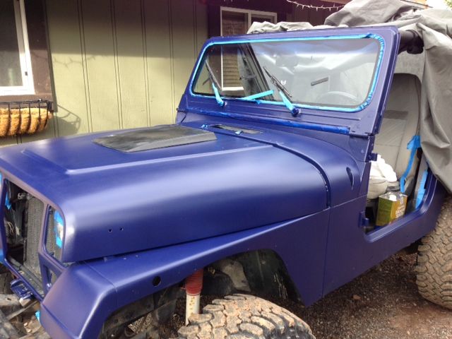

I am also planning to do this on my 91 YJ; however progress is very slow because I have two little girls at home, but if I ever get moving I will post up some pictures. I am using Interlux Brightside which is a top side marine paint. The reason I am using this instead of rustoleum is that it is UV stable. Many of the Rusto jobs I have found fade somewhat after a few years. The Brightside does not. The paint is a little bit more expensive, but I think it's probably worth it. I plan to do 8-10 thin coats, sanding down the orange peel every other coat. Although, I have to say ZJ1998's Jeep turned out really nice with the textured look. I want to challenge myself to get the most "normal" looking paint job that I can.
