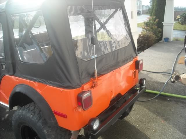

Here are some pics of my $30 paint job. More like $200 after paint, sand paper, respirators, DA sander, tape, plastic, etc....
I think I ended up using 10 cans of Rustoleum Orange, 4 cans of gloss black and about 4 cans of primer. I put on 2 coats of primer sanded in between with 400 grit. Than I layed down two coats of color and wet sanded. Then 3rd coat/wetsand, than a 4th coat/wet sand. Than a 5th top coat. I think it looks great!
