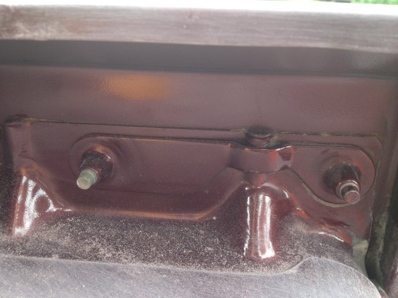

Posts: 56
Do I leave this in place and tape off the ends of the screws? It's like a nut plate for my upper tailgate hinge. I don't want any issues getting the hinges off down the road.

Just coat over it the bolts will strip off the Monstaliner if you ever need to remove them
