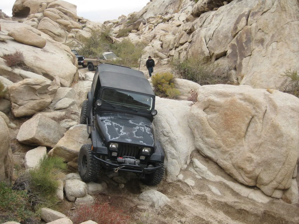

Well, I have a small air compressor and a harbor freight spray gun. How exactly would i go about prepping and painting my hood. What type of paint, etc. Never painted anything other than with a rattle can.
