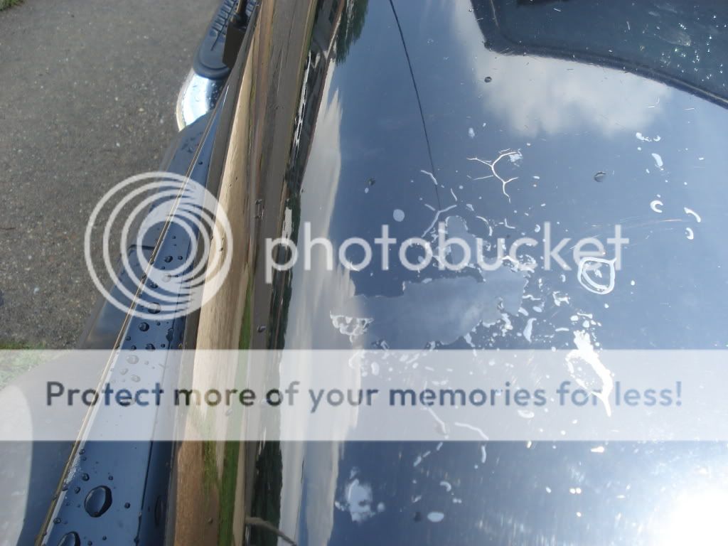

Well, Good to see this paint and body section.
My black hood has the clear coat bubbling up. Everytime I wash it, it appears to get worse. So what is the best way to re-clear coat it? Do I use a fine sand paper to buff out the edges where the edge of the clear coat meets the underlying black paint and then spray a can of clear coat on? Thanks.

you can try that with wet sand paper.. if it isnt to big i would chip off what you can with your finger nail and maybe use some clear nail polish to cover where clear coat is missing and go over edge of chipped clear coat to prevent from happening again..

It would take a lot of nail polish. Here is a little bit of it on one side but the other is almost half the hood. I know I could just take it to the shop. But I would rather do it myself.

It needs to be repainted. Once clear coat starts letting go, there is no saving it. Just having the hood stripped and repainted should not be terribly expensive.

You are looking at about 2-4 hours of labor for stripping the hood, where they will sand the clear until it feathers into itself, and probably go ahead and sand a bit off the rest. Then you are looking at about $400 or so for paint labor and materials.

Honestly looking at it, it definitely needs a repaint. Like what was said earlier once basecoat (colored paint) is exposed to the elements it fades and can't simply be recleared. Now there are two avenues for you.
The first is the obvious, take it to a body shop and have the hood redone. Depending on what the rest of the hood looks like they can either scuff up a repaint/blend into the surrounding areas or may just repaint the whole thing.
Option 2 is and I only recommend this if you already have an air compressor is (even if you don't have an hvlp gun) pick one up, head down to your nearest jobber (auto paint supplier) they will use a spectrograph and color match your paint. You will only need a quart of paint (smallest available size), once reduced it makes a half gallon of sprayable paint. I would also strongly recommend a good epoxy primer, and a quart of a medium clear. I use the deltron line (dbc 300) high quality durable finish. Sand down the whole hood using 400 or so grit paper. Wet sand it, prime it, prep, paint and clear. If your a beginner that's why I say whole hood and not affected area, blending for beginners is not easy. You will pay nowhere near 400 bucks and if a body shop has to respray the whole hood it will cost much more than 400.
If you need more advice on paint feel free to ask. But in any event the best way to avoid this in the future is to wash your truck often, if it's really dirty after washing, clay the car (mothers/meguires are 2 good systems) Good Luck.
