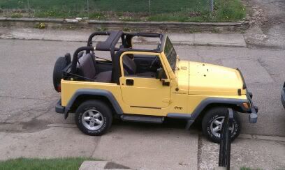

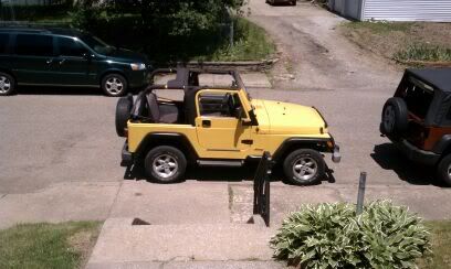

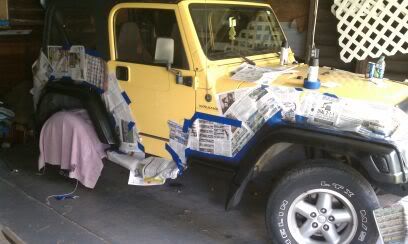

Location: Canton
Posts: 7
Buy Krylon Fusion for Plastics. I went to Summit Racing to buy it, but then realized they sell it at Walmart. It costs $3.54. I used a can and a half.
Wipe down with ammonia based windex to get rid of oils and dirt, then spray with krylon.
The color I used was Satin Black, gave it a good semi-black color.

process
I especially like this process because the paint bonds to the plastic. So even if the paint runs a bit, you can't tell with the final product.
I did it a year ago, and I am thinking about using another sprayover just to give it the brand new look again.
