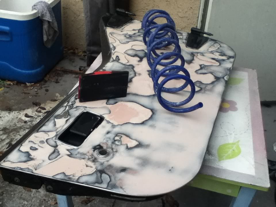

PASSENGER SIDE DOOR
Before:
After smashing it out as much as I could with a hammer and pipe wrench:
After a couple fill-in layers of bondo:
After shaping my fill-in layers with a metal file and sandpaper:
Primered and some more smoothing with 100 grit:

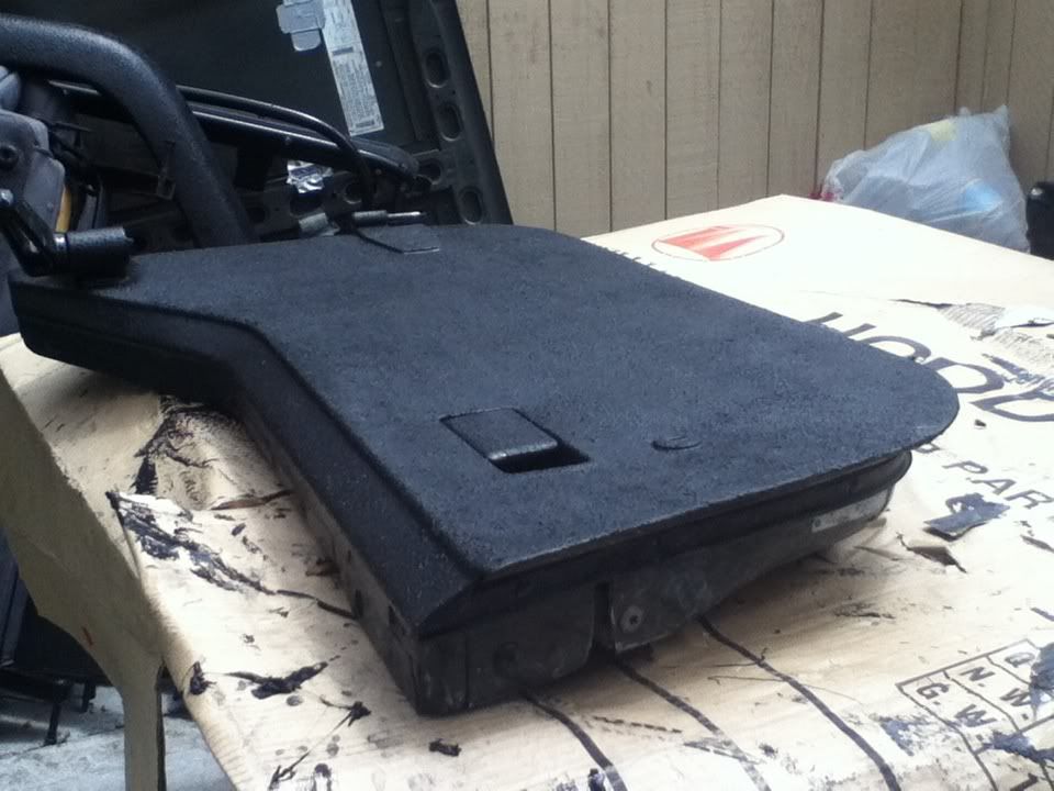

Finished the doors off with bedliner:

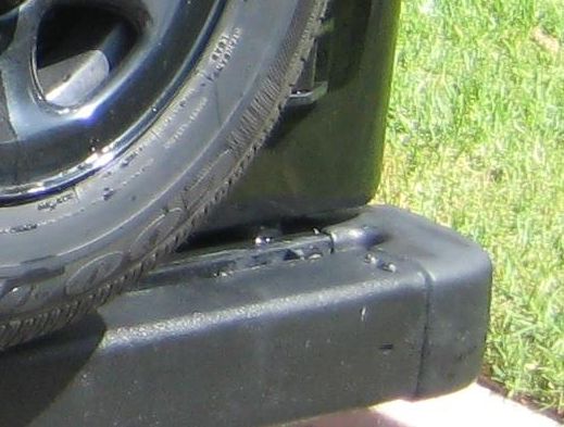

CORNER:
Before:
Bondo'd up:
After:
Finished with gloss paint:

Bedliner tips:
I'll just say it one more time, DONT use duplicolor bedliner this stuff SUCKS!
Rustoleum is the way to go!
For rustoleum at least, prep with 400 grit, no coarser! It is strong but it goes on thin. Use multiple coats to build the texture back up.
If you want to make the finish a little more sparkly matte, start with a medium distance (wrist to elbow) spray distance, then back off and mist it while the coat is still wet.
If you're going to do this, you will need to rub it with a kitchen scrubber and hose it off well before applying another coat, otherwise you're creating air bubbles from the loose particles you made by backing up and misting it.
Move your arm at a consistent distance, and your whole body if you can. Move first then push on the nozzle while you are already moving. Practice how you will move with the can in your hand before spraying.

If you don't like the gray look of the bedliner, you can clear it. I didn't originally want to do this because I thought you had to use matte clear which is hard to find. I just decided to use my leftover cheap rustoleum gloss clear on the bedliner. Here's how it looks (at night), sorry still need to post a daytime pic. (also added some outline scallops with my leftover green)
