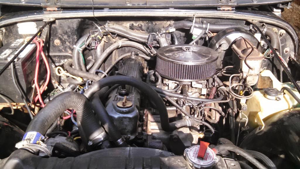

So a TBI is supposed to eliminate the majority of the vaccum in a jeep and its supposed to eliminate the pulse air system. This is TBI done incorrectly.
TBI Done correctly.

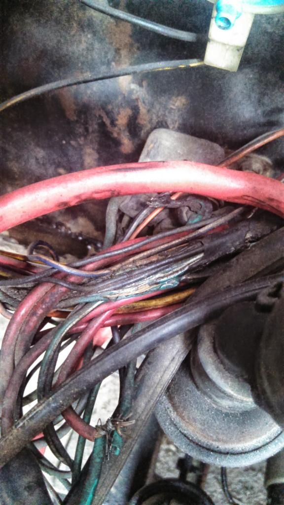

Doing a wiring Harness is a nightmare I went from a fried wiring harness to a used harness
Check out the Fried one:

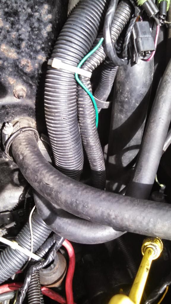

From there I decided it would be a good idea to install one that would actually work. The overall Project was fairly simple, but it was very time consuming. We went through the entire harness and soldered any bad connections and taped everything off so it would look professional. Here is the section that was burned out before. It is now contained in the tubing and far away from any heat source.

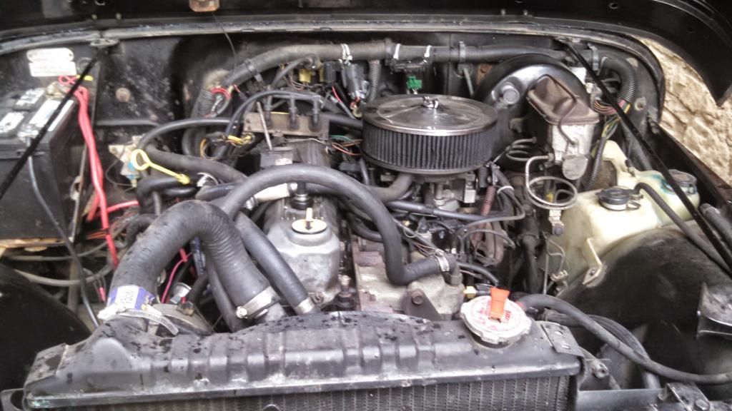

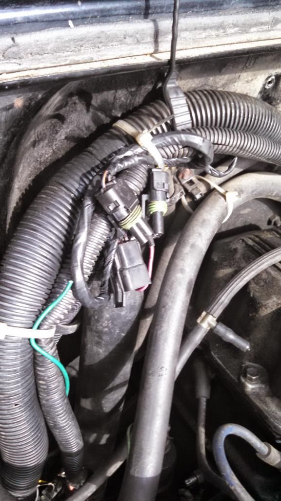

Here we had to get the old components for the Carb out of the way so we zipped them to the fire wall.
At the same time we removed the pulse air system and extra vacuum lines that were not necessary for what I have installed already. Keep in mind I bought the Jeep with a POSI-LOC manual actuator for my 4WD.

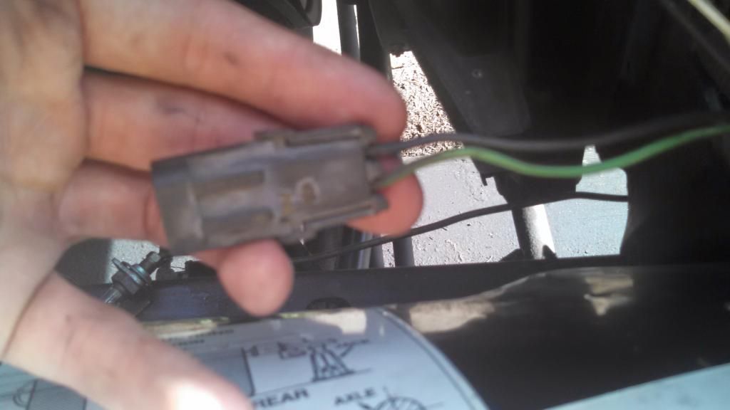

Does anyone Know what this plug is for it came from the light harness and is identical on both sides. If it helps I pulled this harness from a 91 YJ Sahara. It has a Green and a dark Brown wire.
