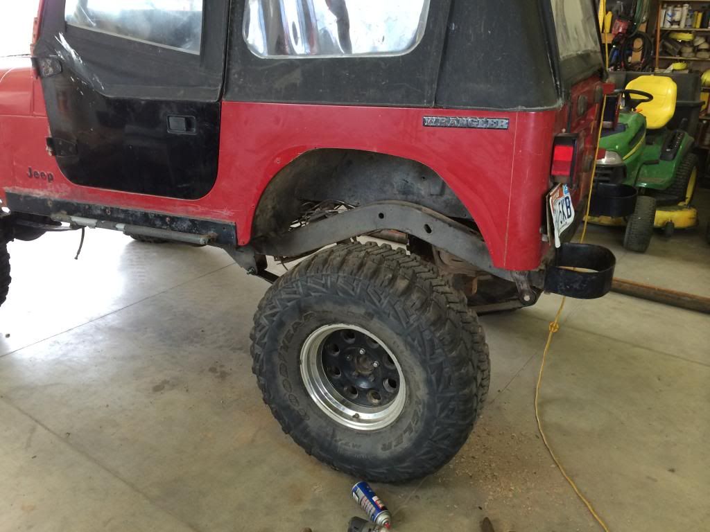

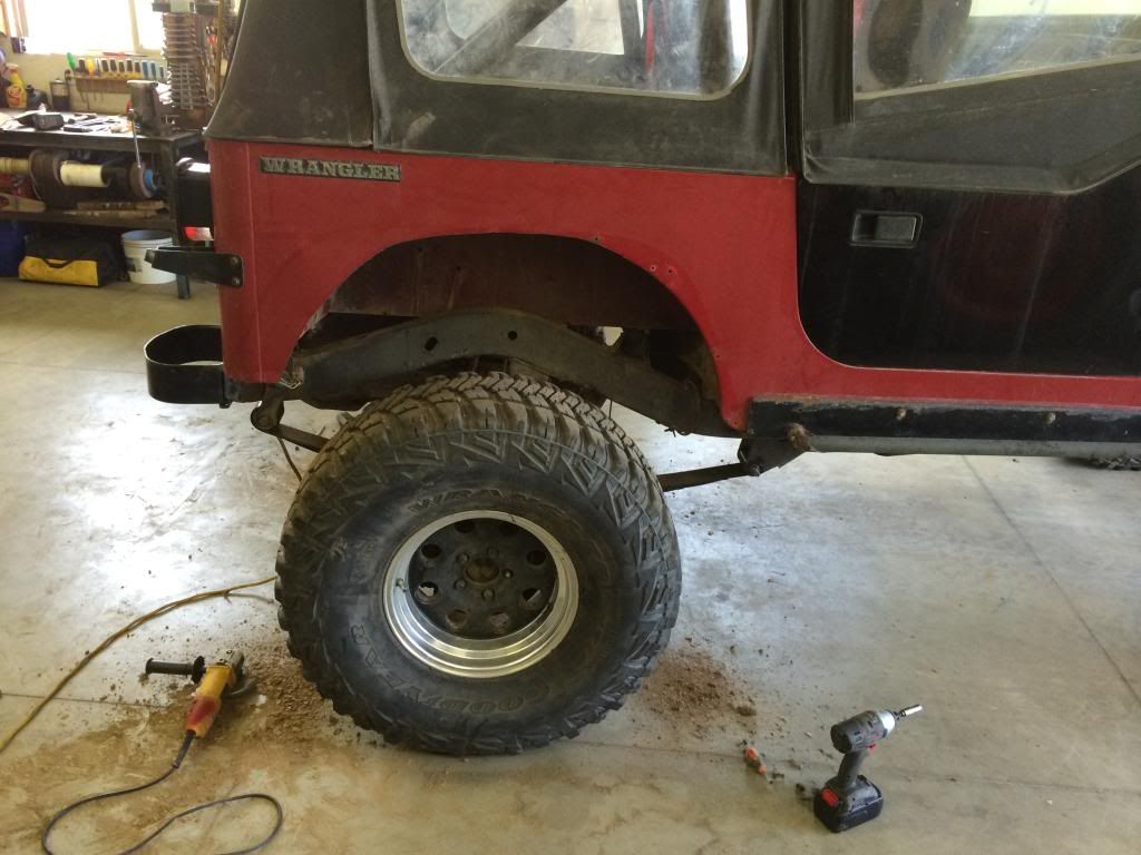

Today I got the tub cut. I need to lower the back end so I might French the hangers. I also need to get longer shackles... Right now my spring hits the frame during compression. Oh and bigger tires wouldn't hurt

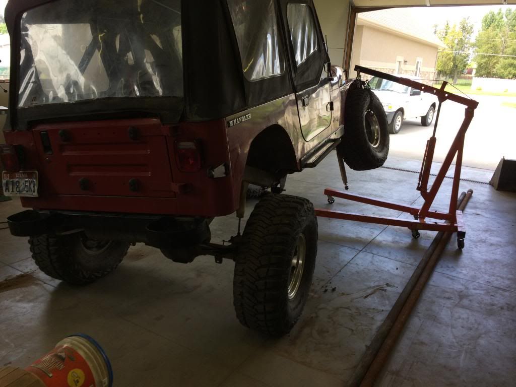

I also tried to flex it out again so i could measure for shocks but my hoist couldn't go high enough. I guess I'll just have to go use an RTI ramp.

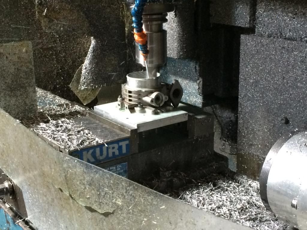

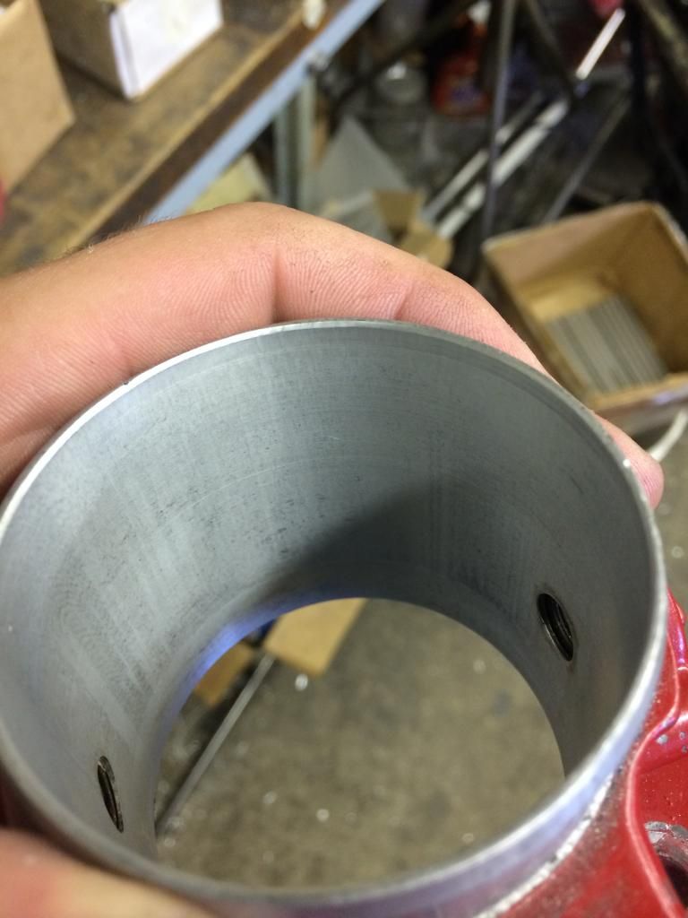

Well not much has happened to the jeep lately. I've been busy with life and vacations. I'll go get the valve springs installed sometime this week. I decided to bore my throttle body myself so when I have some down time at work I'll throw it on the mill and bore it out to 64mm then cut a new throttle plate.

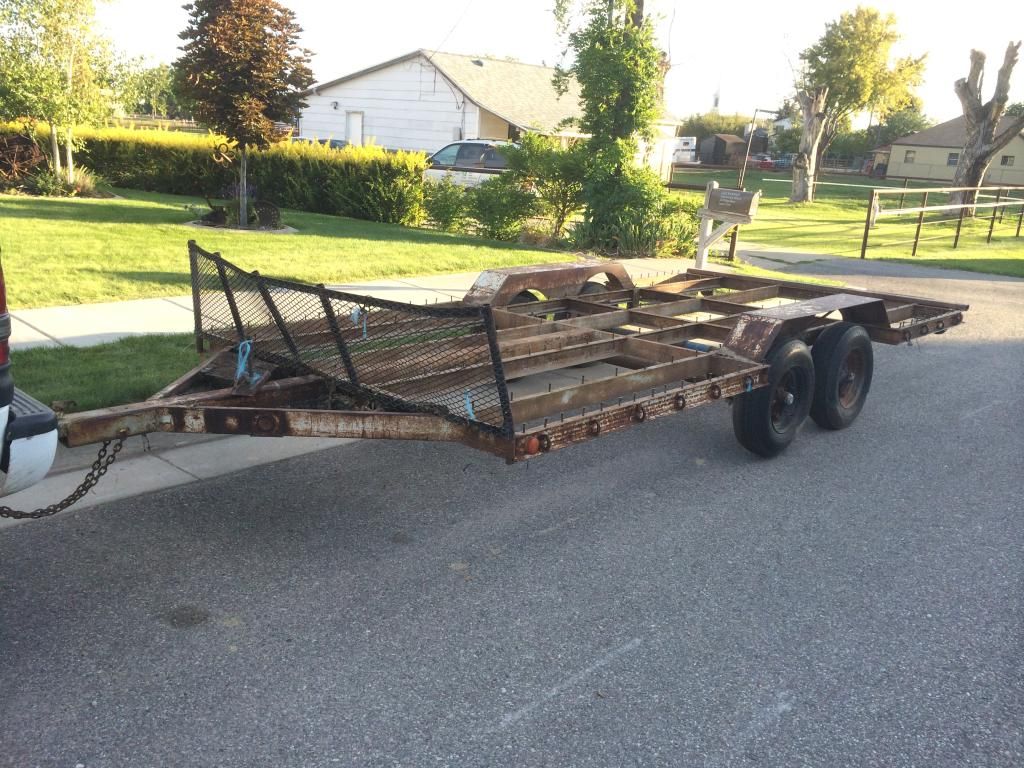

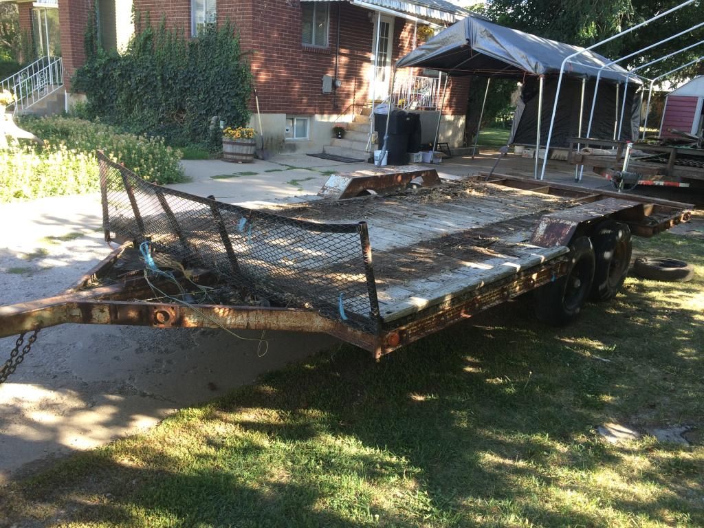

But yesterday I picked up a 16' flat bad for free. So I'll be building that in this thread as well.
The plan is to strip it down, sandblast the rust off, paint or powder coat the frame rewire it, fix or replace the brakes, repair the seized suspension, and re deck it.
Right now I'm thinking I will use 2x8s for the deck but I will also bedline them so they arnt slick when wet. I don't plan on using ramps so depending the ride height after I fix the suspension I may dovetail it for easier loading.
Yesterday I got the deck torn off. Now I just need to cut all the deck bolts flush with the frame then I will sandblast it.

Bored the throttle body today.. Now I just need to find some 1/16" aluminum to make a new throttle plate.

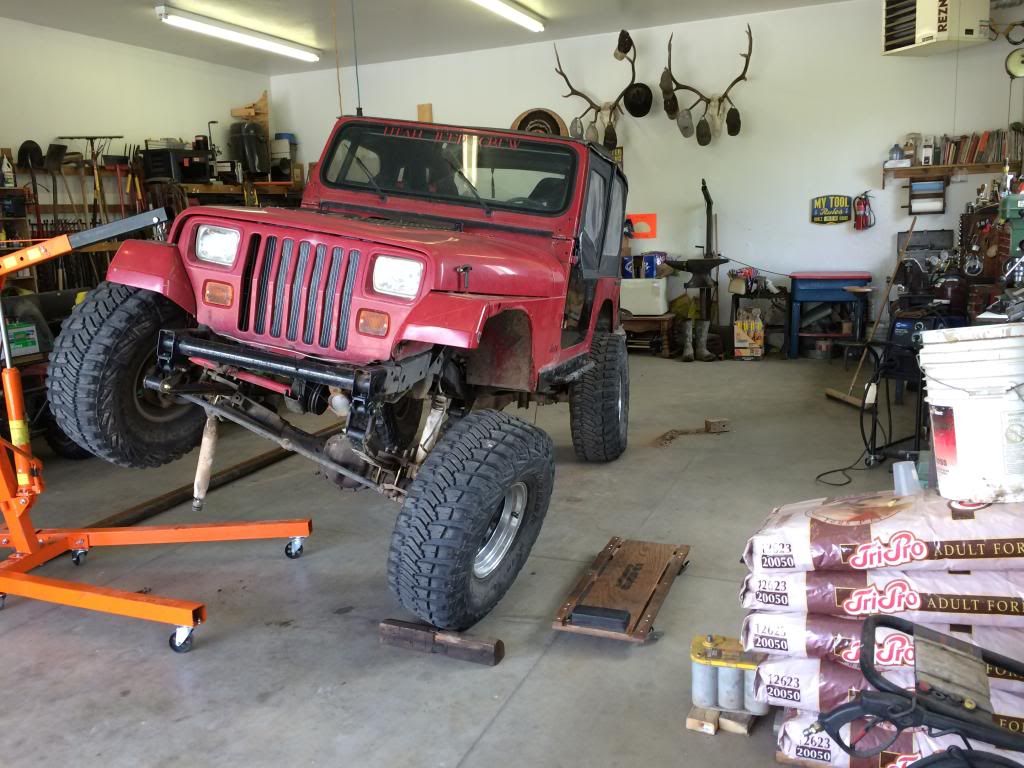

Nothing really worth mentioning haha I did cut my front fenders to match the angle of my bumper and I put the dash together and cleaned it up. I'll take a picture of the fender cut tomorrow when I go to the shop.
