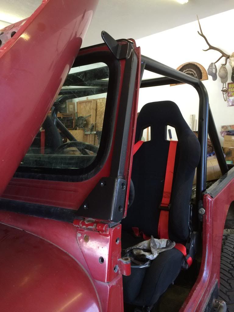

I'm on my phone so I don't feel like looking back, what seats are they? Mine were super tall too but I'm also 6'1". My head is still probably within 3" of the spreaders.
Randonexplosion is offline
post #47 of 228 Old 04-09-2014, 09:40 PM Thread Starter
youngjeepr
Location: layton UT
Posts: 2,545
They are just some cheap seats I got them from a local guy for $100 with the harnesses. I'm only 5'11" I'll have to snap some pictures of the clearances tomorrow.

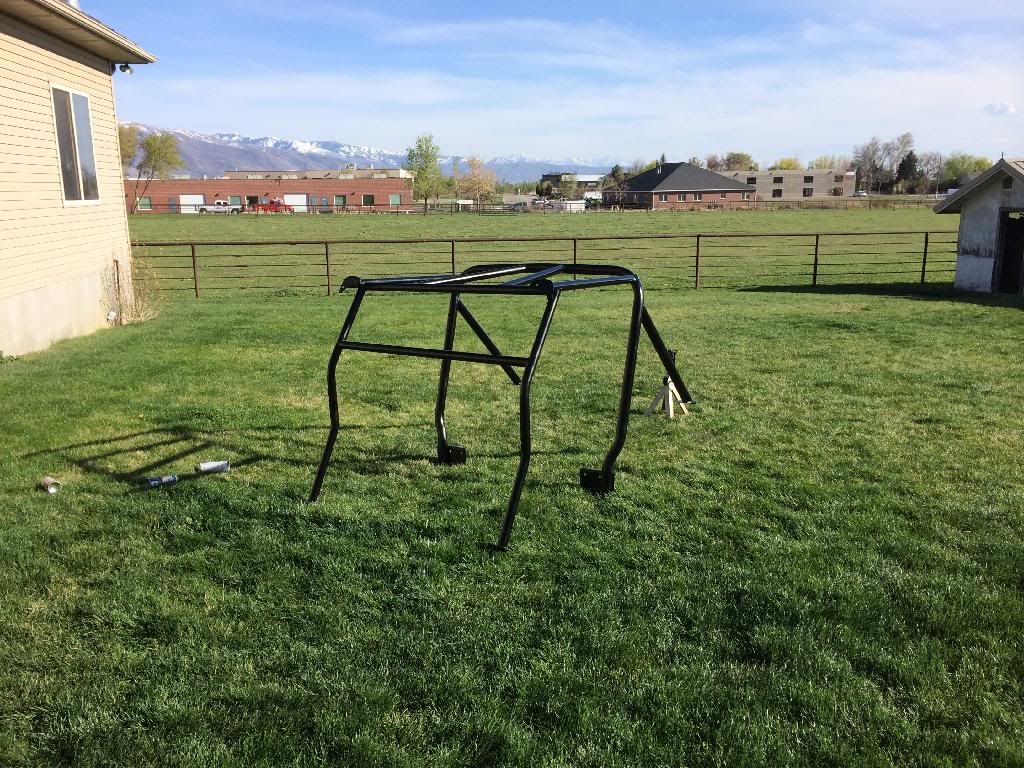

I picked up a freshly rebuilt AW4 yesterday and I also painted the cage, put the interior wiring harness in, and got the dash back in.

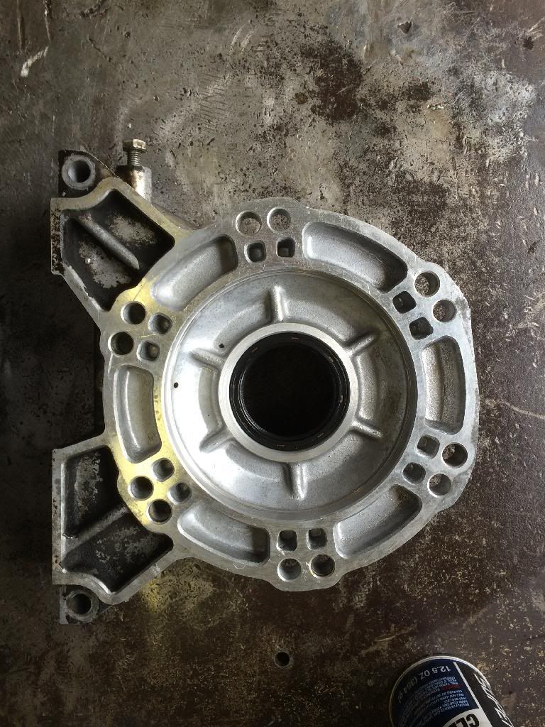

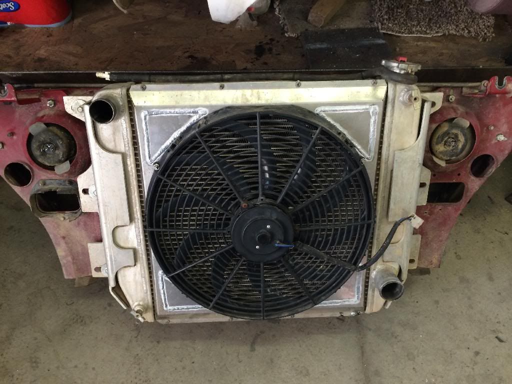

Today hopefully I'll get the tail housing of the AW4 drilled, get the flywheel re drilled for the torque converter (if needed), swap the input of my t case to a 21 spline, electric fan put back on the shroud (I had to weld up some holes I cut in it) then mount the fan/shroud to the radiator.

Got the shroud and fan mounted today.
got the transmission tail housing re drilled.

Once everything was put in and I put the front clip back on I realized my Novak radiator wasn't going to work. So I went and bought a new one. So if you or any one you know is looking for a double core aluminum radiator I'm selling mine for cheap.

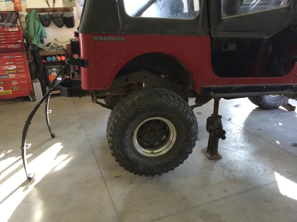

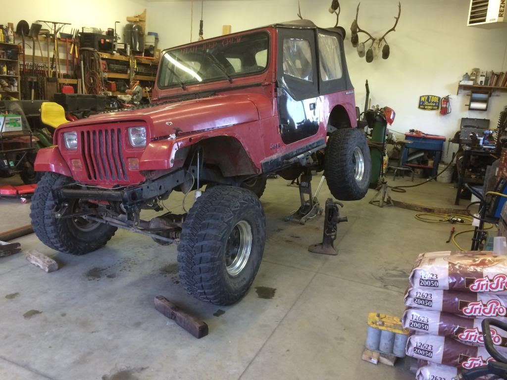

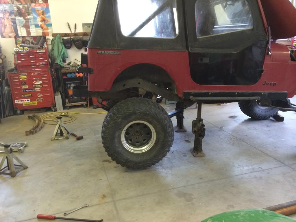

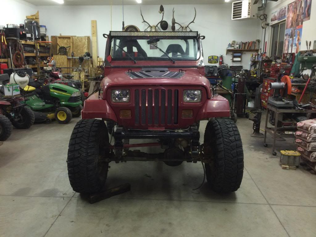

Today I got the rear stretch done and I made new spring clamps.
I flexed it outrage best I could but my jack wouldn't go high enough.
