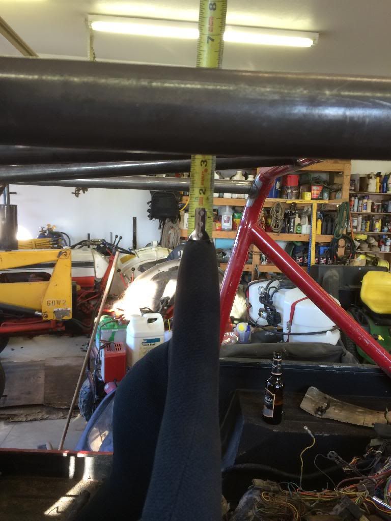

Oh and I lowered my seats.. It was such a pain in the ***. I couldn't keep the swivel style brackets so the seats are just mounted solid to the floor.. I don't like how the mounts look so I'll probably tie them into the cage once I get my new bender set up.
Ill post some pictures later tonight once I get off work.

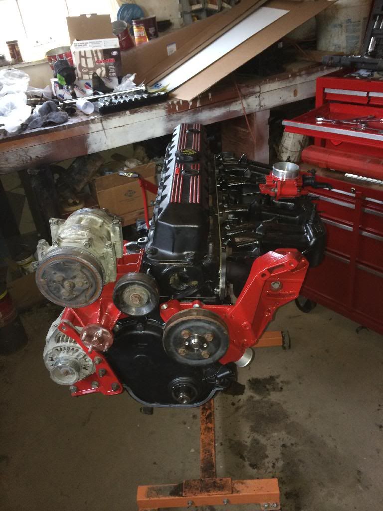

Here's a picture I took last week.. Sense this picture I painted the ac pumps Since I will be using it for OBA an dial sickened up the alternator and I put the water outlet on.

Engine looks good. Could you not modify the brackets like I did? 1" wasn't enough?
Randonexplosion is offline
post #45 of 228 Old 04-09-2014, 08:35 PM Thread Starter
youngjeepr
Location: layton UT
Posts: 2,533
No I couldn't... I took out a good 3" and the seats are still taller than id like them to be... When I'm sitting in the seat my head is only about 3-4" away from the cage.
