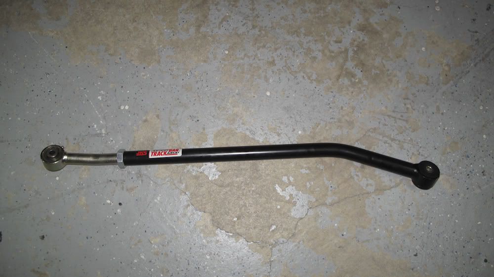

Little up date as I have been super busy over the last few days Put in another order for the Riddler rear diff cover for my 8.8 along with a new JKS track bar to finally correct this dam n offset issues

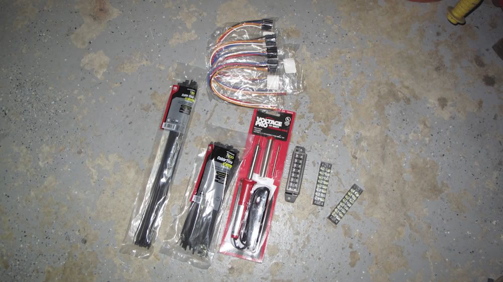

I also plan on rewiring all of my accessories correctly since I plan to Mosterliner the tub. I can finally put a stop to that rats nest that was looming around my battery. Just need to grab some relays and wire and go to town

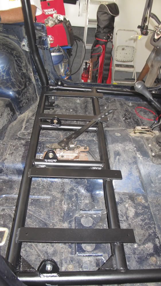

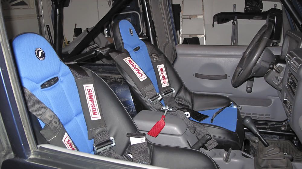

Long overdue update, kinda good and kinda bad. Good news, got my seats, track bar, and diff cover in Bad news, having to pull the cage again to weld he bottom of the seat mounts. I was rather foolish to think I was going to weld them with the cage in. Have some rather poor welds so I will need to grind them out, reweld and gusset the crap out of it
I am on a 2 week count down till my trip so I really need to buckle down.
Seats look pretty good at first, then I really started to look them over and I am rather disappointed. I believe that Corbeau really needs to look at the QC as these should have never left the factory. First off the undersides were rather loose and looks to be thrown to together. The welds on the mounts had traces of porosity in welds some of the webbing on the inside of the seat was poking at the vinyl which was just begging to tear a hole in them. Also my favorite was the patch being sown on upside down . Put a call in to Zach who then called Corbeau, it loooks like they will make it right which is all well and fine....but really If I was not on a time crunch and could do it over I would have went with Mastercraft
With all that said I started to make some progress with the seat mounts.
I did get seats mounted and in their position....just forgot to take some photos
The rest of the night was cussing as I would bend myself small enought to get the undersides of the seat mounts. About that time I figured I was going to have to tear down the dash and pull the cage . On the upside, I am getting pretty dang quick at removing the dash

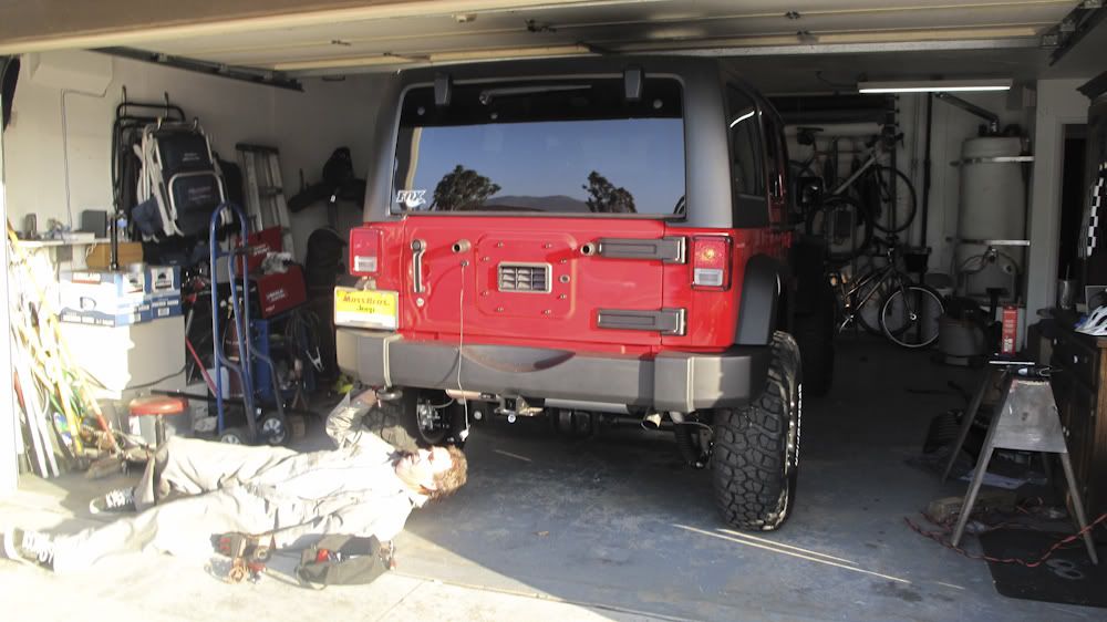

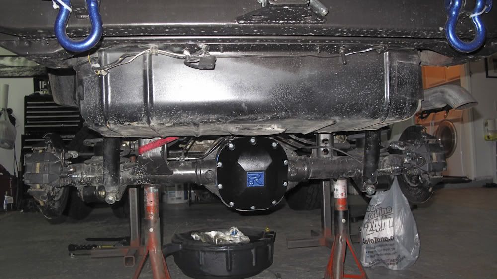

The brown santa dropped off some goodies which I hope to have installed this week
Finally have a 3 wheel drive jeep again since the axle swap! Also get to toss that think 8.8 diff cover that was just begging to get punched.
Also get to finally center my rear axle as well, looked pretty stupid running off seat

Thanks, I could have done the initial cage install without pulling the dash. Issue was welding and painting so I had to pull it. Now with the seats, I have to pull the cage to get access to the underside. I just do not feel safe with the welds I put down with limited access, so more work ahead!

Yup, I also think I need a small helmet as mine kept bumping into things . Did get the cage pulled, looks like the new floor additions made it impossible to pull without bending things. So after a little hammer action shes out and welded, just need to gussest a little bit more and shes ready.
Also need to fab up some harness tabs now. A vendor here dropped the ball and "forgot" to let me know they didn't have them in stock 5 days after my order. lesson learned

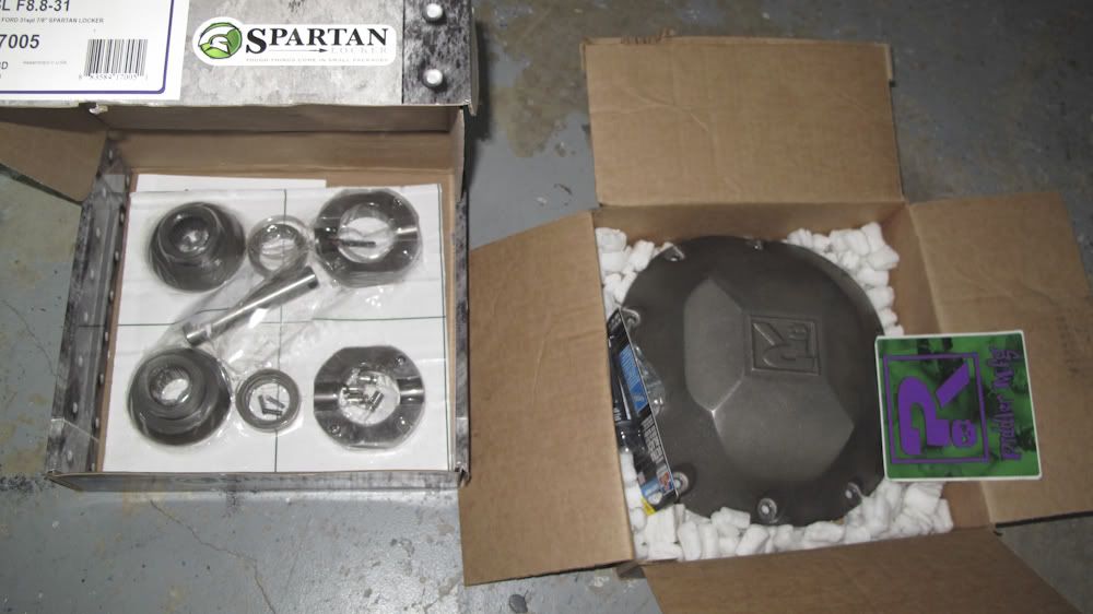

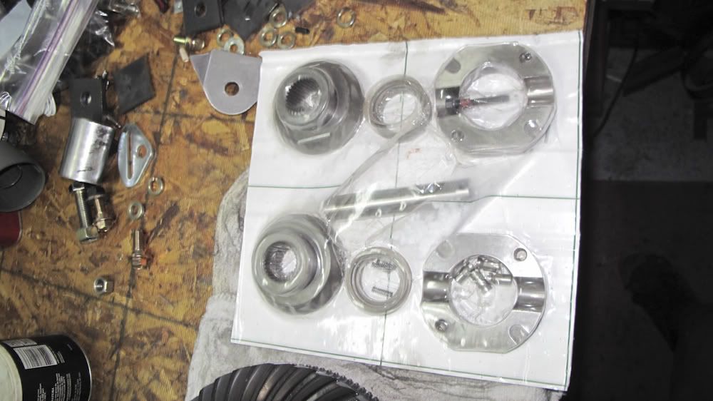

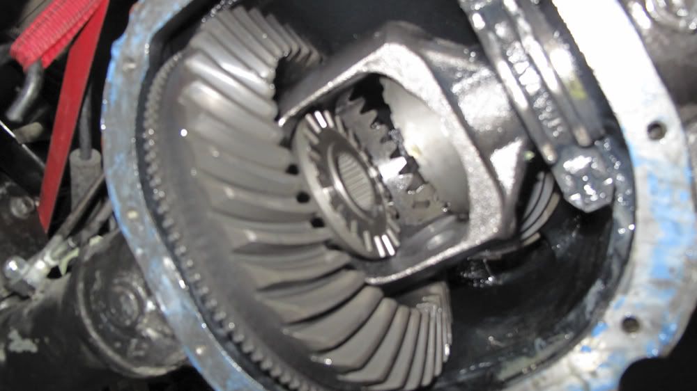

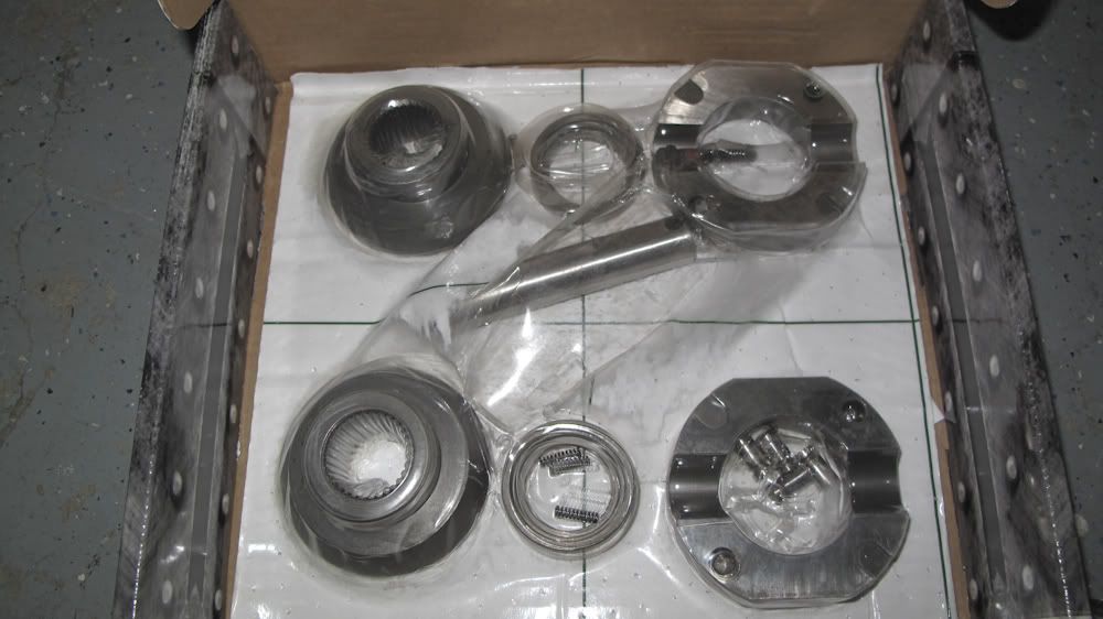

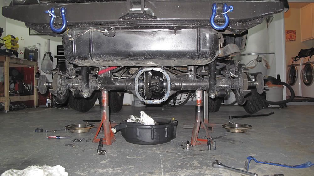

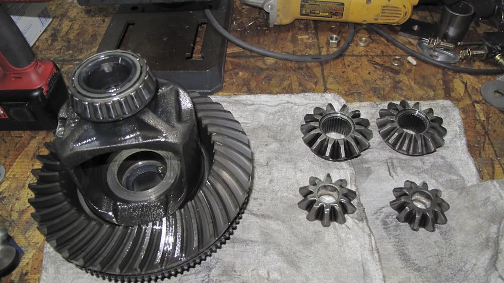

Getting ready to install the Spartan, just a tip for those with 8.8s...leave the carrier in the rear end, no need to pull it.
Because I didn't know better I pulled the carrier, came out pretty easy.
Making sure I have everything to install the locker.
Now getting in the C clips was easy once your realize how you need to do it. I installed one C clip before installing the second locker half.
Installed the second half and jammed in the C Clip...I am so not looking forward to getting these out
Bolted everything back up and installed my revised Riddler Diff cover, had to make it a little custom

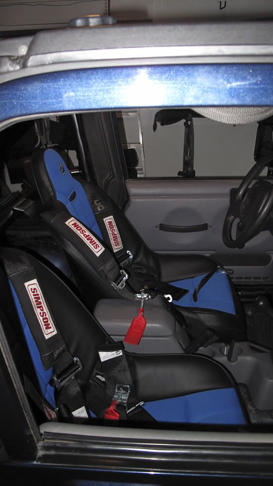

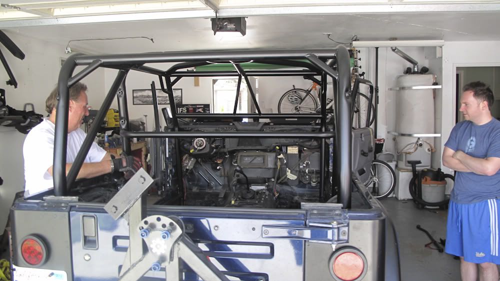

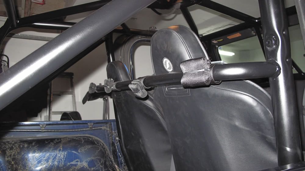

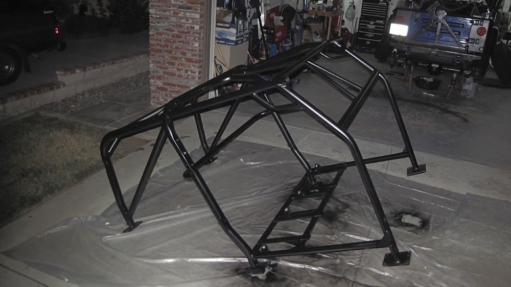

Now that the locker in installed I had to get the cage painted, after welding up all the tabs and new gussets I was ready to go!
Next was to requit some help to get the dam n cage back in, so much easier with more hand to help.
How everything worked out for the seats
Once the dash was in I installed the sliders, seats, and then the center console. Everything went pretty dang easy minus the B pillar bolts, its always something with these damn Jeeps
At this point I am waiting to cut the belts down, just need to do some fine tuning then everything will cleaned up.

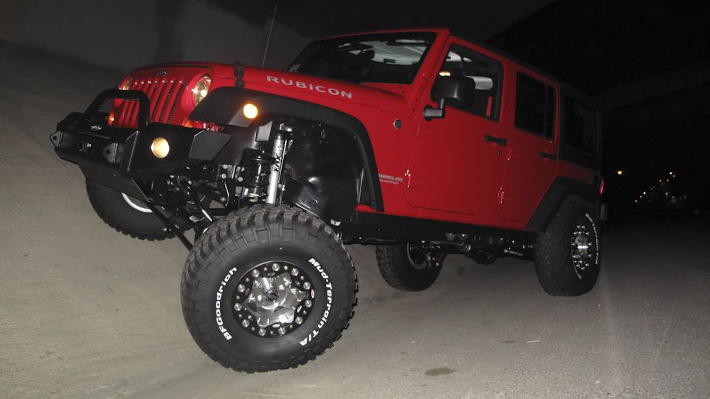

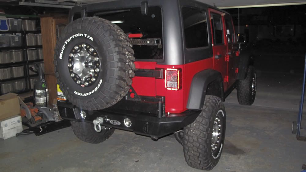

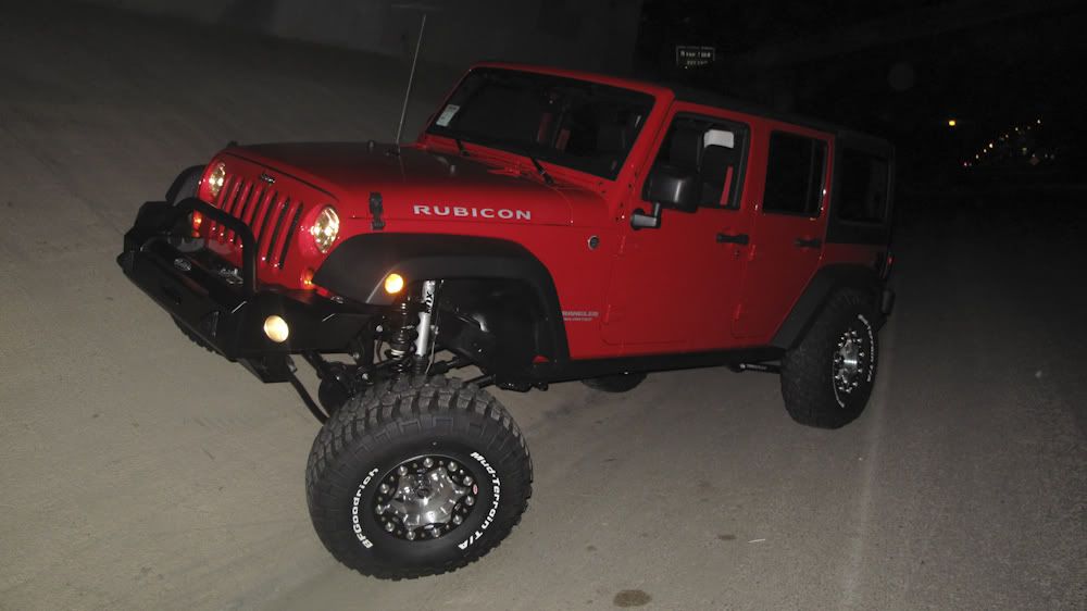

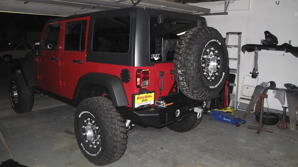

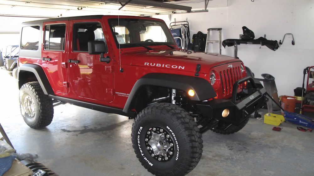

Since my dad sold his TJ (the white one in the photos at the beginning of the build) he has invested in a new toy/project. We installed a nice little bumper package from LOD at the same time which went pretty smooth! I can't wait till this Jeep is built as it will be an amazing piece of work! Also this morning we went to the local 4 wheel parts Truck fest which he spent some more cash on this damn thing! Nevertheless as a good son I provided the garage for us to get the Jeep put together!
Lift was installed by a local shop called 4West. Jeep has maybe 70 miles in which I have driven it 50 of those damn those 3.6 are
