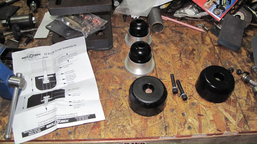

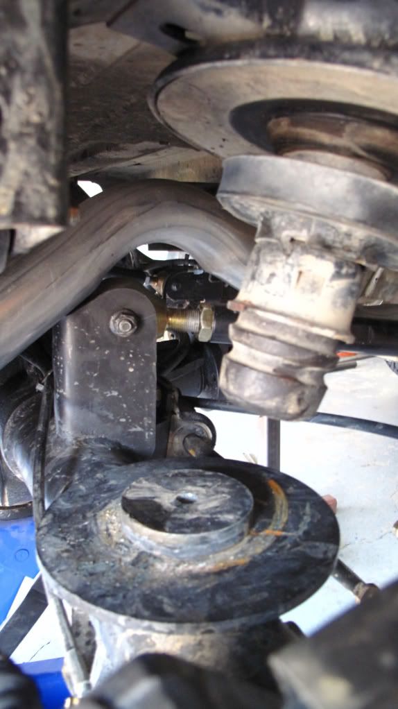

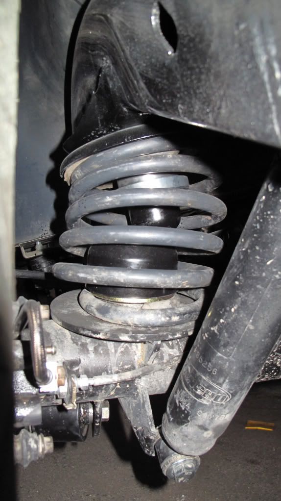

Finally got around to installing my bump stops, install went pretty easy and I can't wait to them them out!
All layout, pretty nice kit and I am looking forward to seeing how they bump out...I forgot to remove my springs and ensure that everything went well, gonna have to wait till I can flex it out!

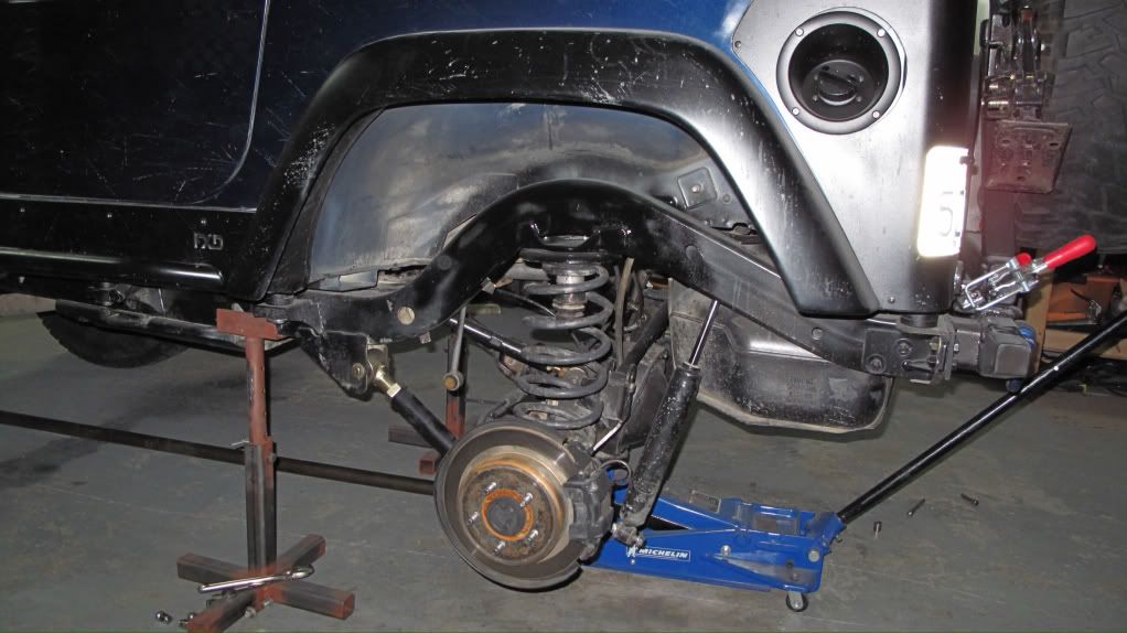

This is what I am starting with....
So that's not going to work so let's start installing the bumps!
Getting them installed, went pretty smooth

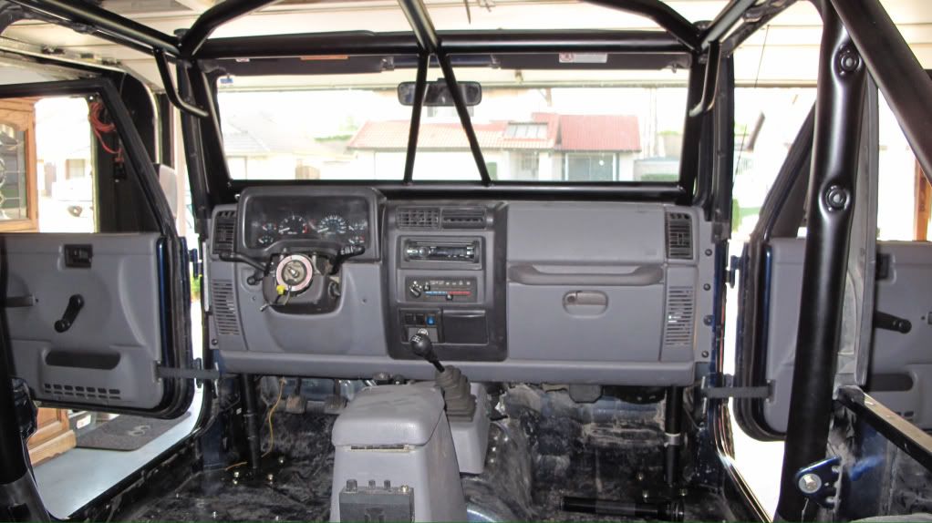

Next was to finish up the cage and and install it , got everything I needed done today minus the C pillar mounts. I should be able to knock that out along with the dash tomorrow.
Cage was primed and painted, came out pretty nice and the install was pretty easy.
Since i will be installing my new seats I left some of the cage unprinted, this will allow quick work when welding them in! Replaced those dam n B pillars with some grade 8 hex head bolts, made the install way simpler!

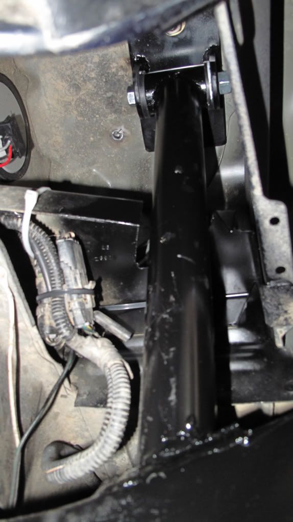

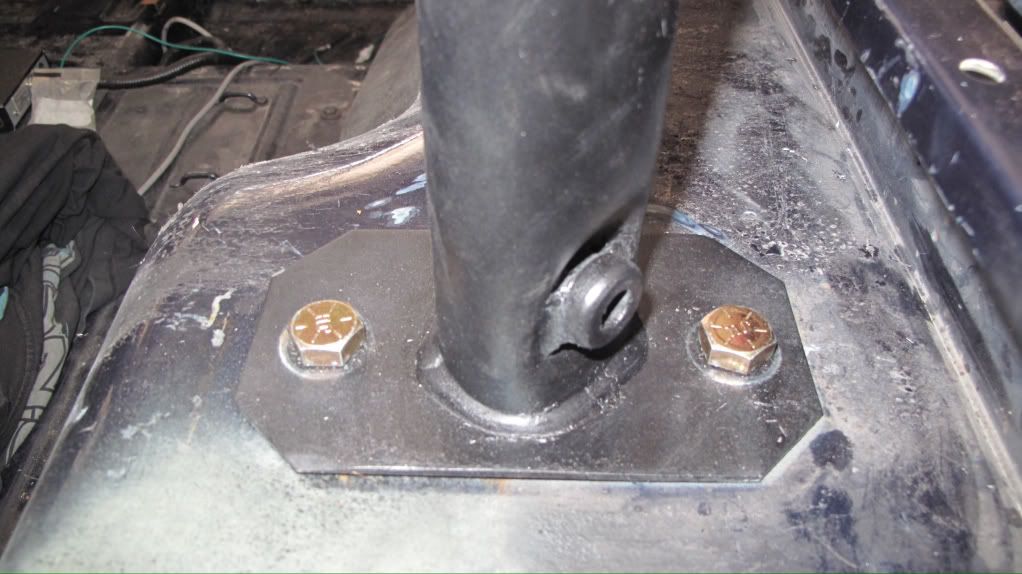

Finally drilled out the A pillar mounts, goal was to get them tied into the frame.

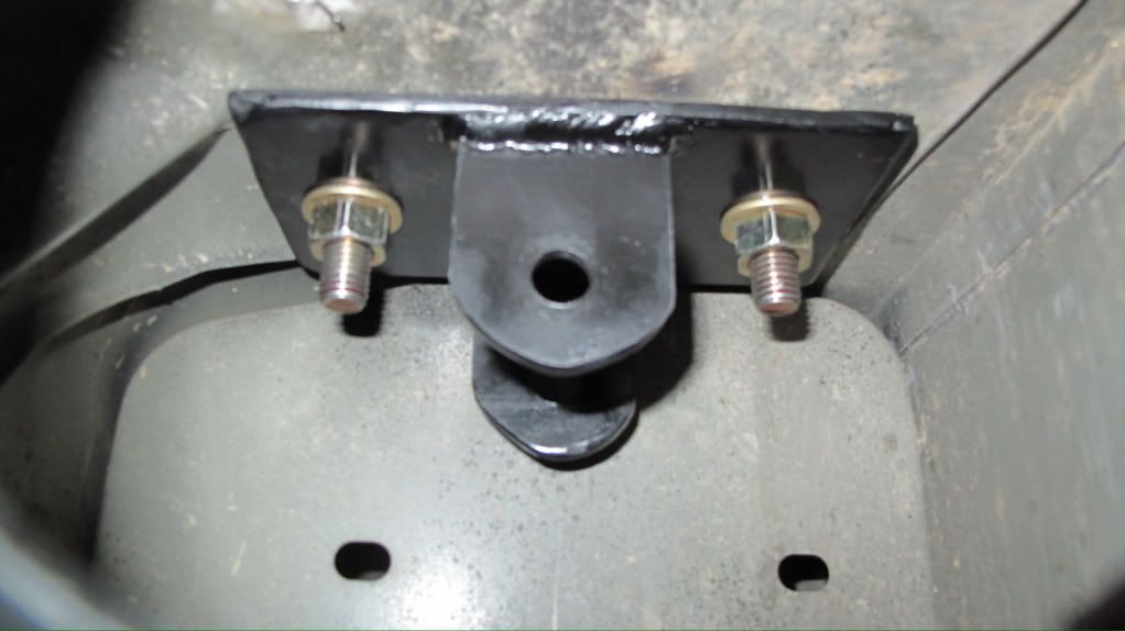

Made some frame reinforcements out of some 4x6x1/4 strap, should hold up nice. Also had to fab up the bushing tabs which are also out of 1/4 steel, shouldnt have any issues with them in the event I have to use them.
Now from what I read that it's a pretty good idea to to sandwich a piece of DOM between the floorplates. In theory this should eliminate the false floor from collapsing In the event that I got rubber side up.
Had to drill out the hole, used a 2in hole saw so I count account for the welds.
Got them all burned in!

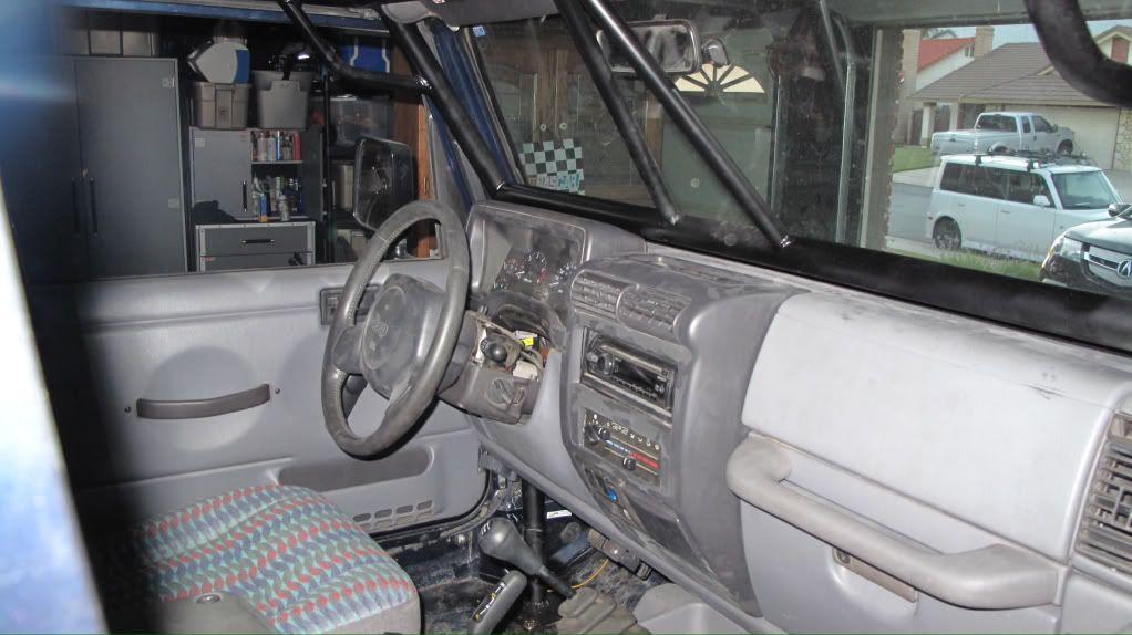

Well it's been a long long 3 day weekend for me, but got a lot done and she's driving again!
I have some small projects to get completed, need to finish the driver side C pillar tie-in. Passenger side took up much more time then I though and waking up late didn't help!
Drilled out the factory C pillar mounts and added some nice 9/16 hardware, I don't see this going anywhere....I just hope I never have to find out! (I see I didn't have the washers I place, I promise I have some 9/16 grade 8 washers)
Now I was going to just leave the bushing mounts square but I figured I might as well male it look nicer...not 100% sure these came out that nice lol
For the frame side mount I use a piece of 2x4x1/4 strap ontop of the frame then welded the DOM to that. Driver side is going to suck since I have the fuel lines to work around.

Since day light was running low I started to throw in the dash. I am crossing my fingers I don't need to remove it again to mount seats.
In the process of uninstalling and installing the dash I managed to scuff the steering bezel pretty good. Tried to paint it but that looked worse so I need to either strip it and start fresh or buy a new one.
While out driving I went to my local Jeep Gym and flexed the Jeep out to see how everything went. Looks like my rear bumps might be a tad short....I mean a tad! Also my from swap was still connected so no pointing fingers!
Little side shot! Over all pretty happy with it, just need to get my seats and locker in and I'm ready! Well now I think about it, I need to finish the wiring and Monsterline the tub....

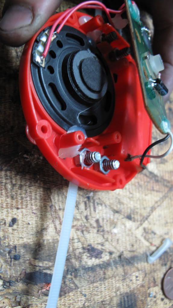

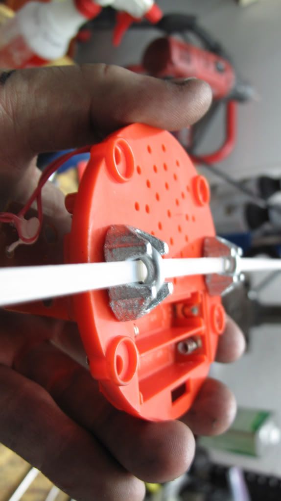

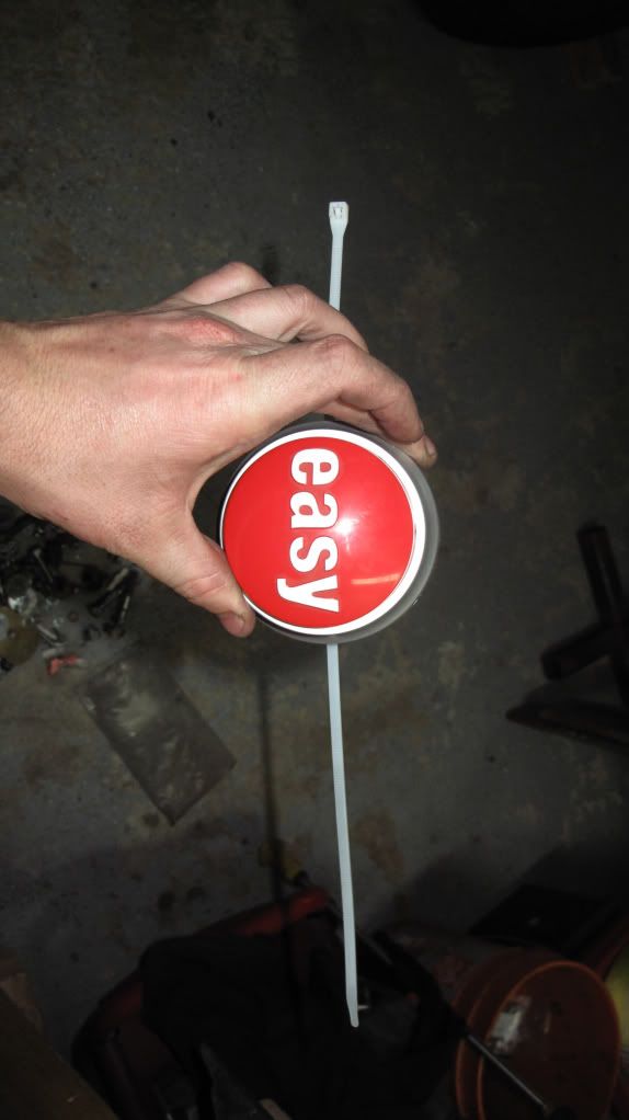

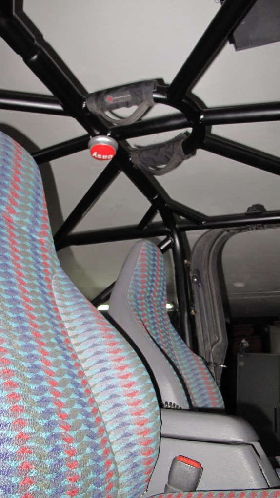

Another late night innthe garage tonight, can't really say it was 100% productive....on the other hand I let my creative juices flow! First was to paint the inside my fender wells in the rear, the faded blue was not really working so I sprayed them down in black. Also pushed my rear axle out 1/4 on the driver side since it was a tad off after installing my coil buckets. Now the fun started, I know I am not the first to pull this mod off but that didn't matter. I installed my Easy button!!!!! After debating the location I think I selected the best and simplistic location....Enjoy!
First you need to pop the button apart, ai,ply pop off the black screw covers and remove the screws. After that pull it apart and remove the weights that make it heavier then it need to be, that's where I put the u bolts. Next simply drill the holes and install the u bolts, I added some loctight to ensure a nice strong hold.
As you can see its pretty tight so small nuts are a plus!
Start putting it back together, I put the zip tie in and wrenched the u bolts so it wouldn't wobble.
Once you put it all together you should end up with this!
Now put it where ever you decided would be best, in my case I put it out of the way attached to the cage.

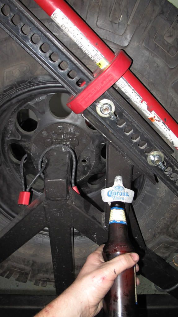

Like I said it was a rather productive night in the garage! Also got a chance to add abottle opener, slapped it to the inside of my tire gate. Nice simple and refreshing mod I might say
