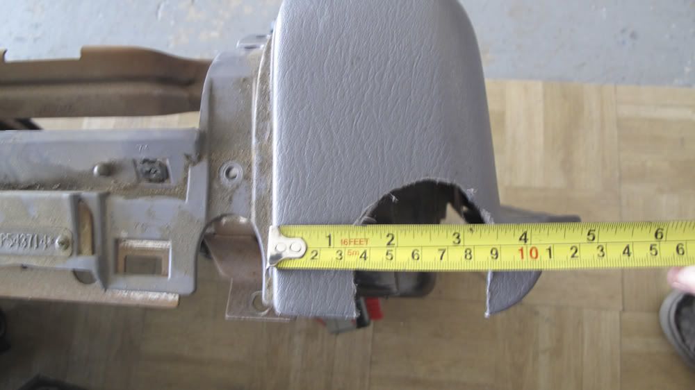

Naw just eyed it just take a 2in hole saw and aim to the outside of the duck work lol I'll see if I have some photos
Got some photos of the dash, sorry its all I could come up with since my dash is out LOL
I would say hug the door side of my cuts, I have about 1/2in or so of a gap on the side furthest from the doors. Get a 1.34 saw and dremel and go to town, well take your time if you care more then I do

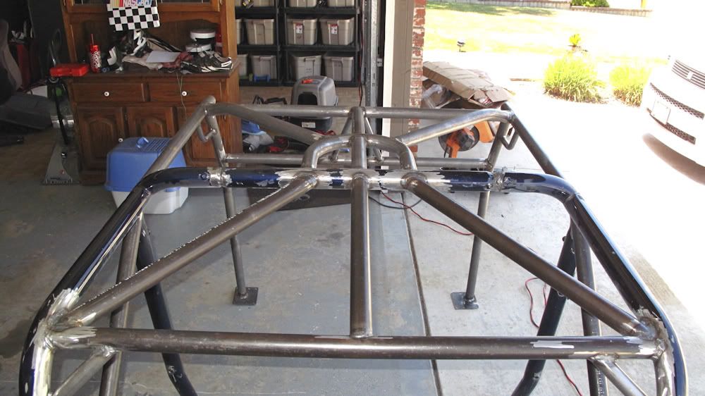

Ok well this has been a fun and very long last couple of days! Got the cage about 70% done and need to make a metal run to complete the rest of the cage. All that is needed is the rear supports, couple more 45 gussets then strip and paint. Still think I'm going to get some 5 points before completing the cage install back into the jeep. Also needing to do my A pillar and C pillar frame tie ins which should be rather simple... I hope!
A pillars went in pretty easy, dash cut out wasn't to bad but I did crack my windsheild in the process of the cage install. Futher Mucker
Still needing to see what I going to do with the windsheild ends. I don't plan to run them and I think I'll just cap them.
I think that pulling the dash was a mistake....what a PITA it was to pull apart, I have a feeling I'll have some extra screws left over LOL

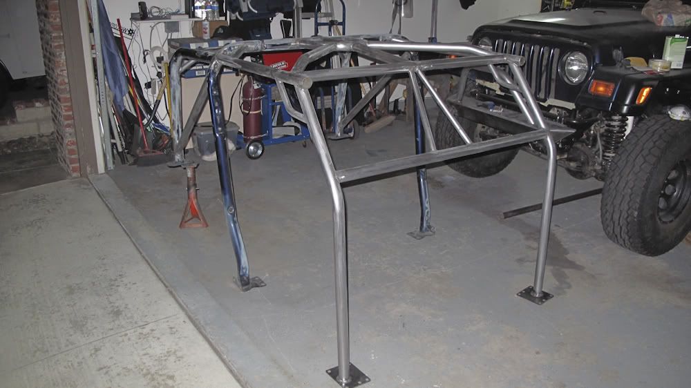

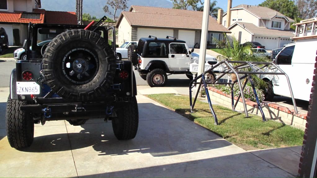

Got the cage pulled out and welded up..Things are so much easier to weld outside the Jeep
I really love the way TJs look without the cage...only if I would die just driving to the trail I would so rock this.
Prettyn icy as the cage is sitting now,still lots of work to be done....I am beat!

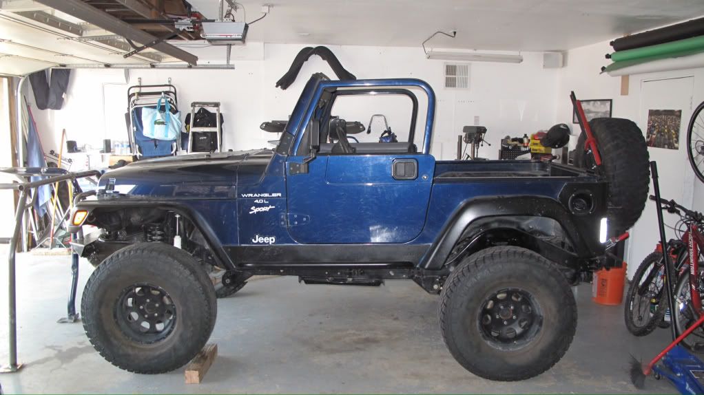

Another side profile shot, looks like my rear end sits about 3/4 of a inch or so high since clocking the spring pearches. On a side note, currie should be dropping off my bumpstops in the AM!

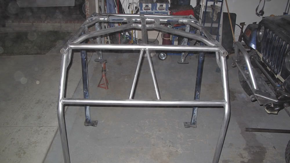

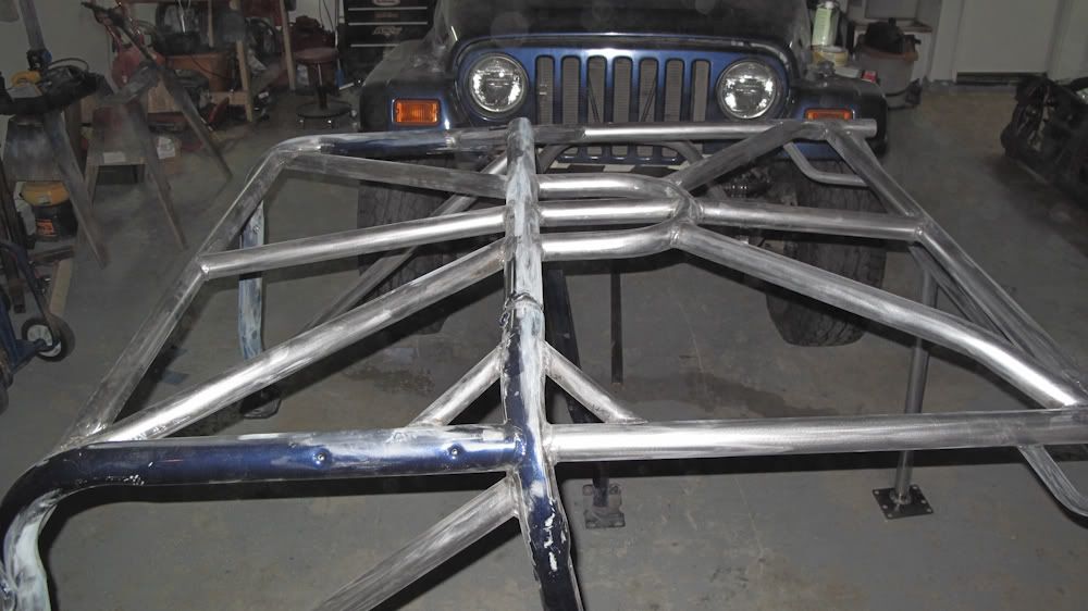

Posts: 549

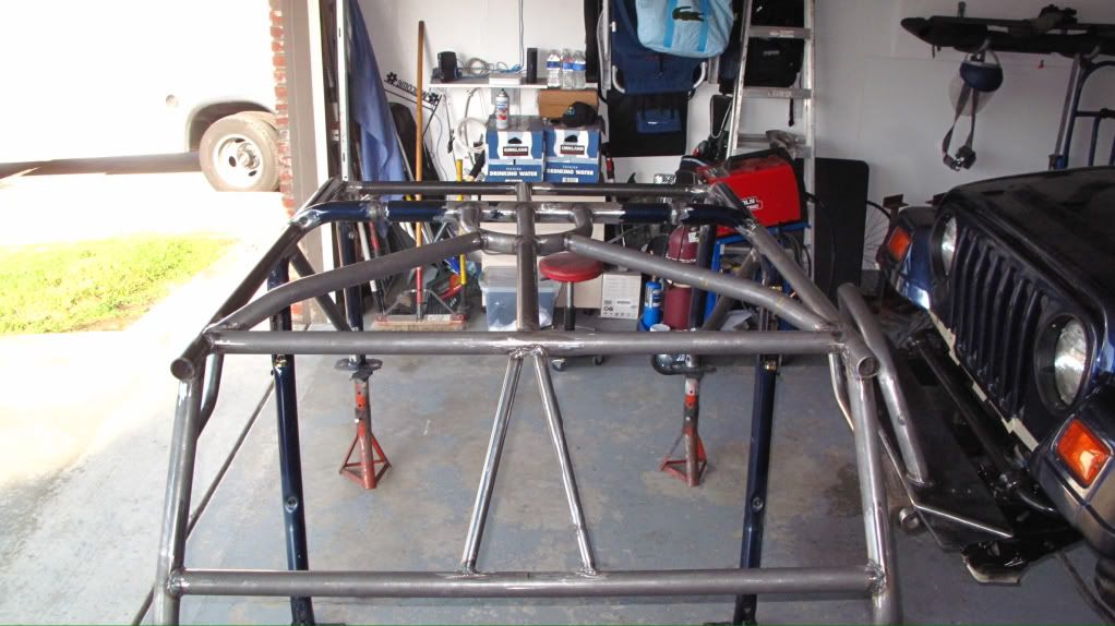

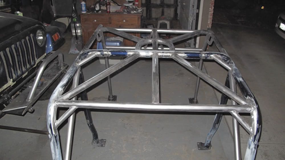

Ok a little more of an update, man this thing is a lot of work. Tossing around the cage by myself is a real pain in the ars but it needs to get done. Got most of the cage welding done I think, need some opinions on any gussets or bracing for those who know more then I do. I do plan to in stall 5 point in the next few weeks, I am planning on running a tub from B to B just about the floor as my starting point for the seats. I will also be running a piece of tube from my A to B to stiffen the cage as well as a seat mount. After that I plan to get a harness bar from B to B then kinda X of that to add more structure.

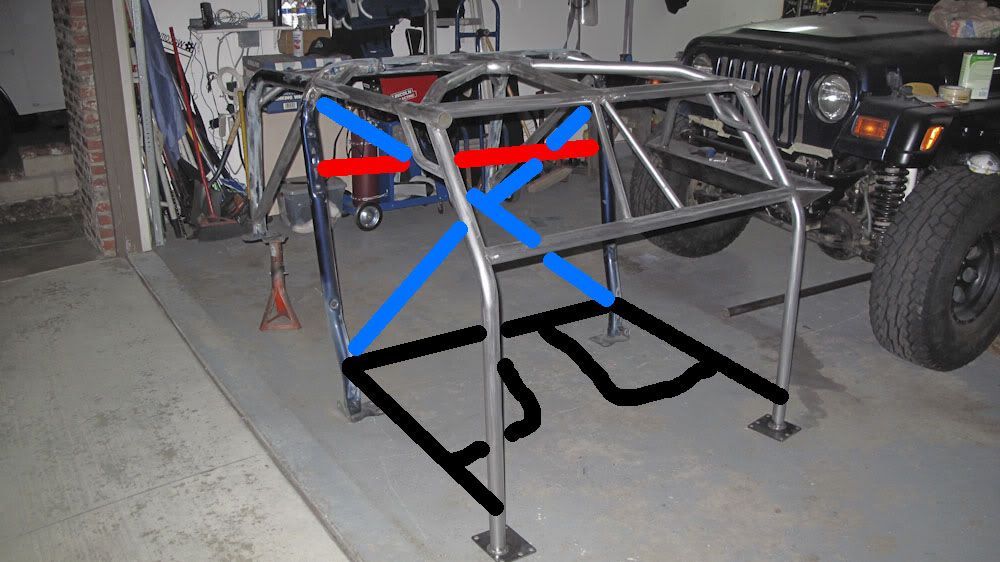

Here is what I am thinking to complete my cage, again please let me know if any changes or additions should be made!
Black is how I plan to connect my seats to the cage, also help stiffen the cage.
Red will be the harness bar, thinking of ordering the one from Poly performance.
Blue would be the X addition to help reduce the crush factor of the B pillar.
Also note the frame will be frame supported via the A and C pillars
