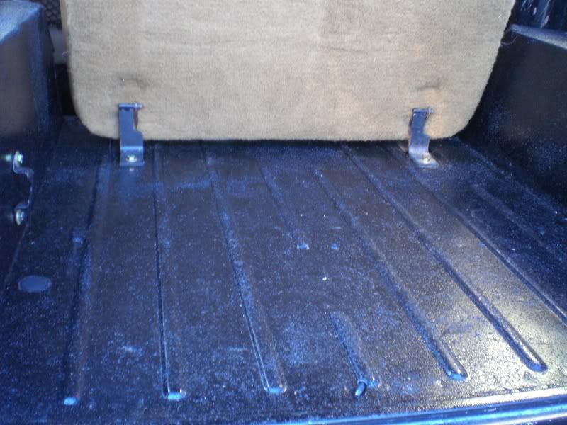

well it would have matched perfectly if q tec sent me the right one, the no bells and whistles 130 dollar trailmax but instead i got the bestiop trail max aqua. i guess they were out of the one i orders. its super comfy,ill take a picture of it tomarrow for you.

another update, put some grade 8 bolts in, started on oba got it working. drilled a hole for the switch for oba just need to wire. i have a test video also, sorry photo bucket butchered the quality
New seat

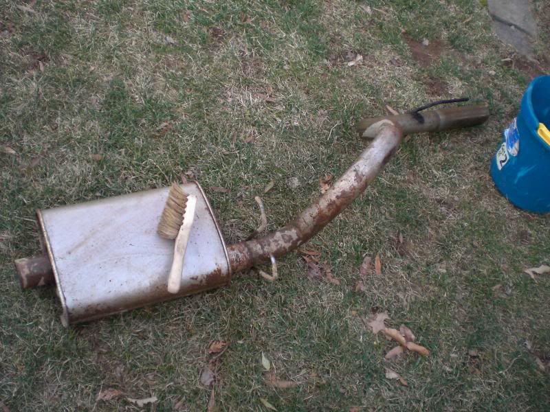

Cleaned and painted high lift, finished oba, and took exhaust off to paint, srove to store and the master cyclinder went. Took it out when it was nice today and ordered a new one
before
after
bad master
dirty exhaust then cleaned and found cancer

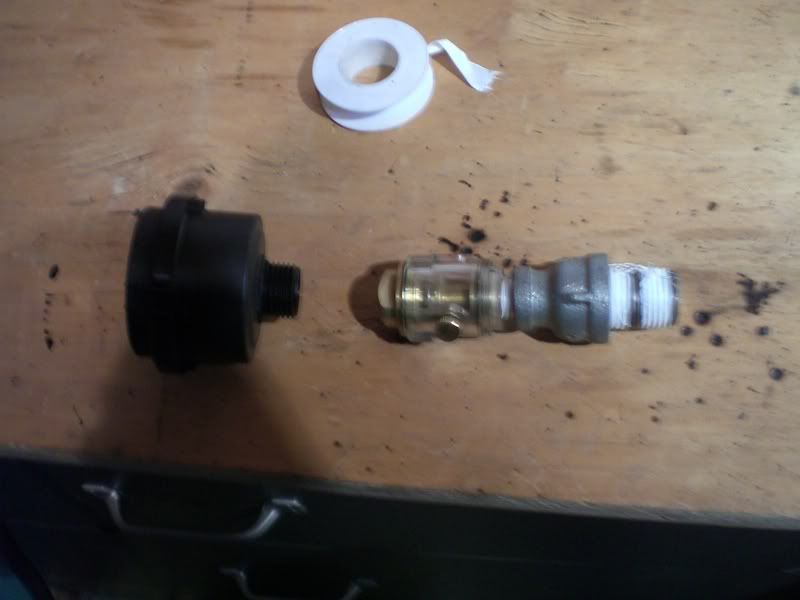

I just tied up the oba yesterday. basic of the basic because i have no money left. i used a stock AC compressor off another 2.5. heres a picture
basically theres the intake with a oiler and a filter and then the out put has a bunch of fittings to get it to the right sizes and then a manifold. off the manifold are various pecices like a saftey valve and a quick connect for the hose. Thanks for the compliments guys

i got it for 20 dollars off ebay. You need one for the wrangler, the WJ ones will not fit. you will need a longer belt and another pully. you should be set after that
