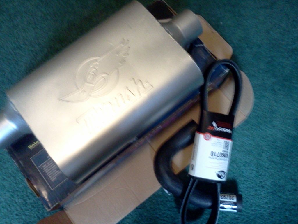

Pick up some parts from the local parts store.
New serpentine belt, radiator hoses, thrush welded muffler, and a new down pipe.

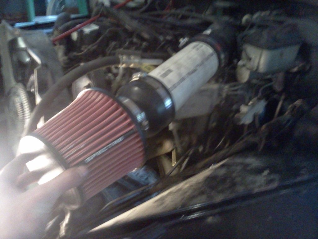

Been working on figuring out all the wiring and engine stuff. Made the air intake, won't be too much of a cold air intake but it should pick up a bunch of wind off the fan...
Yup that's a piece of PVC, I still need to paint it black and mount it to the fender.

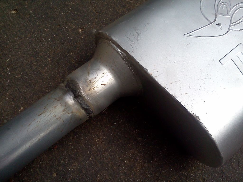

Built this exhaust, just straight pipe, no cat, thrush welded muffler and a turn down before the axle, muffler is clocked for off road clearance.
