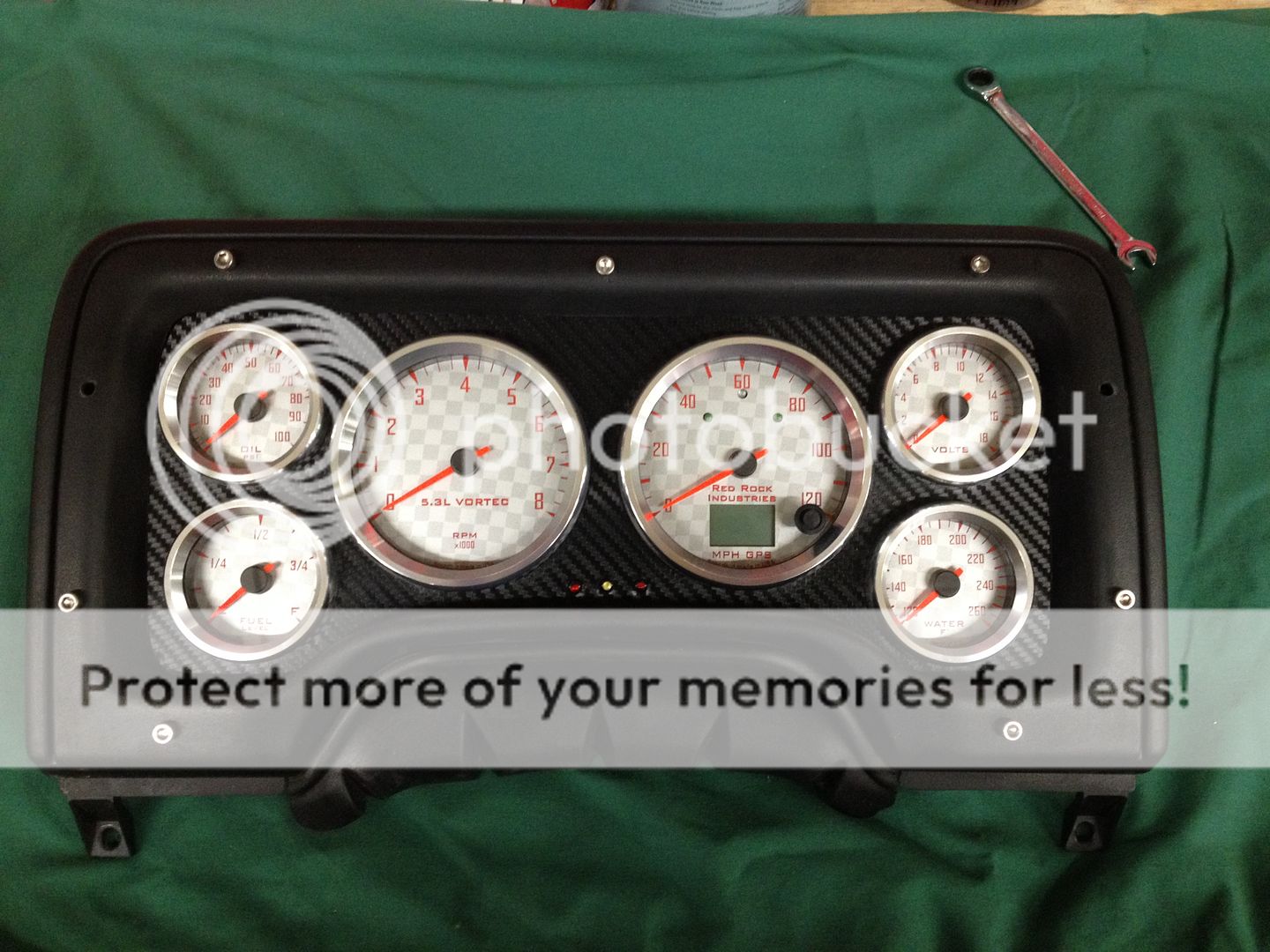

copy that.... well then here you go buddy. if you want to go with something like this PM me and we will make it happen. we are now a speedhut dealer...
http://www.speedhut.com/gauge/GR338-...PM-Shift-light
using the stock tach may just work, yeah maybe worst case you would have to reflash the ecu.. but having a tach like that ^^^^ one, would be cooler, even with the auto
heres the gauge cluster for the silver ls TJ I just did... eye candy that functions !!!!

I don't want to have to reflash the PCM unless I send it to you and have you handle it. It took way too long to get it back last time. But Wayne will supposedly reflash for free, I just have to pay shipping.
I do like that gauge though. Is that the right size for a YJ bezel? Will it just be the 1 wire hookup? PM me with a price buddy
I'm sure it will be after the holidays though...

When I get to the shop I'll look it up buddy. I'll double check the stock Yj gauge size. Yes it would be singe wire to the tach signal, power and ground.
