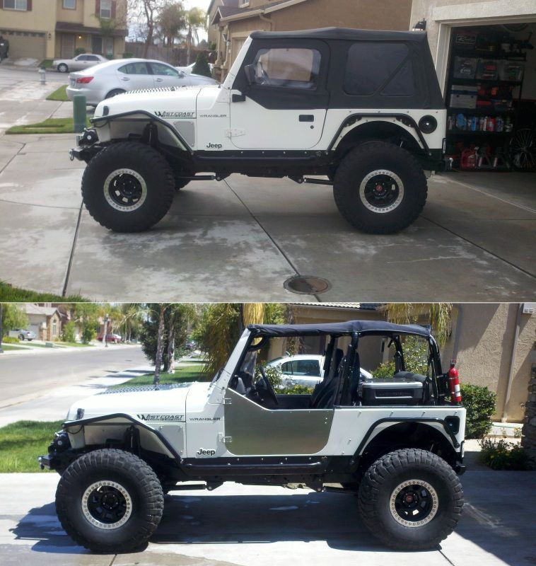

Here is how I did the stretch on my CJ7.
Used stock RE YJ springs front and rear.
Shackle reversal up front. Moved the spring hanger out under the 2" x 4" bumper welded to frame horns. Used MORE spring perches for SOA w 3 different holes for fine tuning stretch. MORE steering box bracket to relocate box 1.25" forward to clear front stretch.
On the rear, I just used the adjustable spring perches. I wish I had done the previous comment and frenched the spring hangers after moving them back and mounting shackle hanger to frame. I got 6" of stretch. It handled great off road and at 70 mph. Very little spring wrap with a V8. No traction bar or sway bars.
