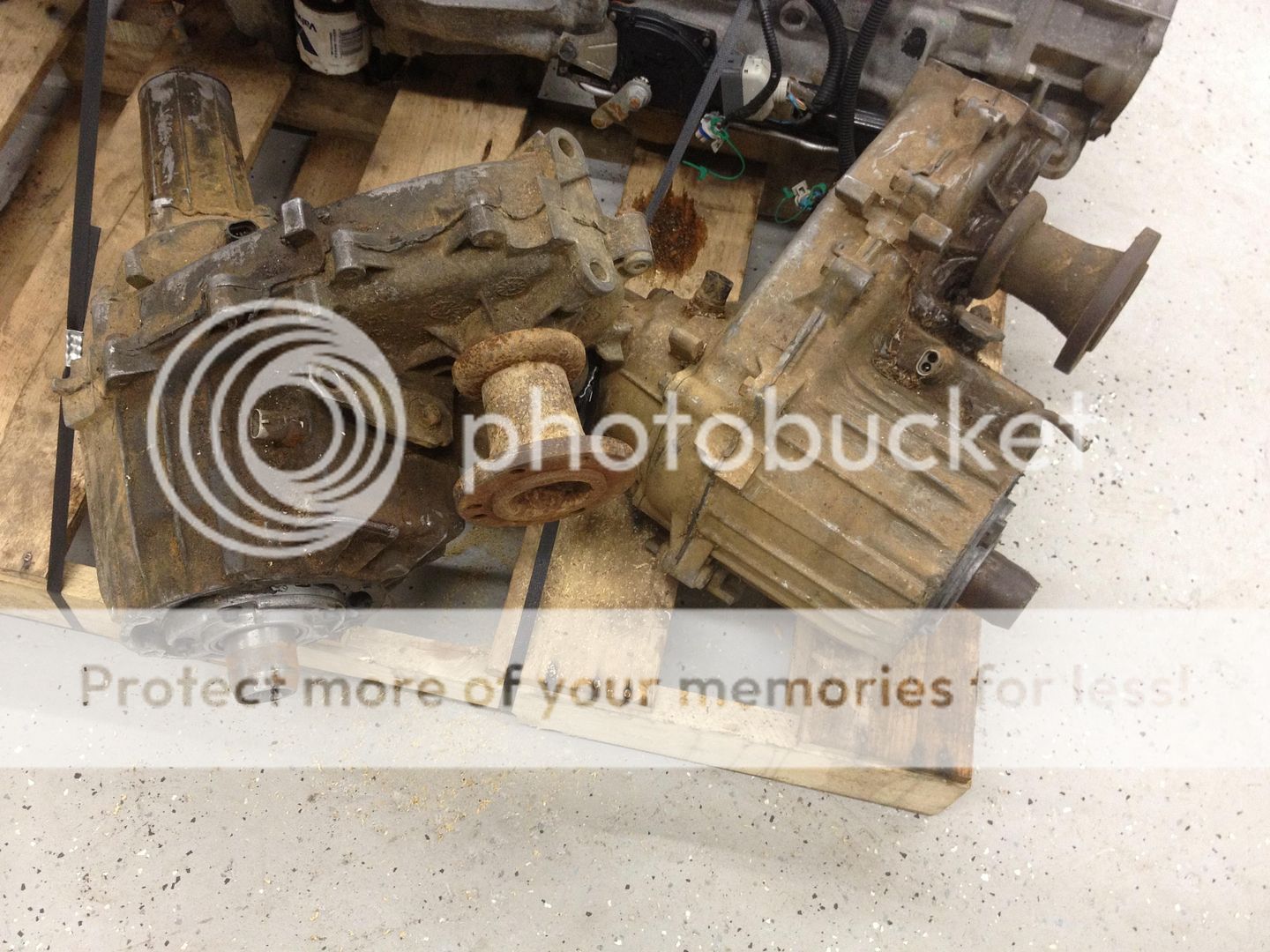

ok buddy.... picked up the [2] np241c transfer cases this evening. hmmm one has red fluid one has brown that i found when i set it on the ground. oh well they are both going to be torn down and rebuilt.
the np241s have 6 gear planetaries and the wider chain... research research, 'they' say you can put the 241 stuff in the 231.
supposedly i can pull the shaft and tail cone off a dodge 241 and eliminate the slip yoke feature and quite a few inches. think im still just going to get the SYE kit from JB with the GM VSS in it.

I didnt realize the front output was a flange. Are you gonna keep it or put in a yoke? They came out of 1/2 ton GM trucks right?

Idk as if right now. Guess it would depend on what setup will clear the best. The 241s shifter lever is pointed up vs the 231js which as we know point down.
Have to see exactly how that all works and see what I can do about a cable shifter for it.
