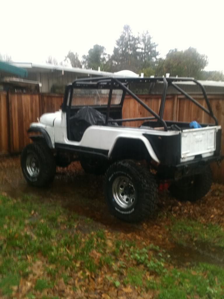

Here's what she has as of now, 4" rough country lift, lokar shifter, drop brake lines, yj power booster, new rear brakes, full exhaust w/flowmaster single chamber, new repo seat beats, front hoop for the roll bar. There is more sitting in boxes!!! She rides good on the road but I am starting to feel the rear driveline angle vibrations. So a CV is in my very near future! I never did roll the diff or install the drop down pucks that came with the kit. I think that even if I did both of those things I still wouldnt like it. I will post more RECENT pics soon.

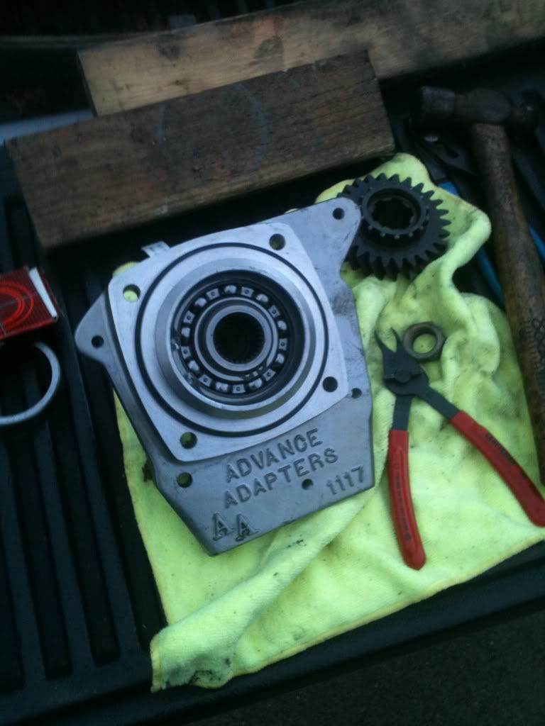

Here you can see that on the Dana 20 the 4x4 linkage was running into the wide th350 so I shaped it out and this big cut was the result.
This is a close up of the spacer I had made. I just drilled and taped the tube that everthing bolts to. Works good.
I have been cleaning things up and putting lipstick on her! I have the dash put together and it looks nice, I also layed down bed liner and installed the tuffy box. It will need more body work on the rockers and fenders, but it's getting close to paint... Maaco here I come!!!! The to-do list.
