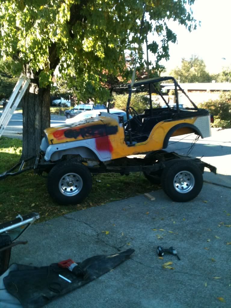

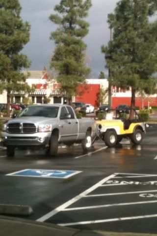

This is after the first day of me bringing the old girl home!
I got to work very quick, pulled the body off with my redneck tree crane... Rated at 2500 lbs!
Then I set about looking the frame over, which was not too bad. While the body was off I pulled the 258/t18
and sold the combo! Love the 258 to death... But after owning a few, I am over the whole inline thing!

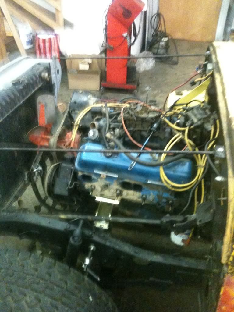

So next was getting the motor, I already have a 350 Sbc in my cj6 so I guess it's little brother also needed one!
The motor and tranny came from a friends k5 and the best part was I got to test drive the truck!
I pulled the motor on a Friday and by Saturday had everything in place!

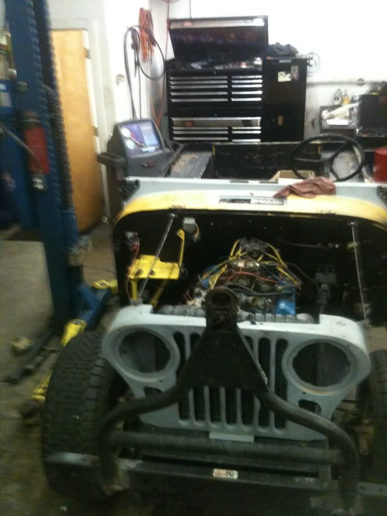

On Saturday morning I had everything I needed to mount the motor, tranny and tcase in the car. Dummy rad motor mounts, tcase adapter, old cross member and the body bolted on. I was thinking I would be in for it... After putting the v8 in my short nose 6 I was getting ready for battle!!! As I started playing with the whole package in the engine bay I soon found out how much the extra 5'' made with the long nose. WOW! After I checked everything over I.e. Exhaust,drive shaft, steering shaft, how the motor sat. I looked at my firewall,it was all there not one cut!

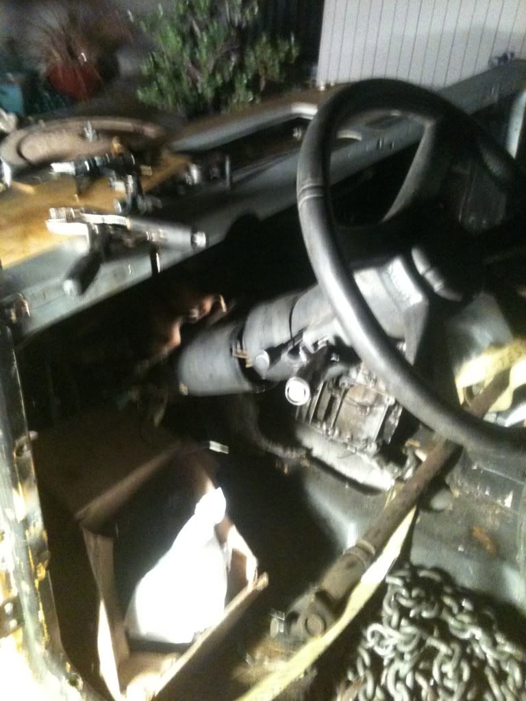

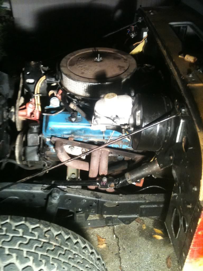

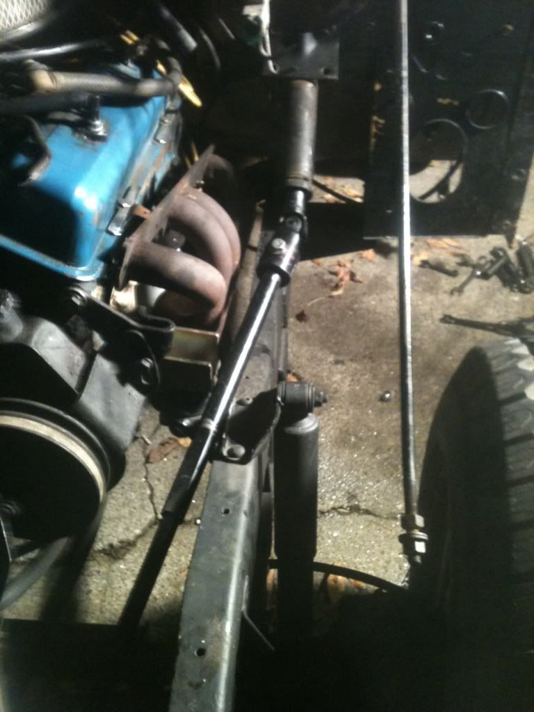

So just this last week I gave it a power steering box from a xj, cool part is that it went right in! HAHA I also put in some late model cj7 swing pedals. And with that I was able to rid myself of that big *** wheel because I then put in a chevy tilt wheel. When I killed the xj I stole the power brakes off it so I put that in too. Some fine print I left out.... First off the box is out of a 1998 xj with the o ring style fitting, well my p/s pump off the 73 k5 so it has flare style fittings, no big deal got the high press line off a 95 s10 blazer 4x4 and I have a newer p/s pump off a chevy with the o rings. Because the chevy tilt is a 1990 the end is not splined, but rather a square shape! It took me a couple xj steering shafts to make one but it is just as nice as the $300 ones
