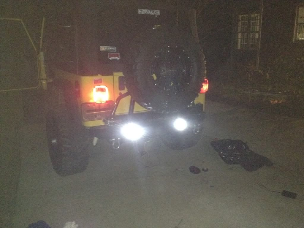

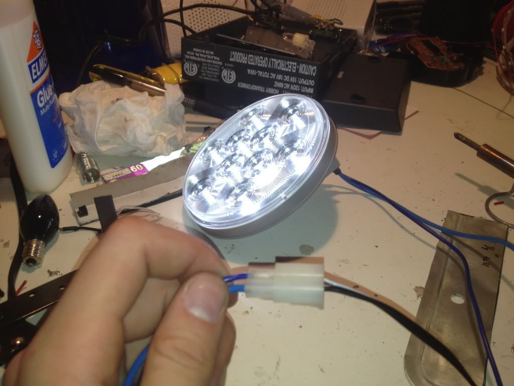

Last night, i wired my led backup lights into the backup light circuit. Then i modded the circuit in the cab to a double throw switch. The I is wired to the backup circuit. The II is wired to a constant 12v. The output goes to the lights. So now my lights work normally or can be turned on and off whenever. This mod was a huge PITA, especially when i cut the wrong wire in the cab and had to patch it, despite identical coloring.
I used the male half of blue bullet connecters. They worked perfectly.
Heatshrinked. I melted the plastic around the holes to lock in the connections and make them more water tight.
Taped up
Testing my skills
I decided to tap in at the trailer harness because 1. I am about to remove the tail lights and want to have the pigtails intact for selling. 2. I still wanted a plug inbetween the lights and the jeep harness. The outside plug will be cut off of the trailer harness and my led tail lights will be soldered to the trailer harness wires.
One in with the tail light removed for other reasons
It is a great mod, but the switch got the best of me. Took me nearly 8 hours for everything.
