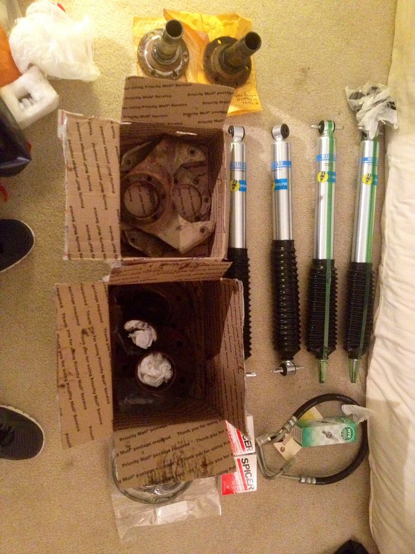

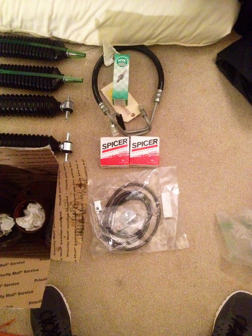

Came home to all my packages!
Well since you asked...
Bilstein 5100's
Dana 44 5x5.5 swap parts
NTK B1S1 02 sensor
Spicer 5-760X U-joints
Crown Braided 3-4" Extended brake lines
Mopar P/S line
Busy day tomorrow, then Richlands Rd Sunday!

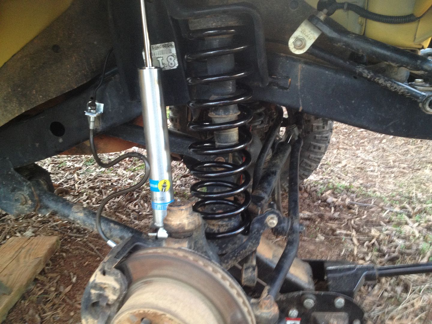

Posts: 9,835
Installed BDS 3" coils, Bilstein 5100's, and Crown Perf brake lines in the front. Didn't have time to touch the rear. Sits with a pretty obvious rake now but that just convinces me that the 2" rear coils will be perfect. Felt good on the road but I noticed the biggest difference on the gravel driveway. Front end floated over the gravel like it was paved.
