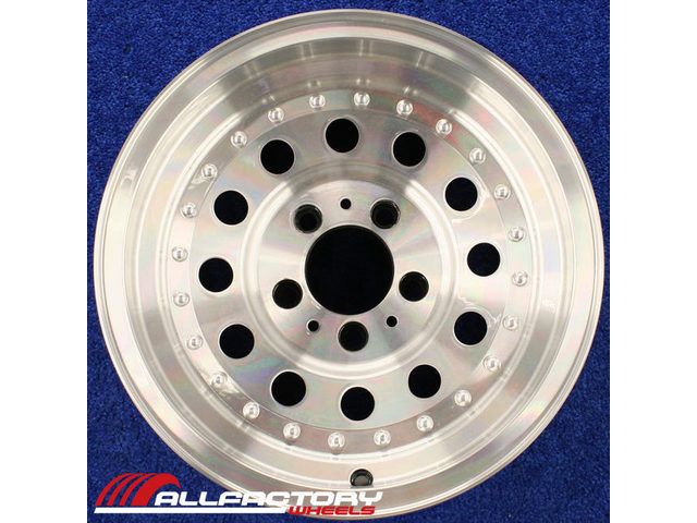

Hmmm... I seem to have run into a problem I didn't expect. I recently discovered these Fuel wheels are double drilled for 5x5, not 5x5.5 like I thought (which makes perfect f'n sense now that I actually think about it). The problem is that should I magically get the 44 swapped in in this lifetime, I wouldn't be able to do so without changing up the wheels. Apparently nobody makes a 5x5.5 to 5x5 or 5x4.5 adapter. Which means my install would be further pushed off until I could afford my beadlocks. Damn that's disappointing.

Just get some cheap used 35s and some used rims to run until you can afford the 37s/beadlocks. Then sell them once you are done with them and recoup the majority of what you spent on them. For example, stock f150 rims that can be found used for dirt cheap:
Same solution as your current front axle. It's what I would do.
I would most definitely have to paint those before they came within 20 feet of my rig. But I do believe my next tire (for now) will be a 35 regardless so that probably isn't a bad idea. I hate buying things that I know I'll end up selling but obviously, as you said, I'm already doing that. Another thing keeping me from getting the 44 in is I'm pretty sure the ratio is not 4.10 so I will have to regear when I put it in, and I really don't want to regear the 8.8 and install the Super kit without putting a locker back there. I'd like to have an OX installed. But who knows, maybe I can afford that by the end of next summer. Do the install next winter break.

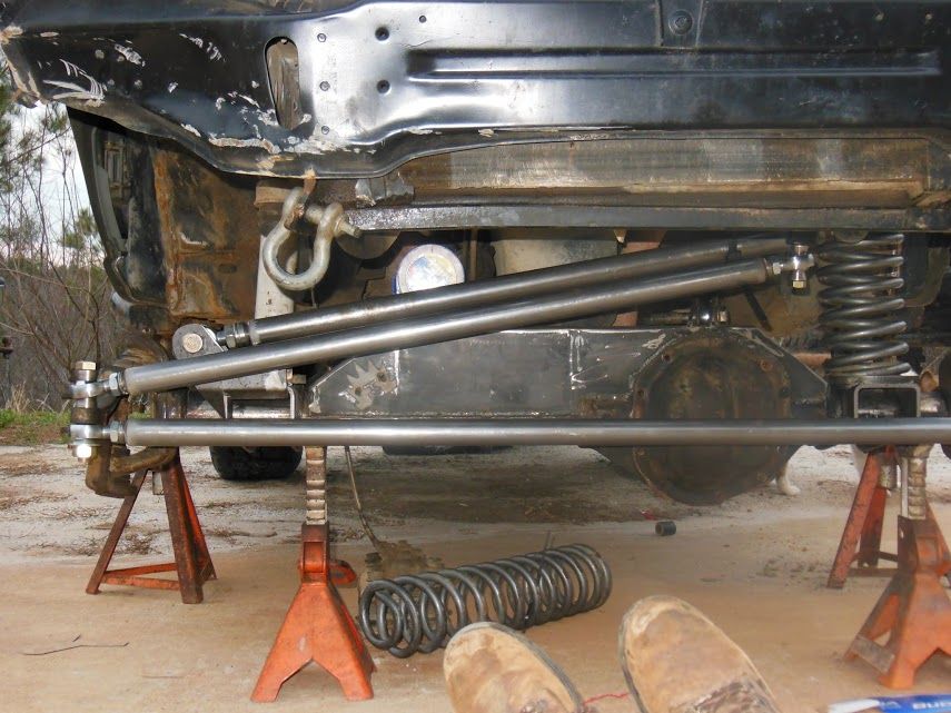

Yeah, I get my gear work done cheap by a friend. If you are doing heim steering this is how I would do it:
Jankoid is offline
I figure I'll have to do something like that to avoid frame interference, although I was thinking tie rod above the arm. And I'll have to mod the TNT truss, since I ordered it with crossover TB mount.
The Offroad Club @ NC State; Founder
The Yellowtail Build
Jeep-Owner.com
sjones26573 is offline
post #1932 of 2317 Old 12-03-2013, 06:52 PM
Jankoid
Location: Albemarle
Posts: 4,897
That setup doesn't use a high steer knuckle. To mount the tie rod over the knuckle safely would require inverted T steering, which blows. You can still use the crossover bracket for the strack bar with that setup, you just have to compensate with the frame-side mount and the pitman arm.
Jankoid is offline
Right. So you're saying you can't do this safely:
Which I would have to agree it seems like that puts a hell of a lot of shear force on the bolt.
