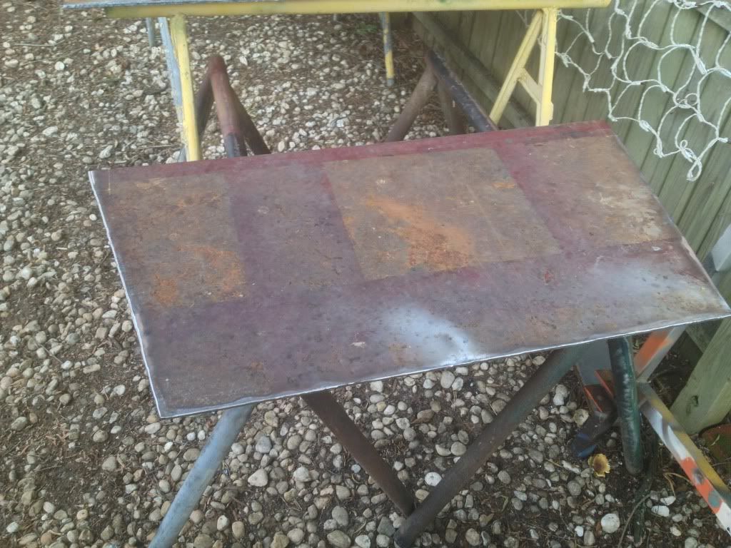

Totally forgot to post that I cut out and grinded the edges of my skid today. Torch made quick work of it. And despite the pic, it is angled. Going to drill holes, put a radius on the edges and paint it tomorrow. Probably going to weld some cross supports as well. 1/4" will flex.

You know that the frame tapers in right? It is like 8 inches narrower at the front of the skid than the rear. So you gotta trim it down.
Best Thing to do is use your old skid as a template. Just mark the edges and holes with a soap stick, and cut it out accordingly.

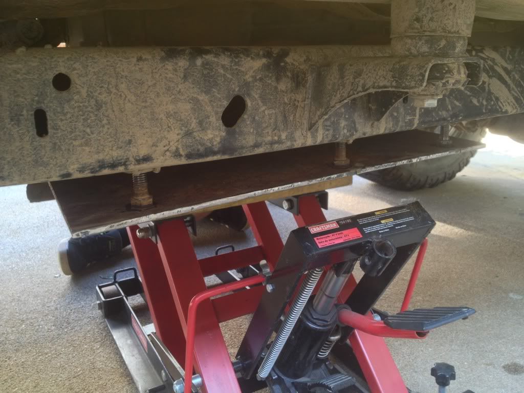

Took a flap fisc to the rusty side of the steel and got it shining. Other side is still spotless. Had to get creative to determine hole position since the cat was in the way. What I did was thread the bolts in a couple turns, then jack the skid up so it rested against the bolt heads. Then I just traced the heads with a sharpie and drilled in the middle. Only got the starter bit holes drilled. Also ground the tacks on the nutserts flat and painted the bottom of the frame.

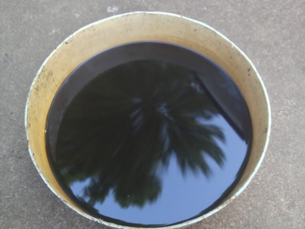

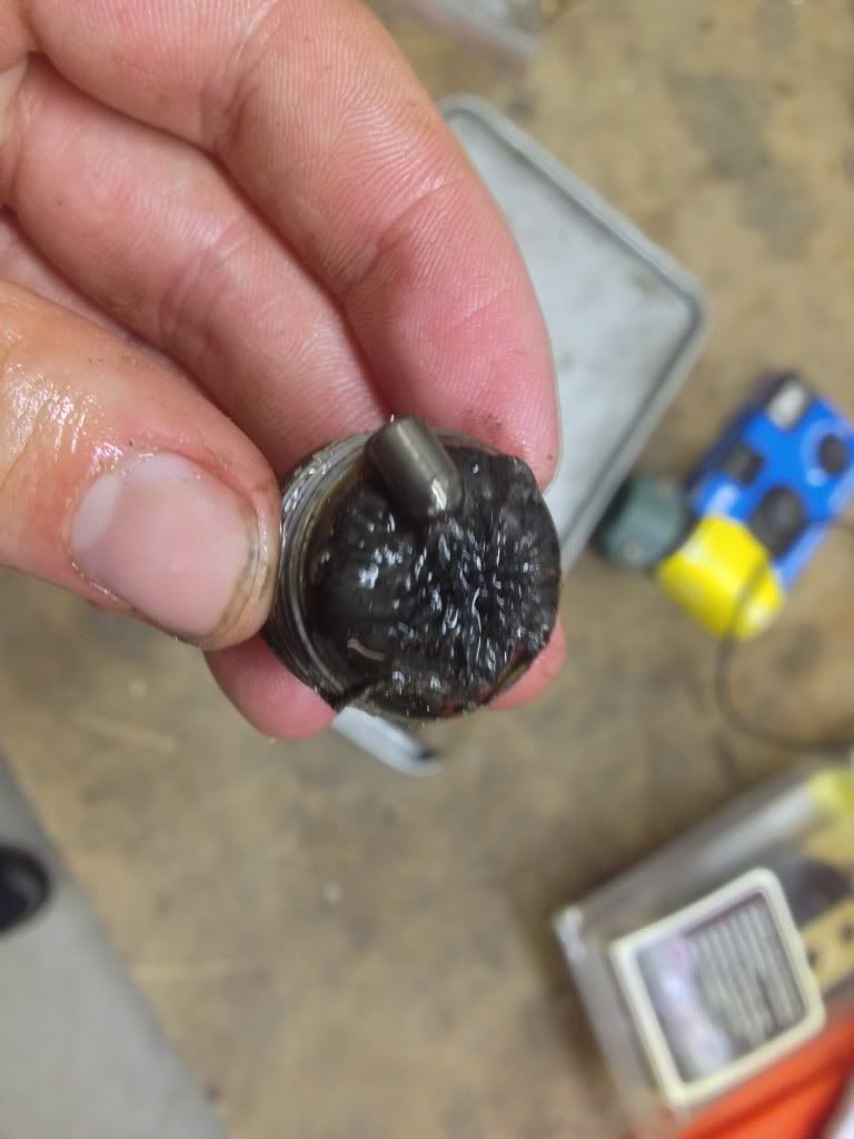

So today I had the 2nd transmission in 2 weeks blow (this one failed completely), which we believe at this point to be the mechanic neglecting to change the old fluid out of it. Not long after I pulled off the road, I had a farmer on a Golf Cart come over and cuss me out for having 2 tires in his hay field (which was so short it wouldn't have effected the hay) and claim he would be back to take my Jeep until damages were paid. So for his payment, I called the Rowan County Sheriffs Dept. They sent two cruisers out who agreed the farmer was being an asshat but suggested I move it somewhere else. I only had 1st gear, so they threw on the blue lights, blocked Hwy 152 (main Mooresville road) and gave me a Police Escort to a nearby closed gas station. They both offered to buy it, which with as much trouble as the thing has given me, I considered it. Trailered back to the shop in Ktown and I started tearing apart the driveline.
Notice the black fluid:
