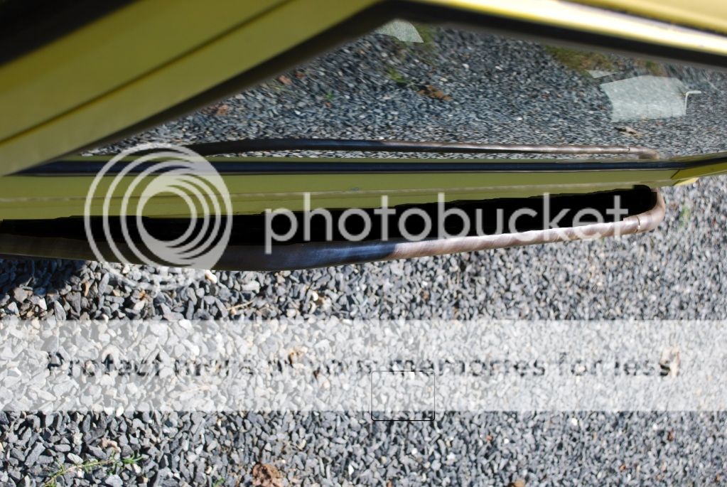

my question for you scotty is did you want to get more tire coverage and/or make a flared version for the rear tube?
Have you considered cutting the sheet and running the tube flush with the body?
My masterpiece of a paint project explains my idea in more detail:
-cut the sheet metal marked with the blue arrows
-run the tube under the body marked with green arrows and flush
-have the tube run straight to the end of the bumper
-somehow run an LED brake and backup light
just an idea

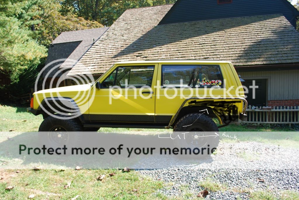

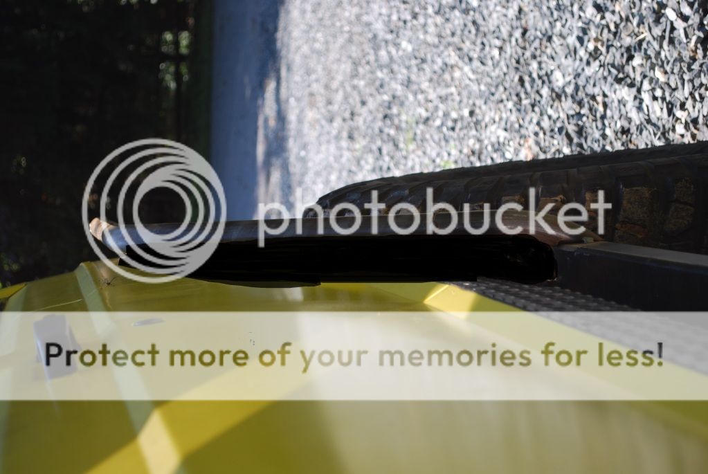

Lout I just spent 30min on paint thank you ha. Anyway here is the idea well as close as I can get it on paint.
top view
Front
Tail light housing that will be made
All that black crap is being cut

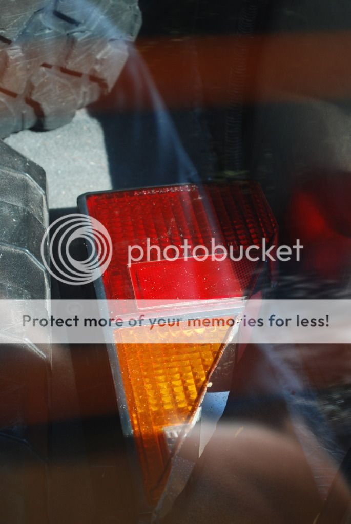

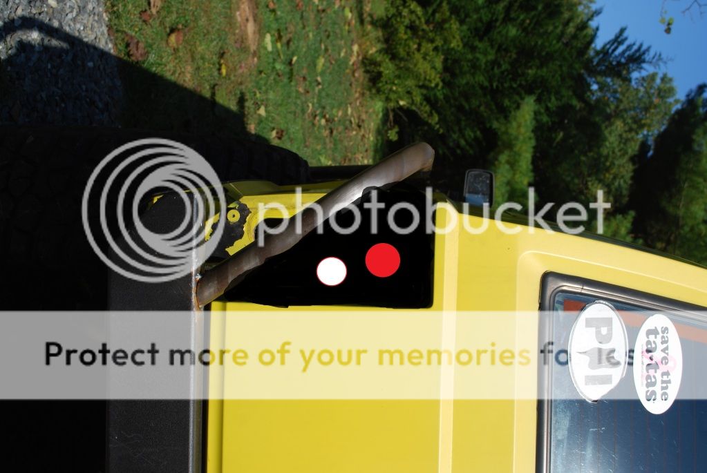

Black top will be sheetmetal to cover flare. Sheet metal is going to come out from inside fender well which I will be working on soon. The sheet metal will come out and sit half way on the tube and get a bead down it all. Tail light housing may be changed a bit still not 100% on it but here are temporary tail lights. trunk was locked and did't have keys.

That's exactly what I want to do to my YJ. Make a rear slider that ties into the rocker slider and rear bumper would really save a lot of weight over a full corner armor and be more effective, it looks like your going to add a lot sheet metal so that may not be true for you but I will look awesome and protect your corners!

What are you going to atatch the inner side of the tube flares to? are you going to tie it into some of the frame work on the comp cut or are you keeping them stand alone? Either way if they get bashed they are gonna move a little sheetmetal unless you clearance them. I personally would frame the comp cut and tie them in a bunch of places and keep the "plated portion of the tube fender seperate from the sheetmetal below the window.
