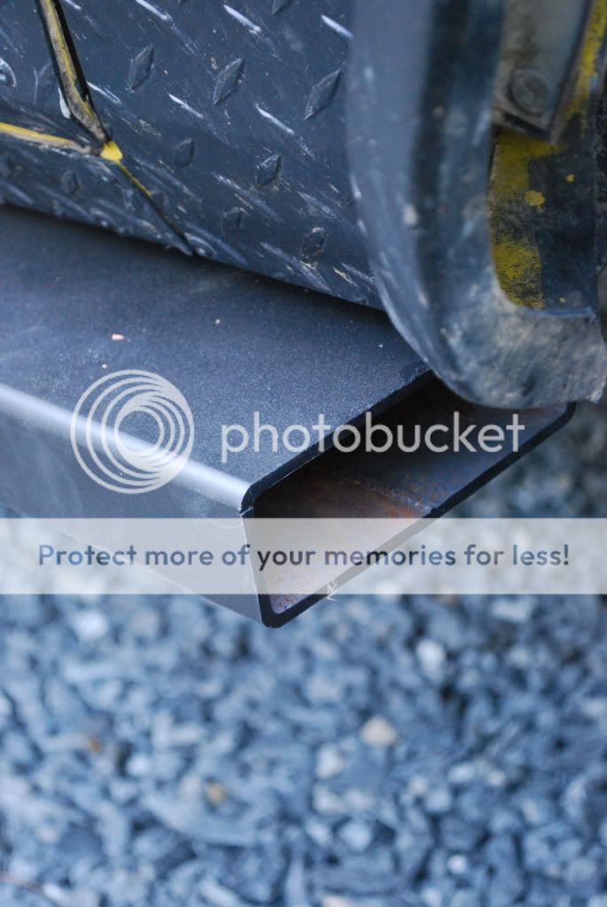

haven't been on in a while but since my last post I made some rock sliders out of 2x6 .118 wall tube and 2x2 .188 wall tube. the 2x2 was used to fasten the rectangular tube to the ruff stuff stiffeners.
Not the prettiest weld right their. It was a pretty rough morning..

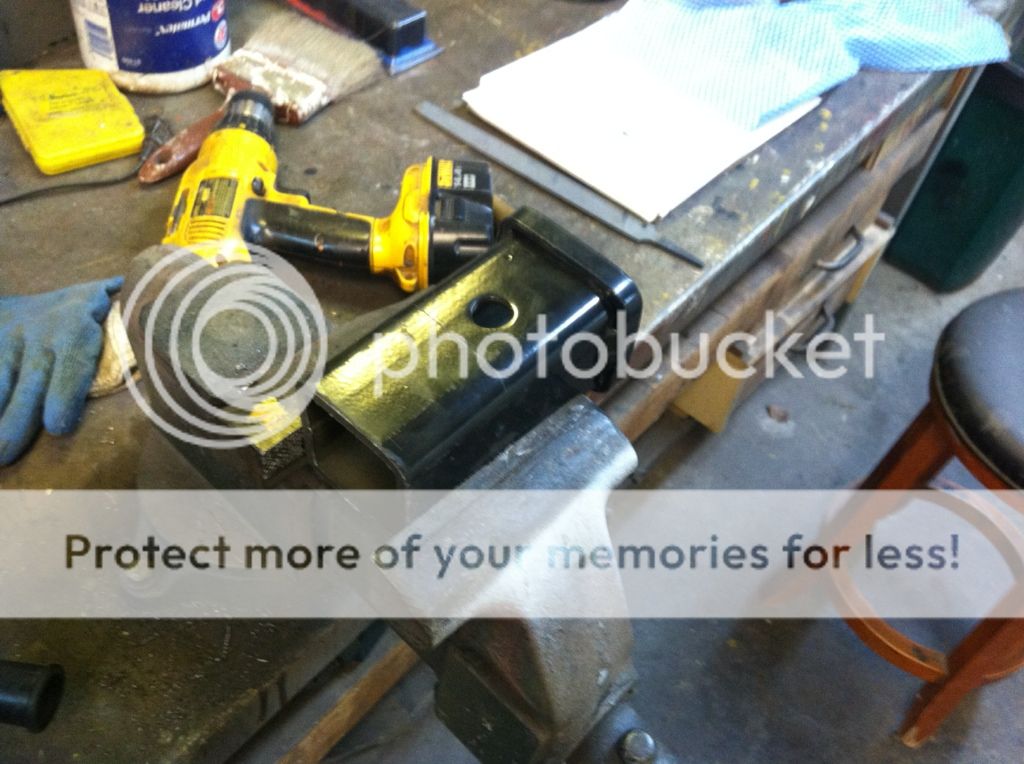

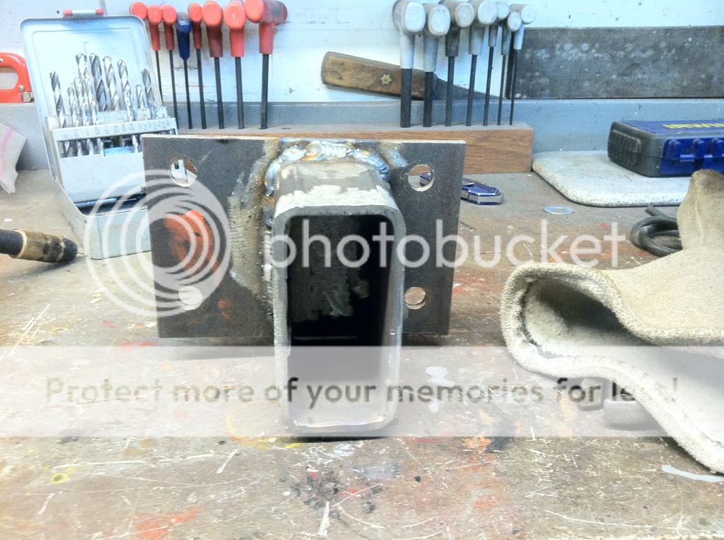

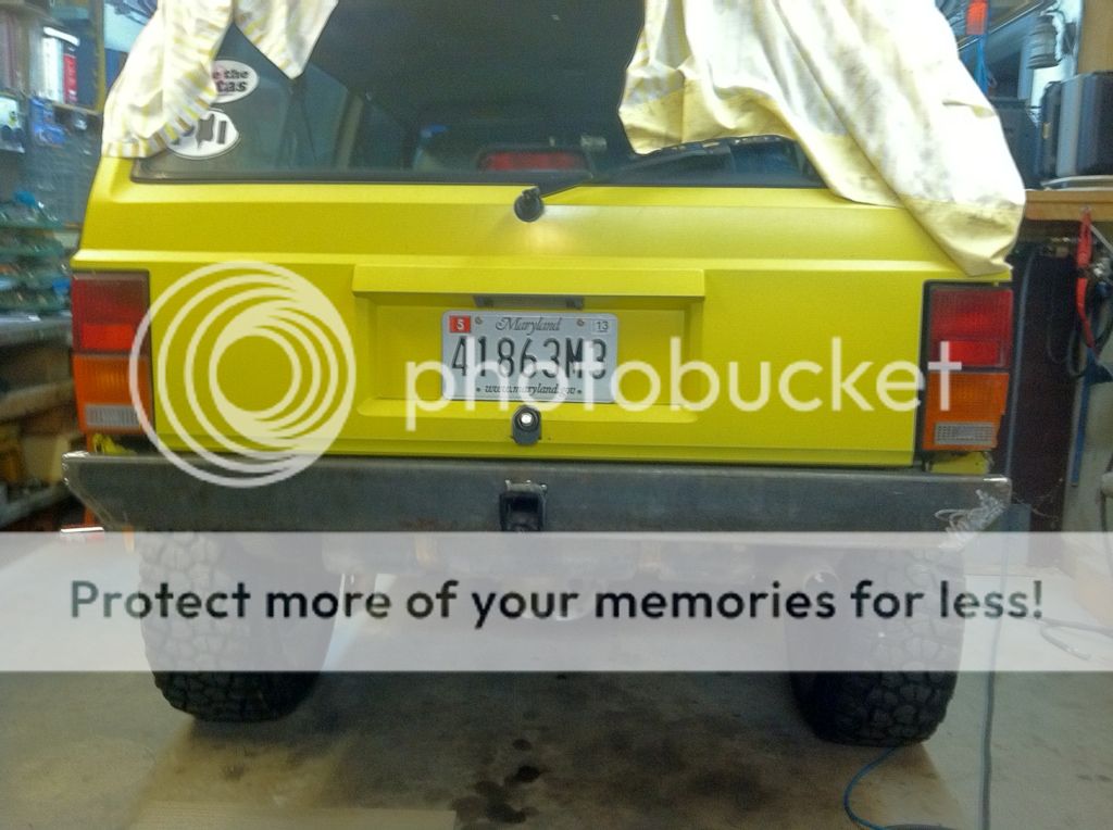

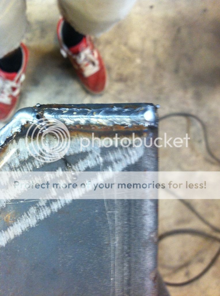

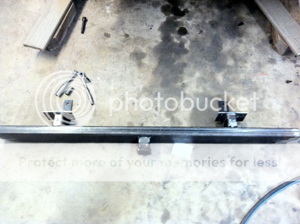

finished a bumper today well just about but here it is
The brackets

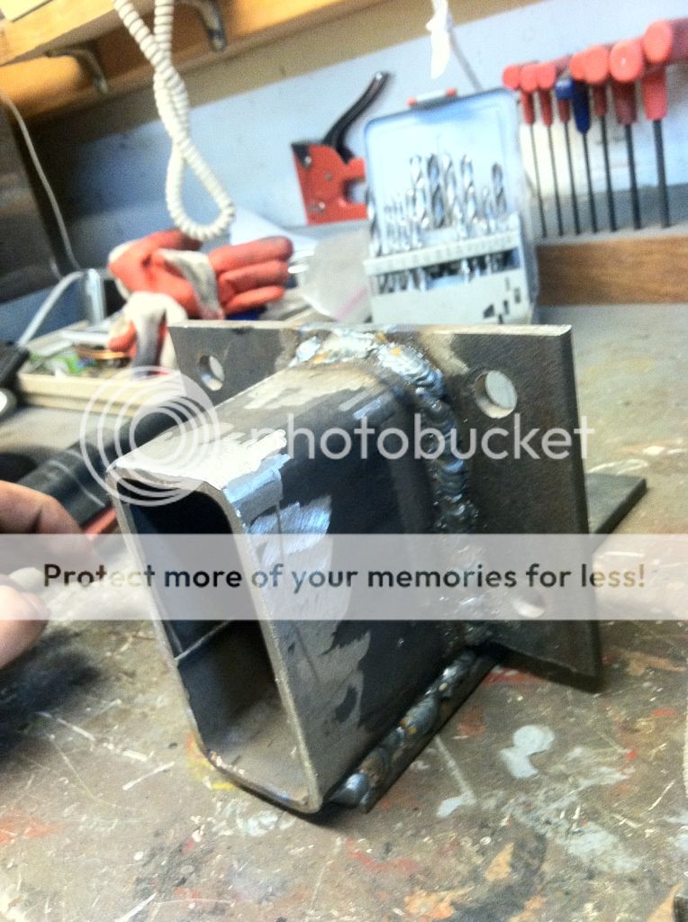

brackets are made of 6x4 1/4" plate, 2x4x.188 tube, and 2" plate that was sitting around the garage.

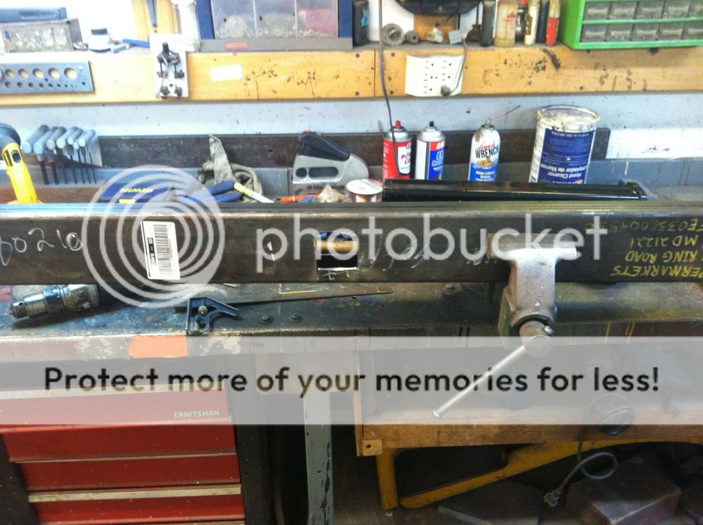

The actual bumper is made of 63" long 5x2x.188 tube
Cut a square in to add a receiver I bought from good old harbor freight
placed the bumper up to jeep and tacked it all up to pull off and weld
just need to paint it now
ugly welds on the brackets, took me a bit to get used to new wire.
got a little better

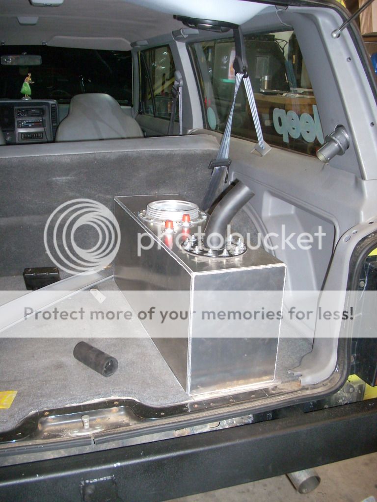

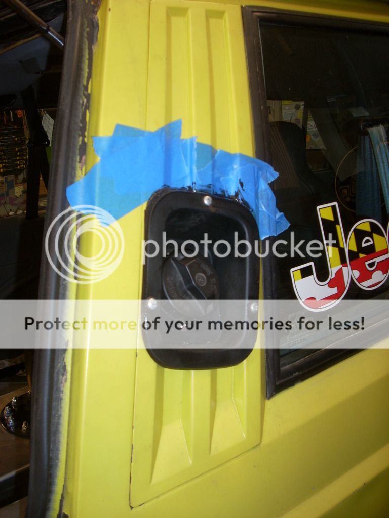

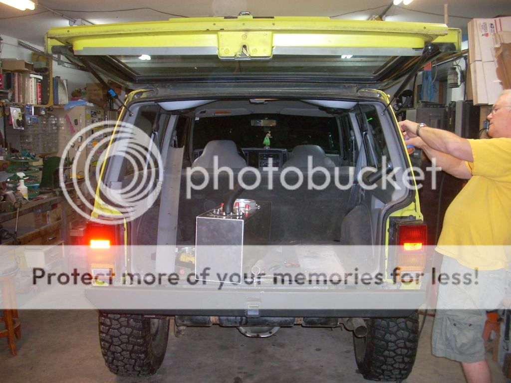

painted the bumper today and cut out a spot for the fuel filler and positioned the cell. I'm going to North Carolina for a week and when I get back I'll put the cell in and finally send the 8.8 to get re-geared.
