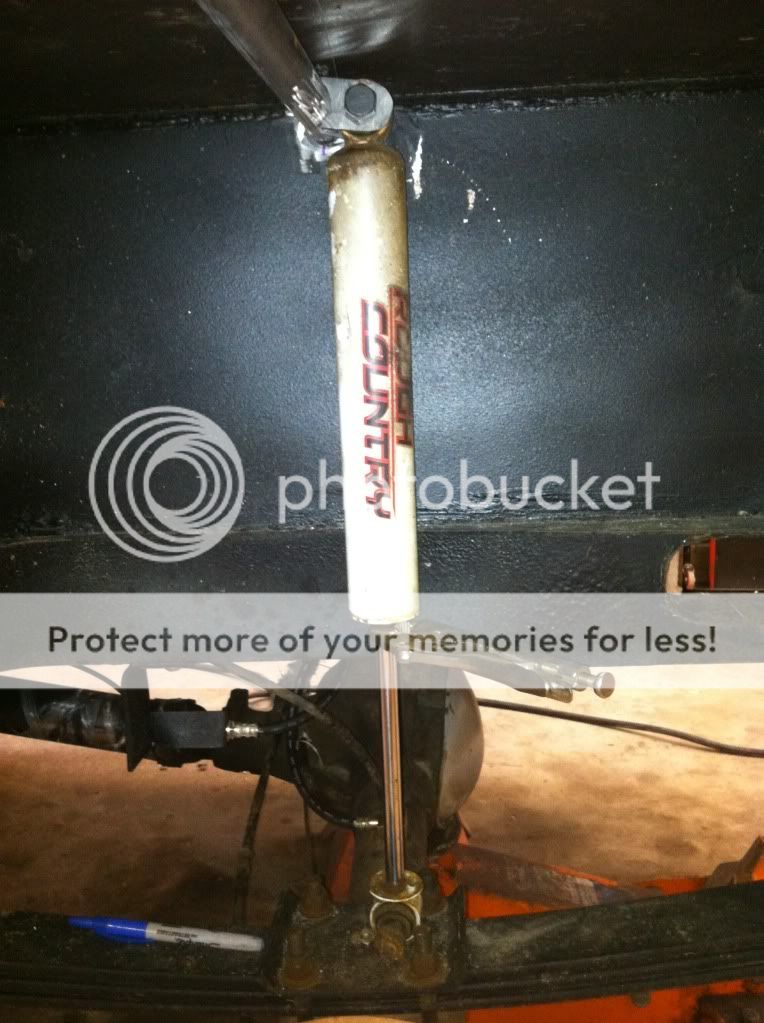

Took some measurements for shocks by flexing on some stuff around the house. Rear tire fully stuffed measured 19.5" and fully flexed was 29". For the front fully stuffed was 16" and flexed was 26". I need to take away an inch or so from the measurements because I haven't made the mounts yet. I figured out how I will do it in the rear just haven't bought some tube for it, going to use 1" tube for top mount. Probably going to pick some tube up tonight for it. Not going to do anything about the front shocks for a bit because I will probably make hoops for them just measured to see what it was.

Saturday I ordered some 5125's for the rear from Kolak who was a great help and If any of you need shocks I recommend sending him a pm. Hopefully shocks will be in soon, I made up mounts for them and all that they need is to be welded up. This is pretty much it minus the 5125's and lower mount .
