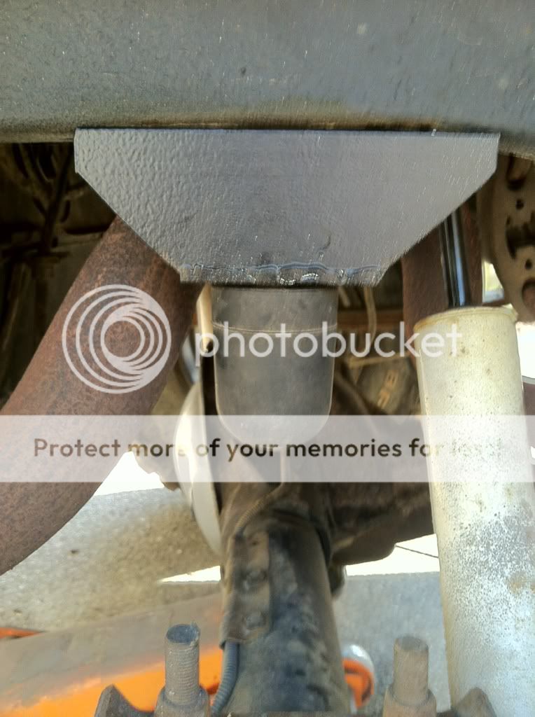

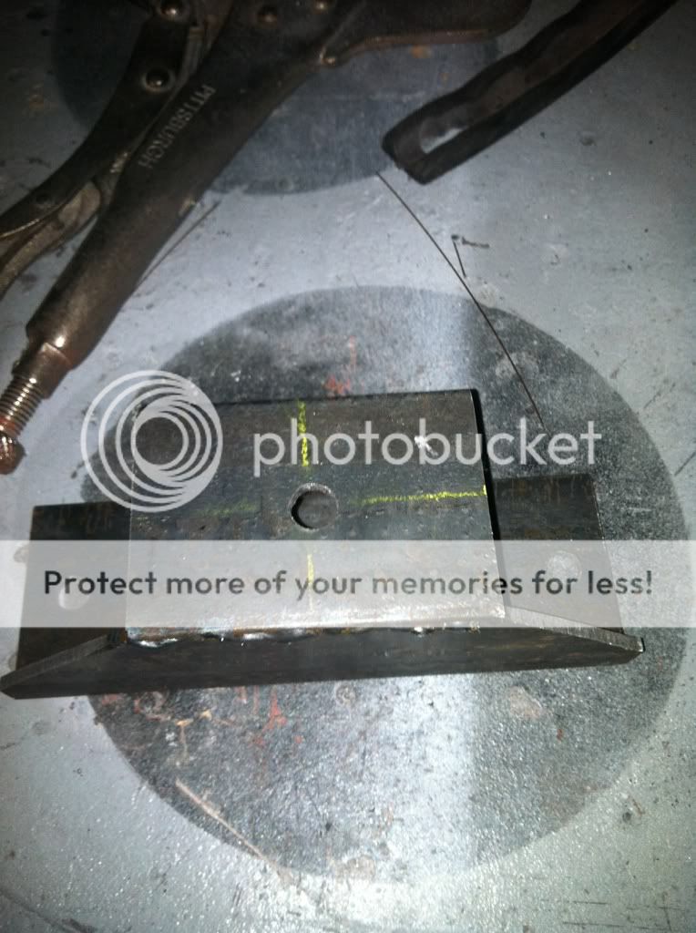

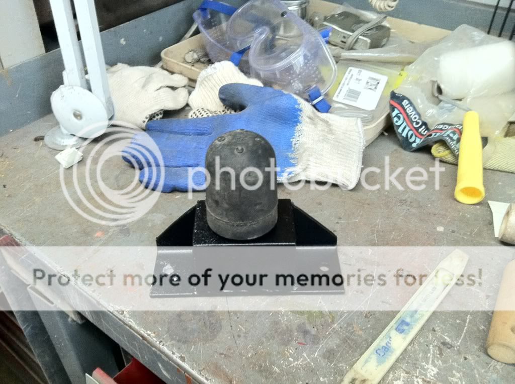

I built some rear bump stops not to long ago for a wheeling trip.
I cut some scrap angleiron we had laying around and welded them together to make about a 4" box. Then drilled a whole so I could bolt in some old bump stops and bolted the new bracket and bump stop right to the frame where the original ones where.

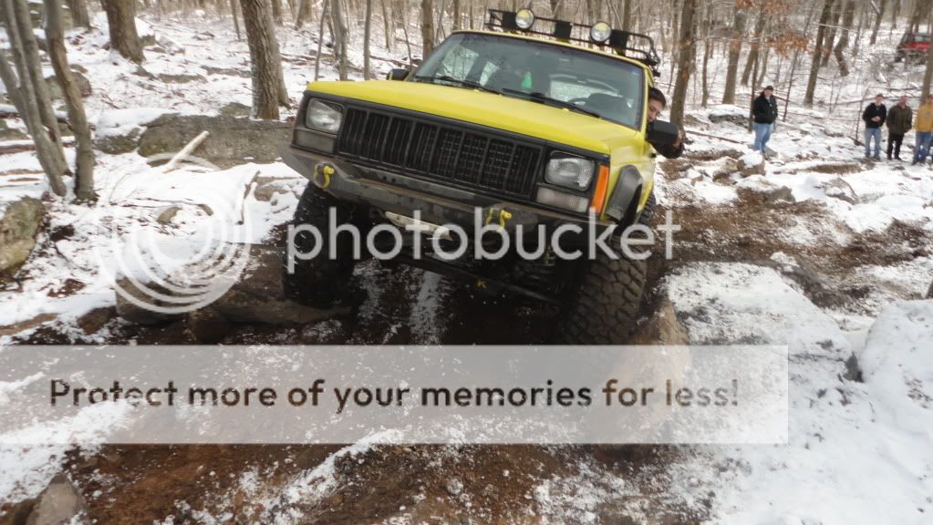

went to rausch again after the bump stops. I went with the usual guys but looked like the NAXJA crowed was their for I think the Uni body run. Trip was real fun, start snowing like a mother on the way and my girlfriend was driving talk about a terrifying experience!
swimming
Made it across the rock creek no problem then even played around on the smaller rocks as I waited from a group to go by and as soon as I get off the rocks I rub against a tree and my freaking roof rack gets ripped off! It tore up part of my gutter mount, I was pissed! Squazz made out of that pretty good went home with a sucro roof rack. It getting torn off was kind of nice since I didn't really want it anymore but my gutter mount didnt have to get torn up to. anyone have a good fix for a slightly torn up gutter mount?
