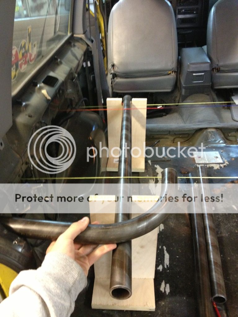

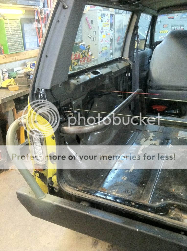

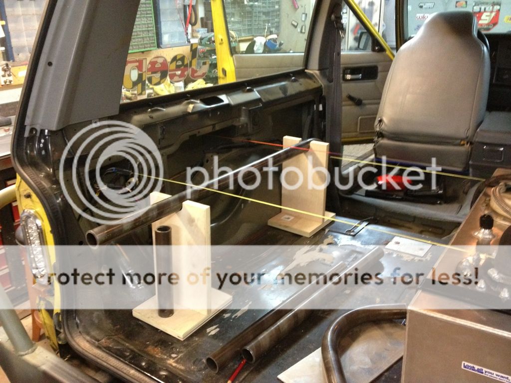

I'm welding tube to 1/4 plate at the floor which I'm regretting due to the thickness. Having a horrible time trying to weld the plate to the floor, burned through the floor on a couple spots and its just looks ugly. The plates will get bolted down so il just put a couple beads around the corners and sides and hopefully not burn through. I think Friday night I'm going to stay home and just practice welding all night.
Turn your voltage and wire speed down and then burn the 1/4" and wash the puddle into the sheet metal floor. You may also find that more gun angle (pointing the wire into the puddle and focusing the arc on the 1/4") will help prevent burn through on thin sheet. If you try to weld it like a normal joint between two same thickness pieces you will play hell trying not to make holes in the floor.

That's what I've been doing I lowered the voltage as low as I could get it and still burn through the 1/4 which and made the wire speed a little on the slow side so I could get it to puddle up and drag it to the tub which worked it just ain't pretty. Tomorrow I'm going to practice though and try different angles which I think will help its just hard to get a good angle when sitting in that small foot space in the back.
What I really need is to find me some welding classes over winter break.
