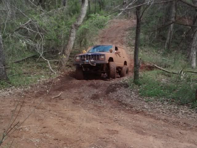

Posts: 1,335
Slowly getting more images from the shakedown run...
