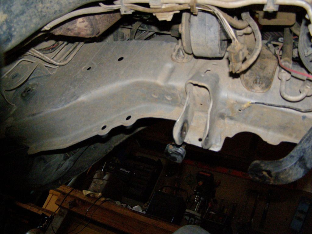

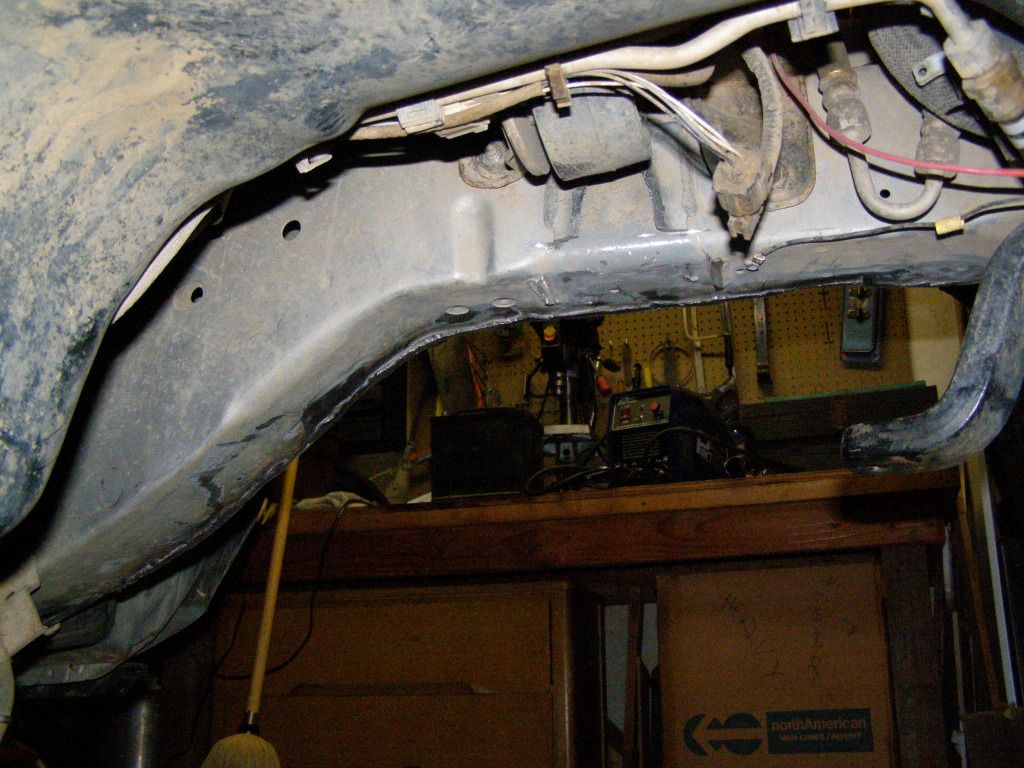

This week I shaved the front frame area to prep for plating the frame rails
This is how they looked before, notice the lip where they joined the sheet metal.
I cut it off, rewelded the frame and then smoothed it out.

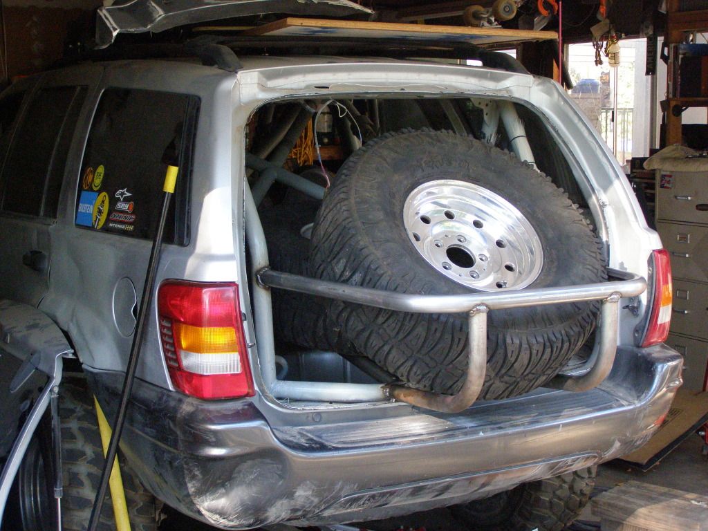

After months of staring at the jeep not making progress I had to do something I could finish in a weekend, so we made a rear bumper/ relocated how my spares mounted. Before they just stood up in the tub where the stock spare was located. This new position allows me to raise the fuel tank between the frame rails so gain better departure angle in rear.
Hopefully in the next week, Ill get the crossmember and beam mounts tacked in place so start getting the front end plated and caged.

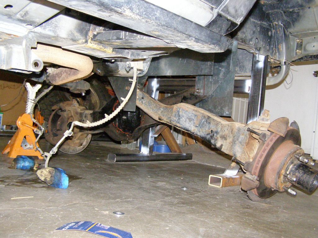

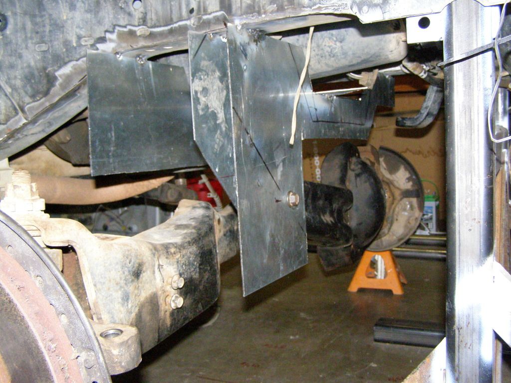

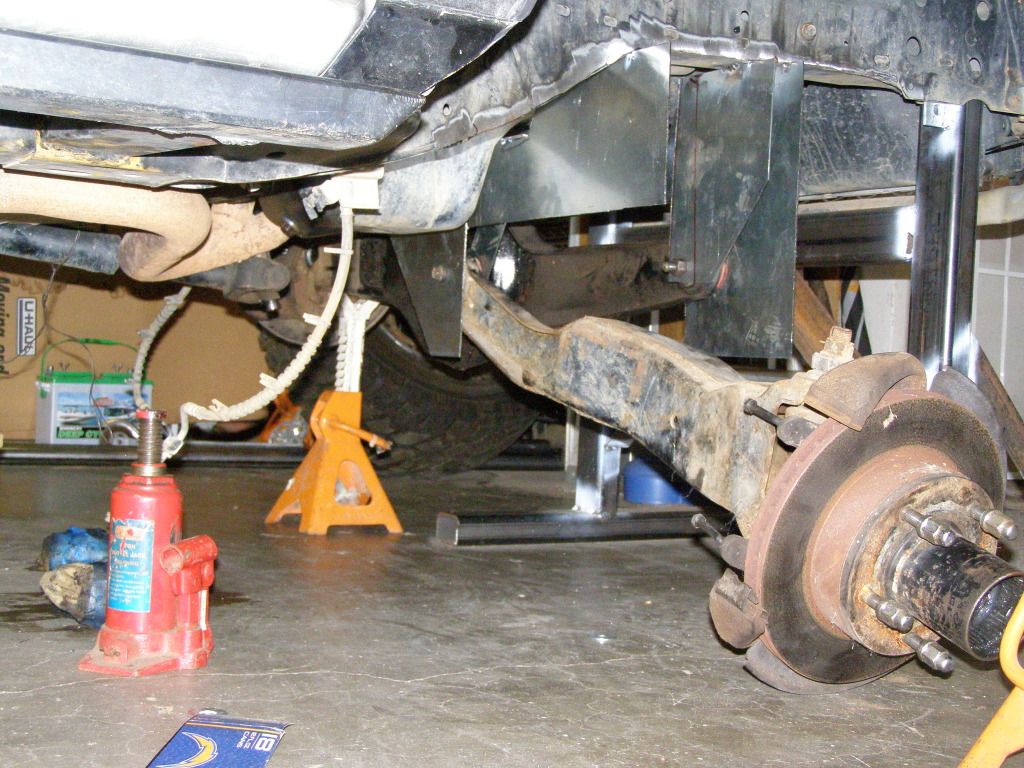

Got a random wednesday off. Took the time alone in the shop to get stuff done.
Made templates for the frame plates, then started to tackle the beam mounts.
After 6 hrs ive done it. I have TTB mocked up in a jeep and surprisingly there is a lot more room than I thought. My beams right now are completely stock, no cutting or extending, and it looks like im going to get decent travel and improved ground clearance over solid axle. Its a rough design for right now, but I didnt want to start building with 3/16 plate. The jig I made from the bronco worked perfectly the beams are centered under the jeep and everything works so far. I need to trim off what I dont need from these mounts and add in some pleaces. Then Ill make new mounts from thick plate, throw the axles and gears and get the radius arms going in the next week or so. If anyone knows where I can get a set of 14in coilovers for mock up that would be great.
