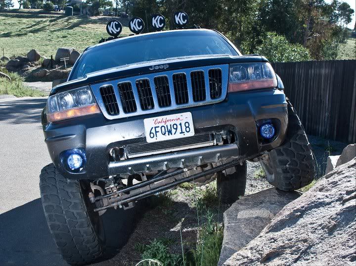

That is Our 2004 WJ the day we rolled it. Quick history, it was my brothers DD and gift for making Eagle Scout. He rolled it on some local trails due to having the front swaybar dissconnected. The vehicle was totaled by insurance and repurchased by my brother. We started building in October of 08. After getting the jeep running again. He had cage as well as the necessary safety equipment installed.
When he rolled it the lift was a Teraflex 4in long arm kit with with bilstein 5100 shocks. We ran that lift and shock combo for a season and in Oct of 09 installed fox 2.0 Twin tube bypasses in the rear. In Oct 2010 we added more tube work in the rear and 4in Fox bump stops
along with a hid light bar
We ran it like that for a long time untill I destroyed the front end in June 2012, (the story is below). I attached photos of after we gutted the jeep, Some early cage work and when we replaced the front clip and window

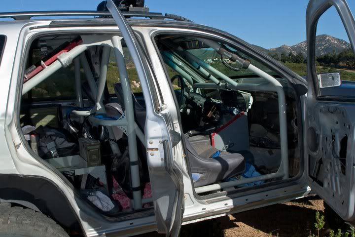

The interior has full cage with two race seats and 5 point harness. I added a 5 speaker stereo and CB. Race Radio, Custom Dash with GPS and Intercom are still to build.

That is one hell of a roll cage

2in .120 wall dom tubing. Its a race legal cage for the desert out here.

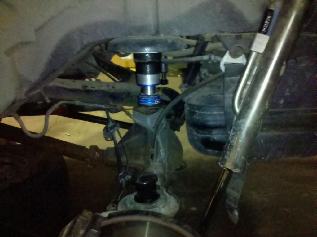

Rear Suspension and Bumps

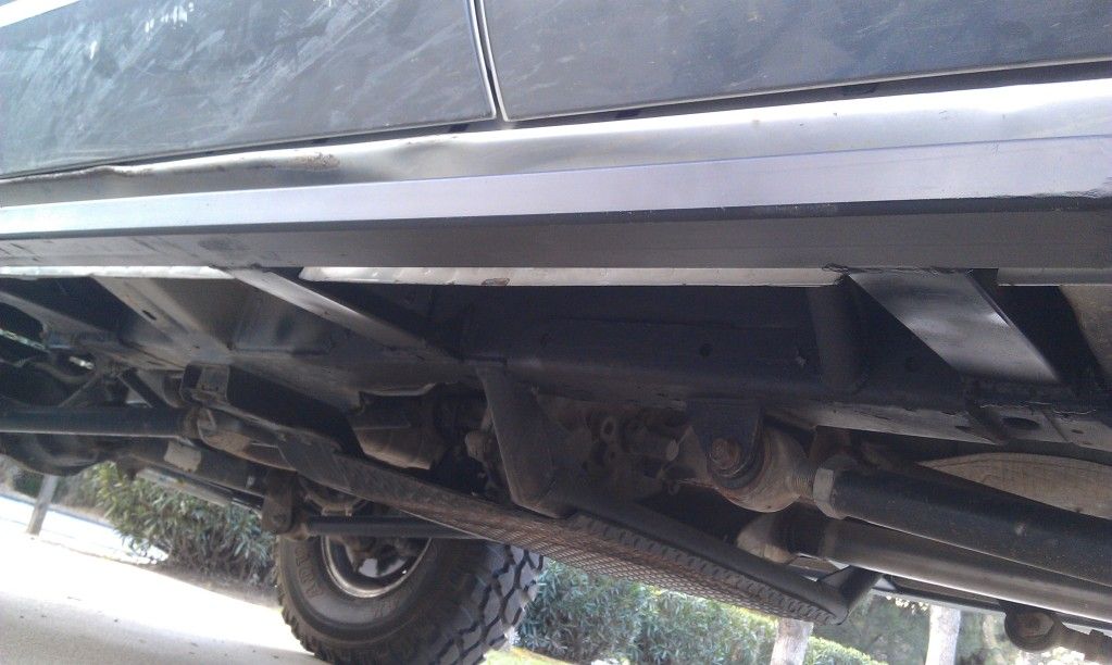

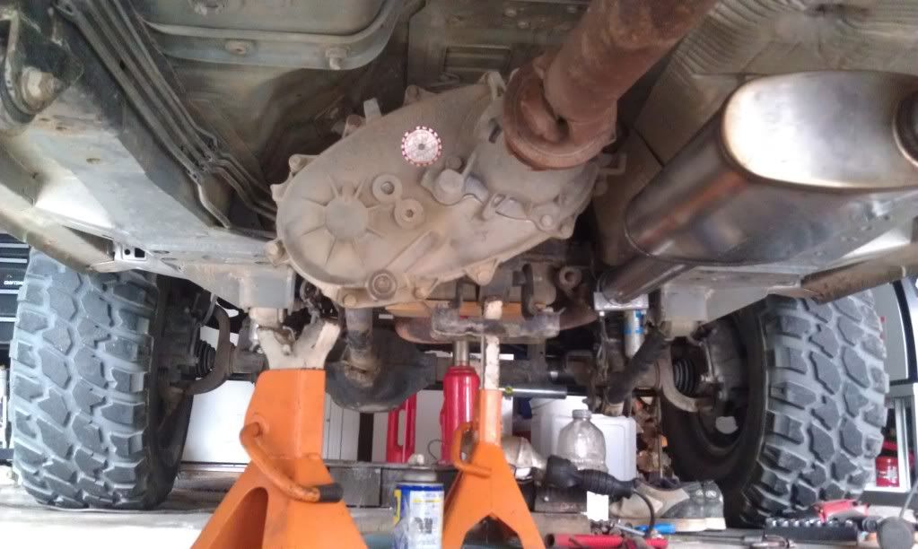

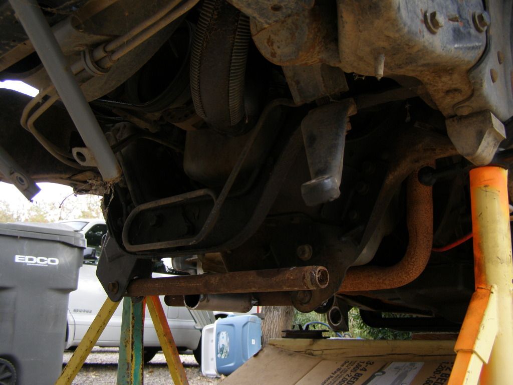

Underside Before Skid Plate

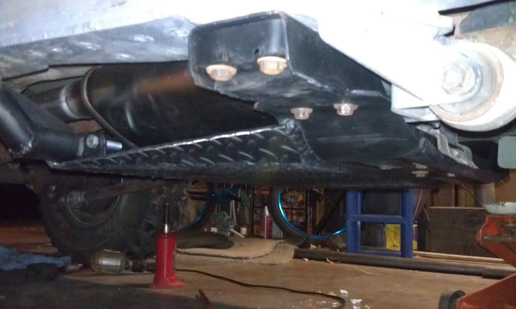

New Skid Plate

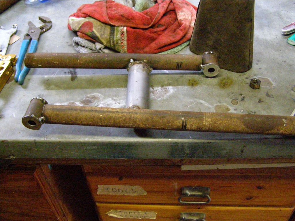

I'm starting from scratch and building radius arms.

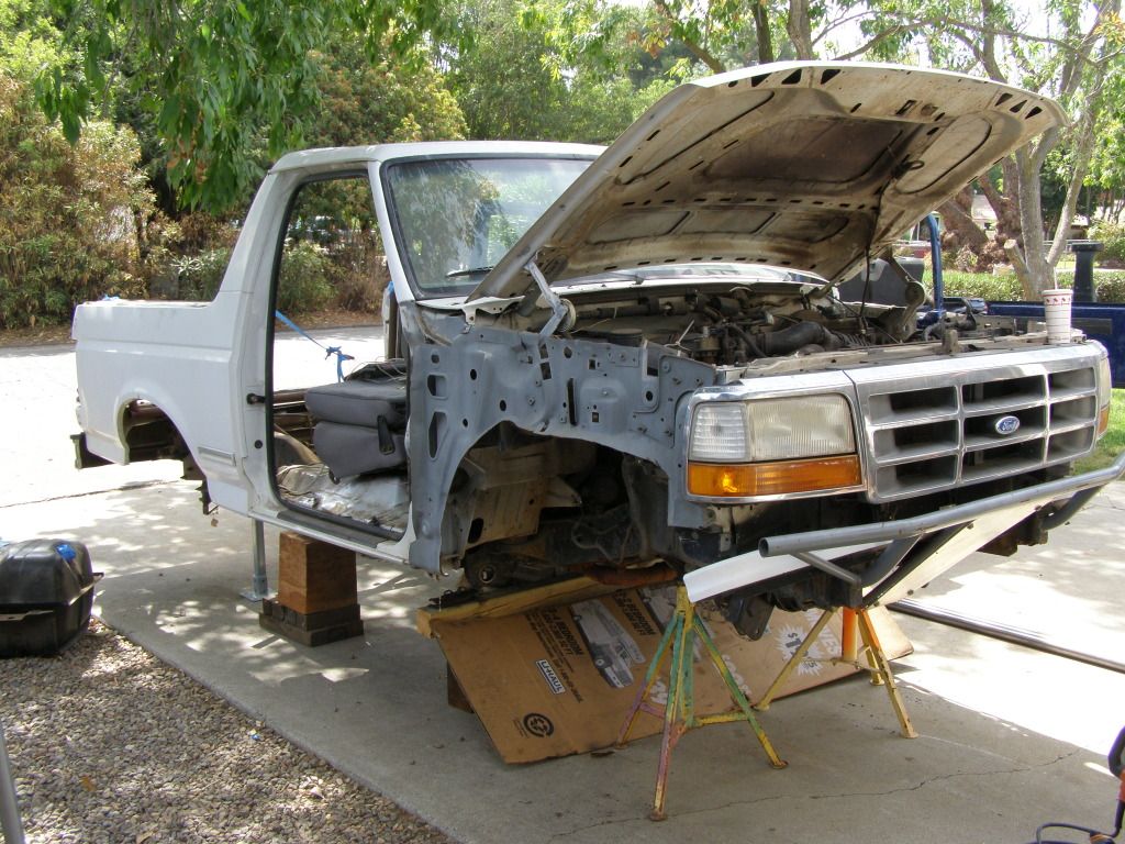

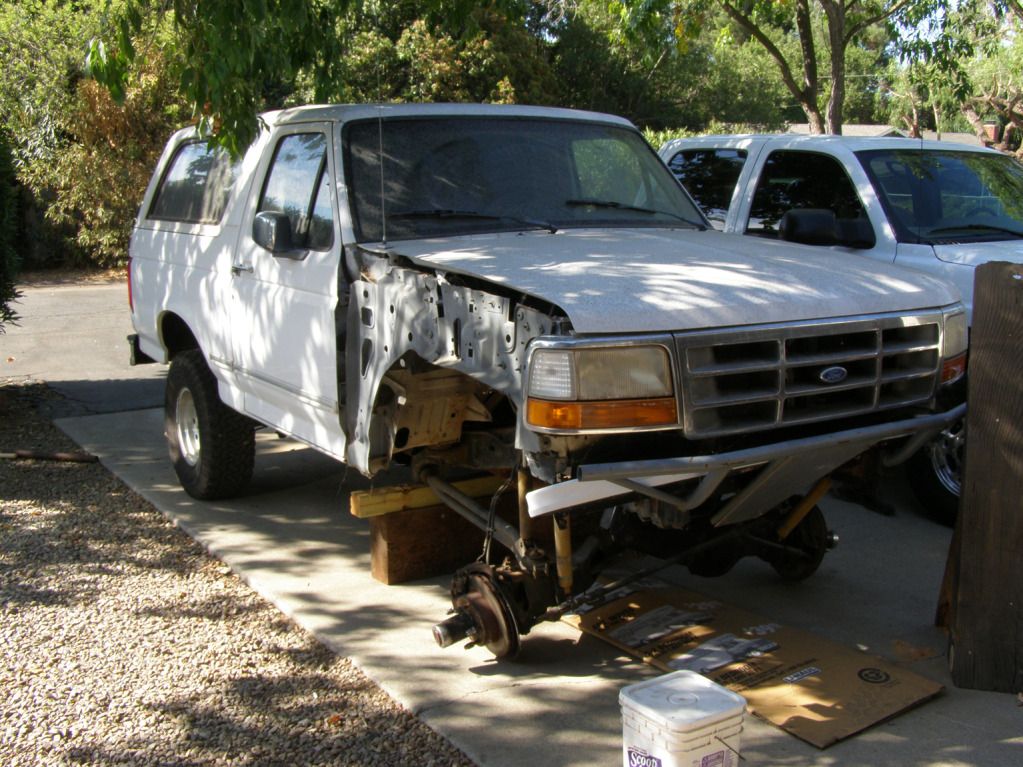

Picked a direction for axle swap. After much seaching for a front axle with no luck, decided to swap in a front end from a bronco. Picked up this bronco for cheap and began taking it apart.
Before disassembly
Whats left
It cost me 1000 dollars for the bronco and I was able to get two axles, fuel tank, wheels and radio antenna. Also been able to sell a lot of items. I currently are only down 200 from making all my money back on the bronco.

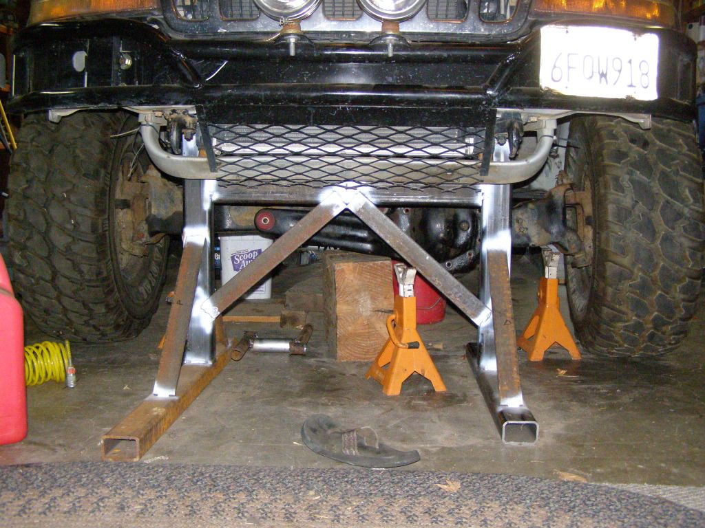

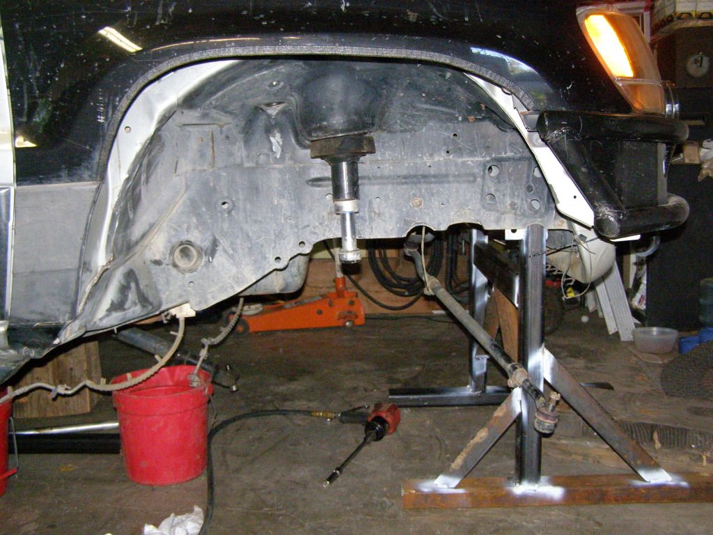

I built a jig to be able to use the ford geometry and mount locations under the jeep
My hope is now I have the spread and locations that ford designed to make the swap easier to do.
Another shot of the jig
Took apart the beams this week and had to get them at least sitting under the front of the Jeep. To see how it looks.
Next Ill start making a cross member to mount the beams and everything else.

post #10 of 148 Old 10-07-2012, 03:12 PM
mJUSTINm
Location: Redondo Beach
Posts: 2,277
Don't know much about beams. Why from a bronco? I understand why IFS is better than a solid axle for fast stuff, but why use a bronco setup?
-Justin
mJUSTINm is offline
post #11 of 148 Old 10-07-2012, 09:57 PM Thread Starter
WJDesertRacer
Location: Poway
Posts: 513
WJs are 63.5 inches wide. WMS to WMS. The bronco is 65" So I can gain a little width. Also the axle is a HP dana 44 center section. Ill get the strength of a dana 44 with 15 inches of travel.
