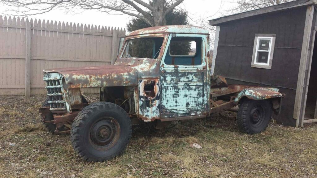

What I'm working with is a 89 Econoline it's got a Dana 70 rear axle with a 460. It only had 34k miles on it (look at how clean that chassis is) and I picked it up from a junk yard right down the street from me. A couple weeks prior to that I bought the 52 Willys. I uploaded pictures backwards of how the progress has been coming. I owe a huge thanks to my buddy Curtis (in the Econoline at the junk yard giving a thumbs up). We've been all over hell the past couple weeks gathering parts for th is build. Post 1-16 has been progress I have made on the project over the past 6 months or so

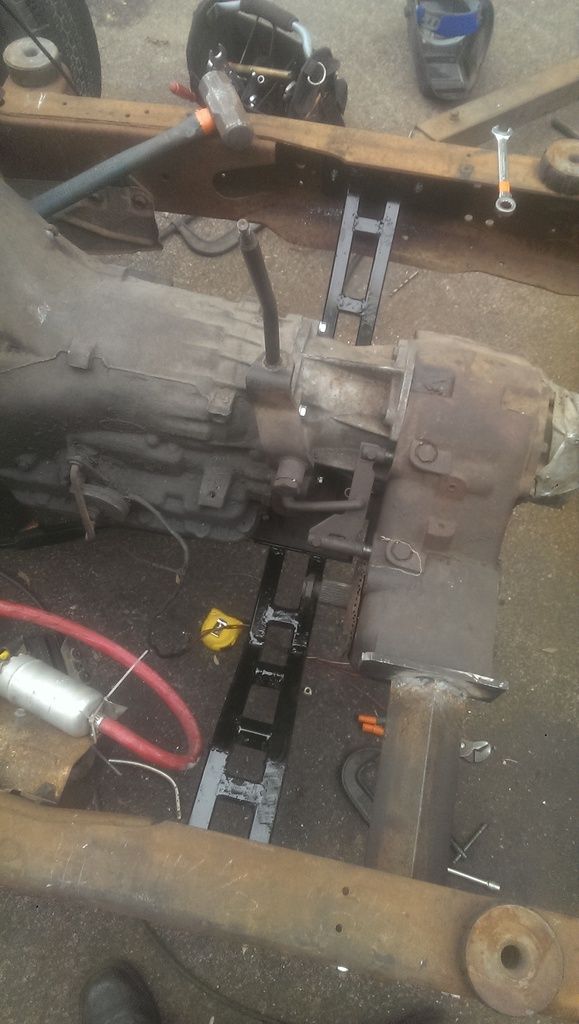

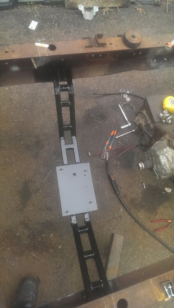

I started fabbing my transmission bracket yesterday and finished it up today.
I plan on pulling the cab off if I need to get at the trans or transfer case when it's done. Don't mind the solid POS transfer case mount, that's not going to stay that way. I just tossed whatever bolts I had laying around in everything to hold it together for now. I'll get the right sizes and grade 8s later.

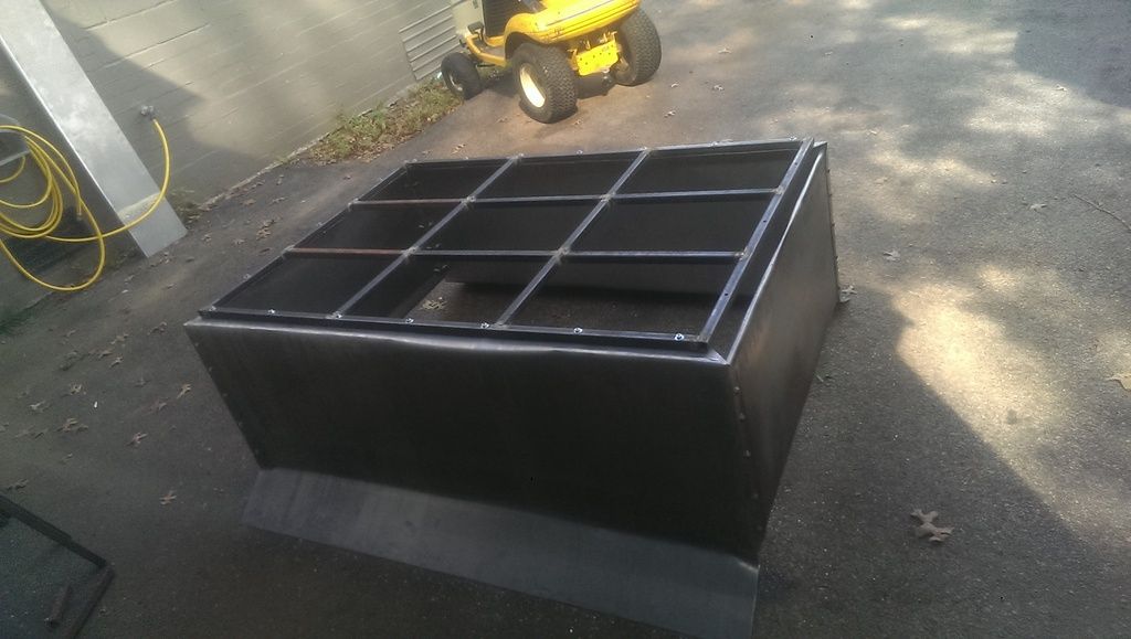

The bed is far from done but it's a good idea of what I'm doing and you're all up to date.
I tried as good as I cared to to match the patina in 2 minutes. I don't think it looks too bad considering I have no time into it. There is still no floor. I'm going to work on some sort of bracket to set the bed on tomorrow. Right now it's just resting on the chassis.
If I had to guess so the portion of the bed that I did make weighs a whole 12 pounds or so.

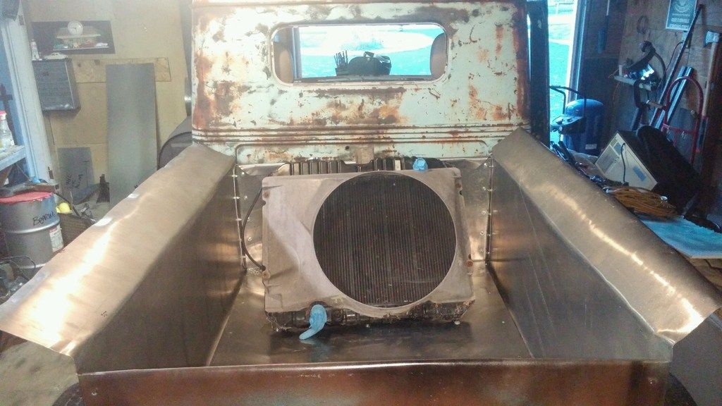

I got the bracket all made up for the bed yesterday and bolted to it. I have to make mounts to the chassis and bed still to put them together. I also tried to roll the edges of the bed, that was an epic fail. I'll have to come up with a way to do that when I get a chance.
My wife and I got the floor installed and mostly bolted in last night. I'll get the rest of the bolts today. The bed is still not fastened to the chassis yet, I have to make mounts still. I set the radiator in place just to eye ball how I might wanti t to sit.
