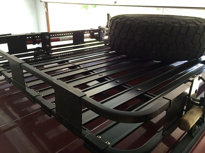

I bought five tires rather than just four as I'm a big fan of rotating the full-size spare into the mix and not having to worry about tires being different sizes if I get a flat. But, that means the stock spare comes out of the cargo area and instead of putting a big ol' tire back there, I opted for a Surco rack and mounted my hi-lift jack, axe, and shovel as well. I need all the cargo room I can get for my gear (and sometimes others' as well).

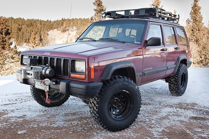

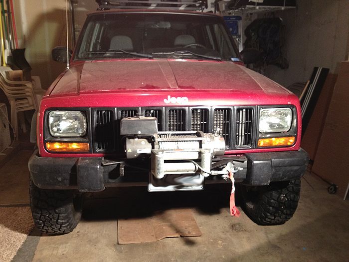

Before selling the TJ, I pulled my winch off it so I could use it on the XJ. Here's another time where I vacillated for awhile as I couldn't decided between a winch bumper from JCR or the backbone from Detours. After much consideration for both, I opted to go with the more budget-friendly backbone and keep the stock bumper. I actually like the stock look of the bumper and endcaps, too, so that's a win-win!
Getting the backbone installed was a breeze as the holes all lined up perfectly.
It was getting the bumper skin cut to fit where I had a bit of trouble as I don't do this sort of thing for a living. It did fit in the end after taking it off to make adjustments about 13 times. I also took the opportunity to take off the bottom plastic piece of the bumper and cut the end caps to match. Gives it a cleaner look and a better approach angle.
And now for the obligatory profile picture:
He's coming along quite nicely, I think.

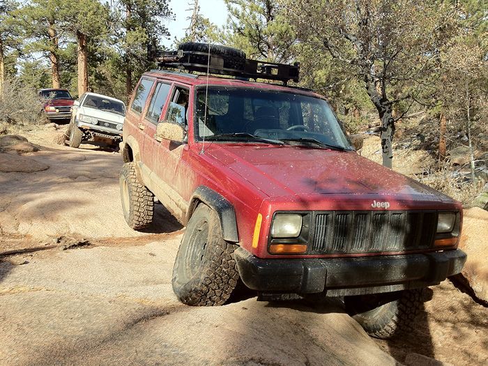

If you look at the profile picture after I had the 31s put on, you will see that the tires (specifically rears) won't fit in the wheel well without rubbing. I encountered this quite a bit on this wheeling trip and here's a shot of the front (at one point my flare even popped off):
With more vacillating (apparently I'm quite indecisive!) between going back to smaller tires, different backspacing, or fender trimming (which I was opposed to from the beginning), I decided to get some of these to put on:

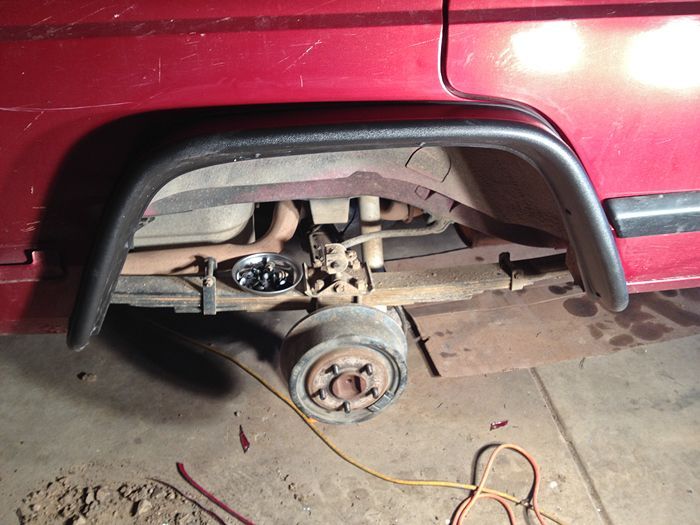

The last thing I did before Christmas was my Bushwacker install. The install was pretty easy except very time-consuming. After getting the stock flares and brackets off, I taped the fender up for cutting:
After that, cut and fold, and then primer (and eventually paint):
Install the inner flare for mounting:
And then attach the outer flare:
And now fully installed:
And the side profile for comparison from the original:
