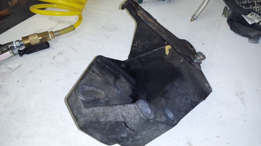

The previous owner did some very bad things to this jeep…
3” Warrior Lift
3” Body Lift
Some weird aftermarket gas tank
Horrible hot air cold air intake
Sub par bolts holding motor mount to block
Vacuum lines all kinds of crazy.

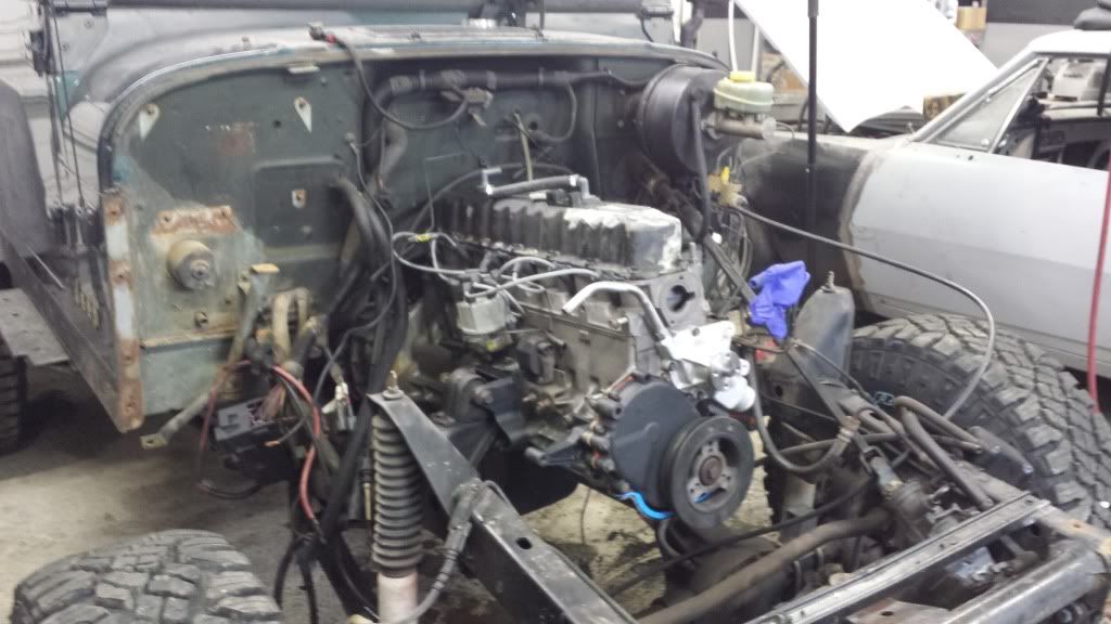

So, after the motor mount issue it was decided that since I have to pull the motor to extract the bolts, I might as well move up the schedule and just dive into the build early
The end of day 1-front fenders/grill pulled. Motor/trans/transfer case pulled and set on the ground
After getting the new (rebuilt) motor and trans from Collins Bros, I decided that I couldn’t just through all the old brackets on looking the way they did, so I got a cheap blast cabinet from Harbor Freight:
I was pretty impressed with the results actually. It leaks media everywhere, but that can be fixed later…
Before:
After:
And a nice coat of high temp flat black to finish it off:
Engine work:
Out with the old..
In with the new…
Engine Bay cleanup!
Massive oil leaks from just about everywhere on the trans…motor was bleeding quite a bit as well..
I think that covers a few days of work…

I'm not sure how we got the motor out, with my cherry picker's short reach, but putting it back in was a definite challenge. I rigged up straps and pulleys underneath the rear axle to the trans output and would lower a little, tug a little, lower a little, tug a little and finally...it rested into place:
*The valve cover is merely a placeholder for now. Not sure if I want to paint it or get an aftermarket one..

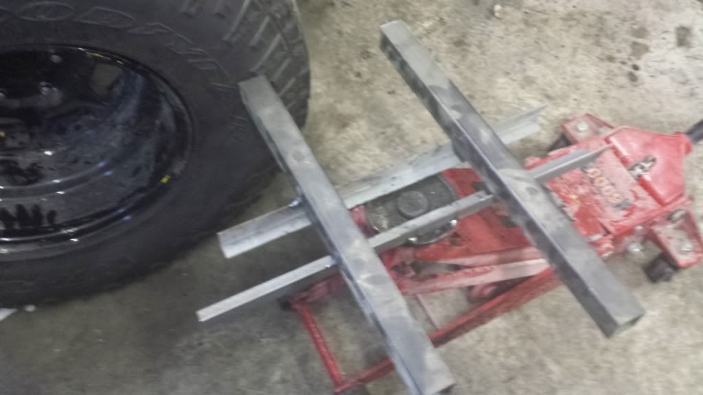

And as luck would have it I filled up the tank on my way home (when the motor mount bolts broke) So I had to find a way to safely lower the tank to empty it
welded a bit of scrap to my floor jack and called it good.
OOPS, wrong tank???
