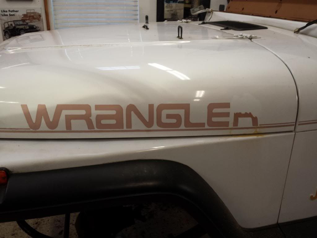

My wife wants a set of the "new" islander stickers for the hood too. I think I created a monster when I said "tell me what you want"...

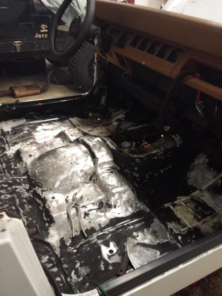

Made some more progress....
Used one of the eraser wheels for the first time, and I am very pleased with the results.
I also have 1/2 the frame prep done for Chassis Saver.
I started prepping the Old liner for installation of Monstaliner.

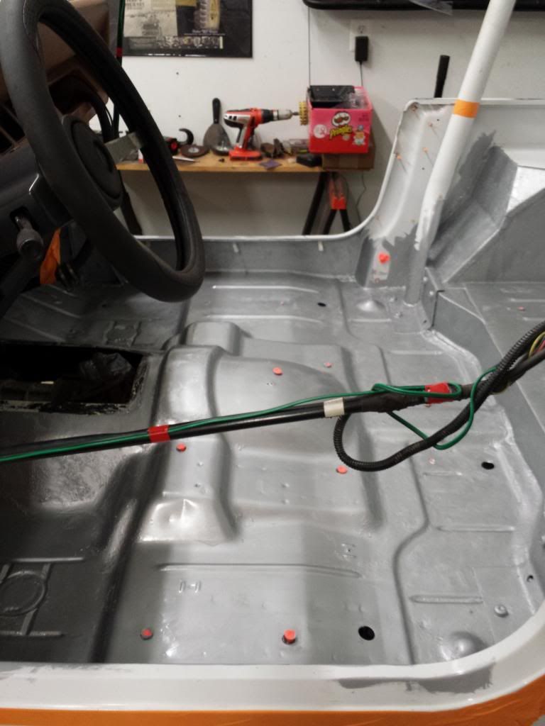

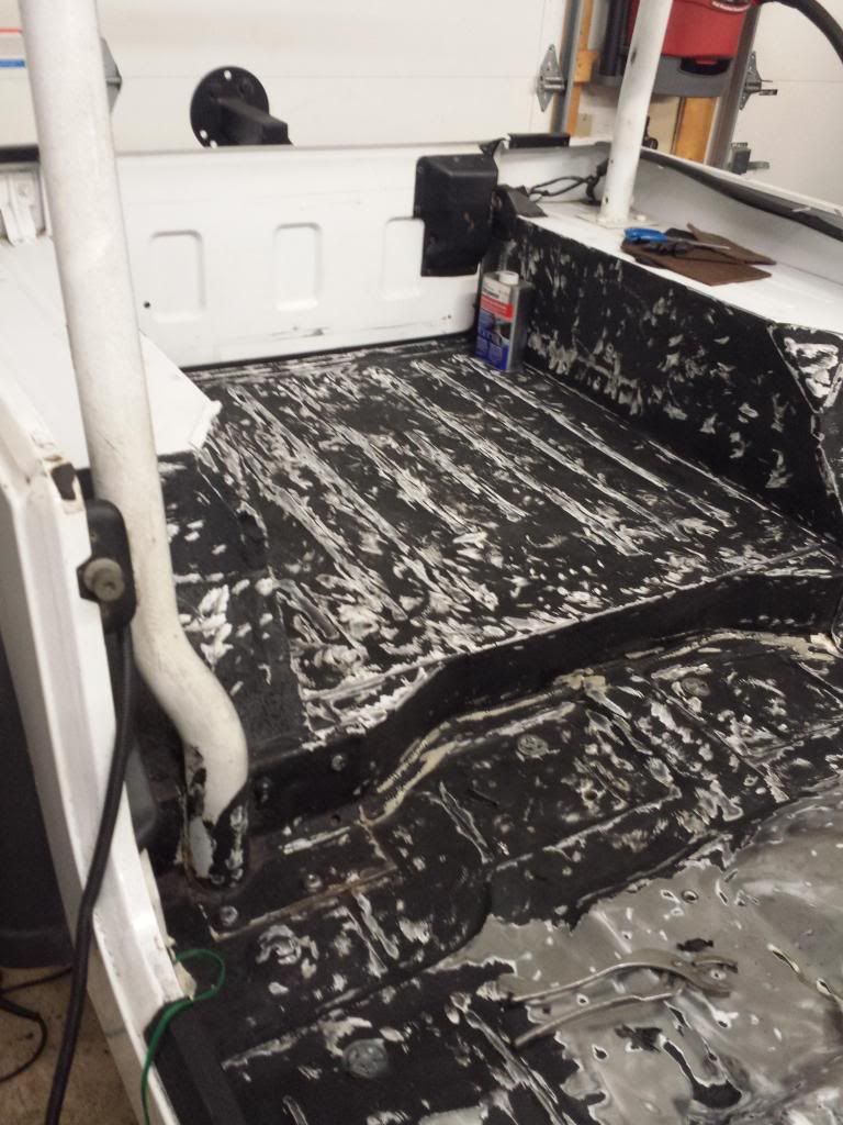

almost done prepping the interior; Herculiner is b!tch to remove. I have it mostly removed and at least smoothed out where it is firmly attached. I did find some rust I need to address hiding under the liner.

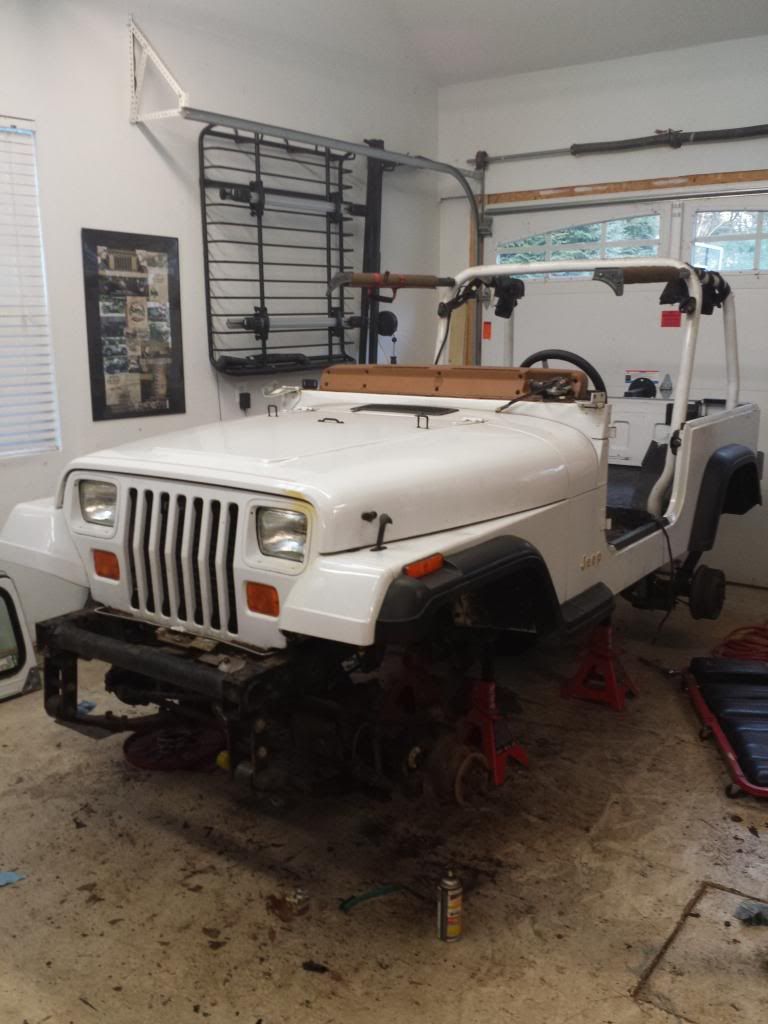

Had to address some front axle u joint issues so no lining done yet.

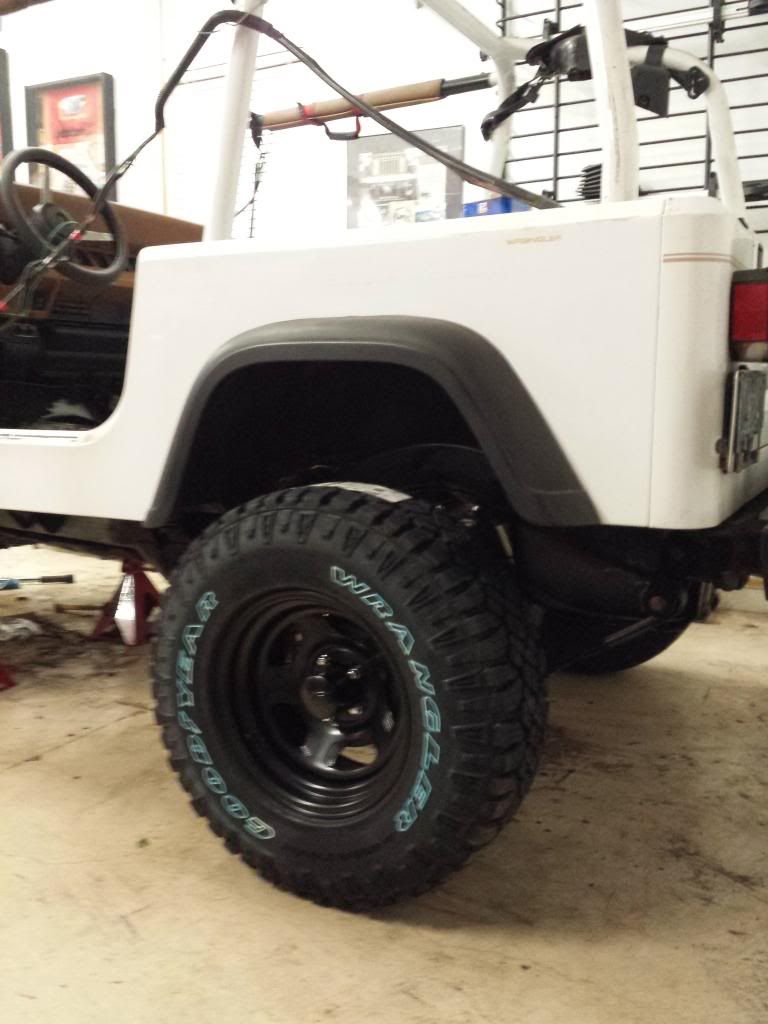

For grins I put the rear tires on. I know the 31s look small, but it is what she wants...

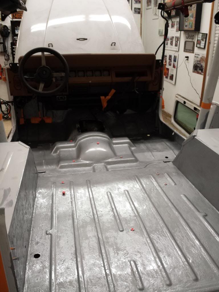

I got up a "O Dark thirty" today to start laying down my Monstaliner....
I had the heaters running all night to get the garage nice and warm (I shut them off to avoid death by explosion)
Nice and warm at the start..
Silver Chassis Saver primer is down; waiting for it to dry enough to start my first coat of White Monstaliner.

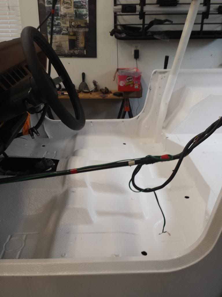

First coat is down...
Temps still falling, but good enough...
jeep63 is offline

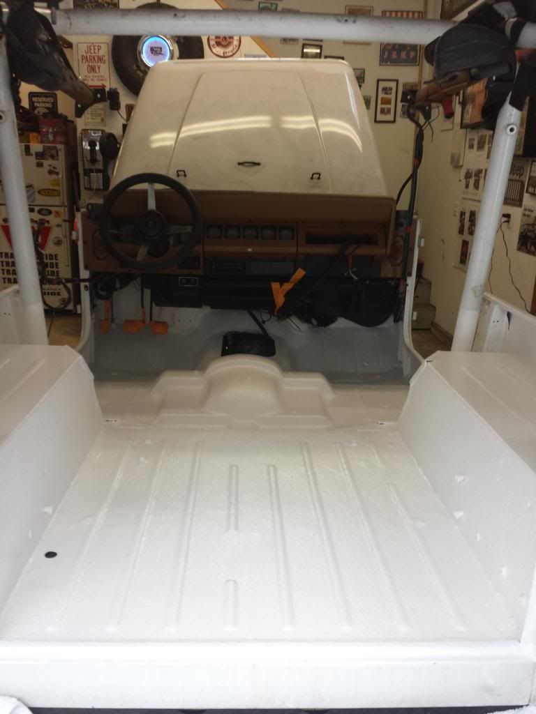

12 hours later and I'm done...
I am surprised how quickly it dried between coats. The humidity is pretty high in my garage from the kerosene heaters (they were turned off, but over night they upped the humidity a good bit).
I think that contributed to the cure times. I was leaving about 4 hours between coats and it was just barely tacky.
Now I can start putting the interior back together and get ready for the Softopper I ordered.
