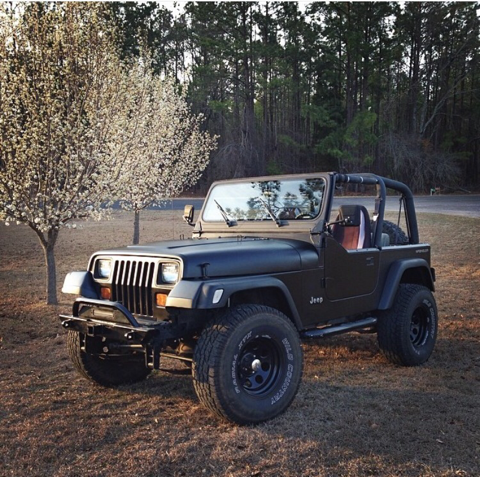

Spent about 4hrs today and got the OME springs installed. Everything went well with no unexpected issues. This was to replace the 2.5" CJ springs (skyjacker) that the jeep came with. The jeep has always had a jarring ride.
I figured it was a mix of the springs and shocks (rs5000s in front and some cheap rough countrys in the rear). After swapping to these new springs I can safely say it was all the springs. After installing the fronts I ran around the block and the difference was night and day. The jeep rides smoother than my brother in law's stock 05 LJ Rubicon. For anyone wondering, believe the hype about OME.
Here's a couple pics after the install, and the take off junk. Going to give the springs away if a local wants them. I wouldn't feel right selling them. They were that bad.
