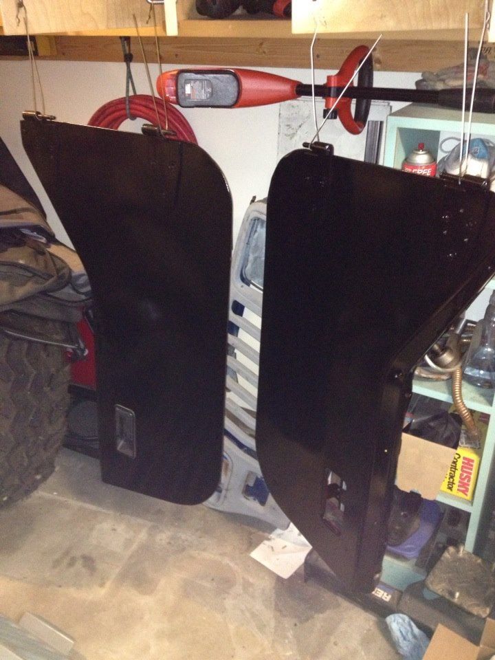

Got the doors painted. Used some Krylon rust tough gloss black. They don't look great, but in that respect they match the current paint job on the Jeep pretty well.
No pics on the Jeep yet. I got them put back together and installed, but it started raining again this afternoon so I had to cover it up. My wife needs to clean the upper 1/2 doors and then we can install the soft top.

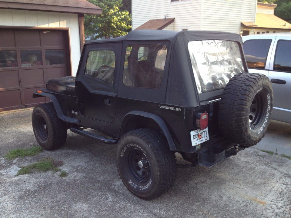

I realized yesterday that I never got a pic with the soft top installed. The old top is still looking pretty good IMO. I've had this top longer than I've known my wife (~12 years now). The only part I was worried about was the tub rail for the driver's side since I smashed it up pretty good a few years ago at Harlan. Thankfully I was able to bolt it down, then some slight tweaking with pliers and it all works fine.

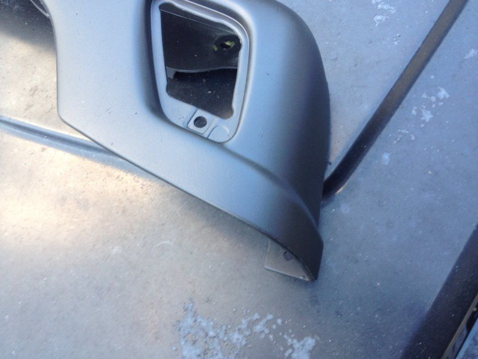

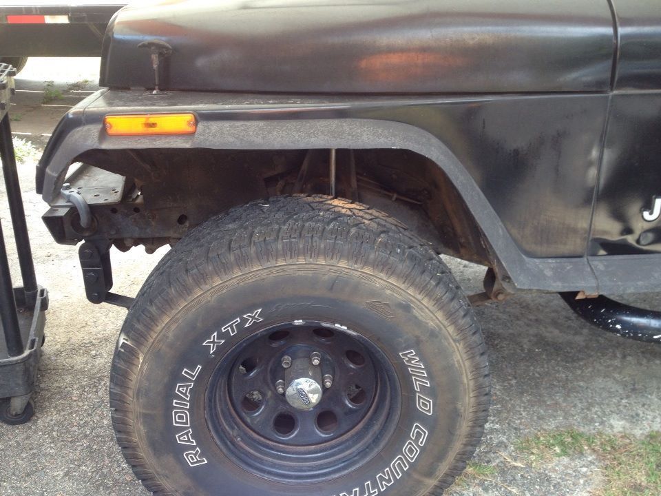

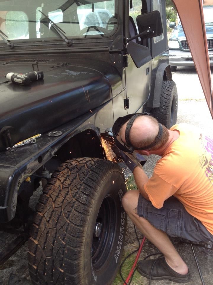

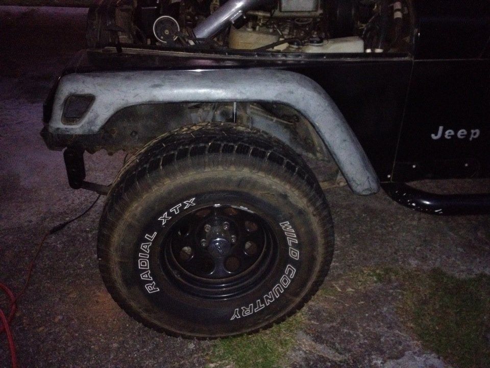

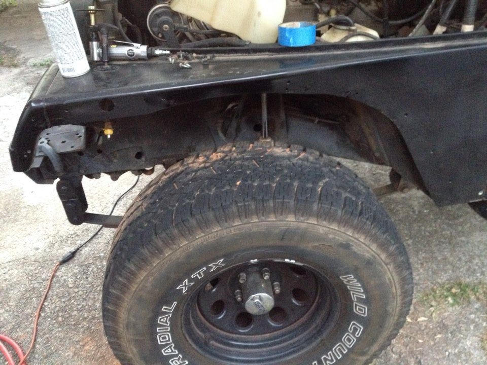

And here we are. Finally working on replacing the chopped up crappy looking fender flares. I started this yesterday and I'm almost finished with the front. I don't recall it taking this long on my Jeep a few years ago, but I'm probably being a little more careful cutting on my wife's Jeep than I was on mine. I also opted to trim part of the fender (the back for extra tire clearance), but across the top I trimmed the lip off the flare where it interfered. The end result is basically the same and this was easier to match up side to side IMO.
Here's another reminder of where we started.
So I removed the flare and did some of this.
then drilled a few holes to end up with this.
Then after a few test fits I got here. This was after I had trimmed about an inch from the front edge of the flare to line up with the fender.
I paid $25 for the complete set of flares, thus the condition. Even in their scratched up and extremely faded condition they were a huge step up from what was there before. They also came with clear marker lights (not pictured) which I don't care for but they will do for now. Since I was wanting to make it look as nice as possible, I picked up a can of plasti-dip to try out and it seems to have worked very well.
I had to let those dry for 4hrs so no finished pics tonight, but it should look great. I'll probably start on the rears next weekend.

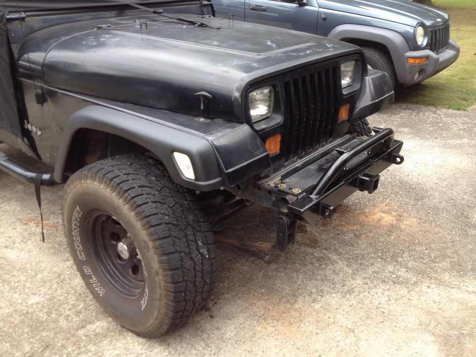

Got the front fenders mounted. They came out nice looking. Still haven't worked on the rears, but I did get my old bumper cleaned up and installed on the wife's Jeep this weekend.

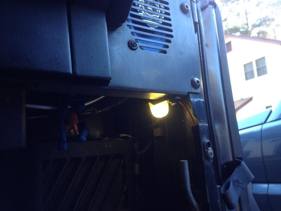

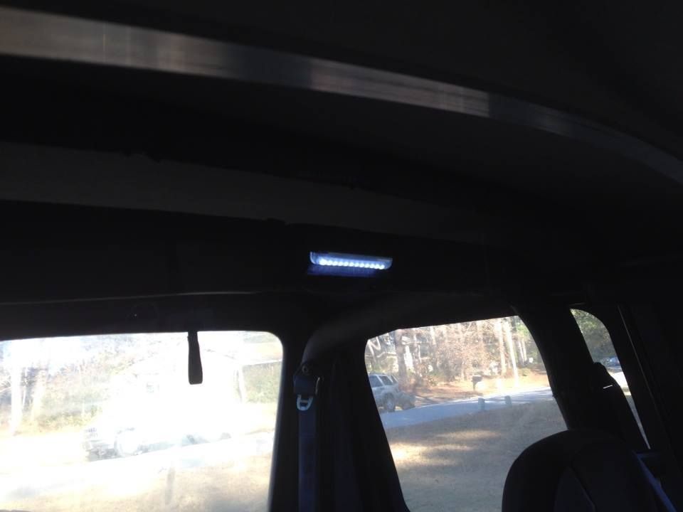

Did some more work on the Jeep this weekend. My wife being a newer YJ owner is still used to all these fancy modern day amenities, like interior lights, and she felt her Jeep was lacking in this area. I had bought and installed a Rampage dome light a few months ago, and it basically sucked. It was better than nothing, but just barely.
So fast forward to last week. I picked up a small LED license tag light from the local parts store to install in place of the battery powered light we had in there. I've been running this same light under the dash in my Jeep for years so I knew what to expect from this one.

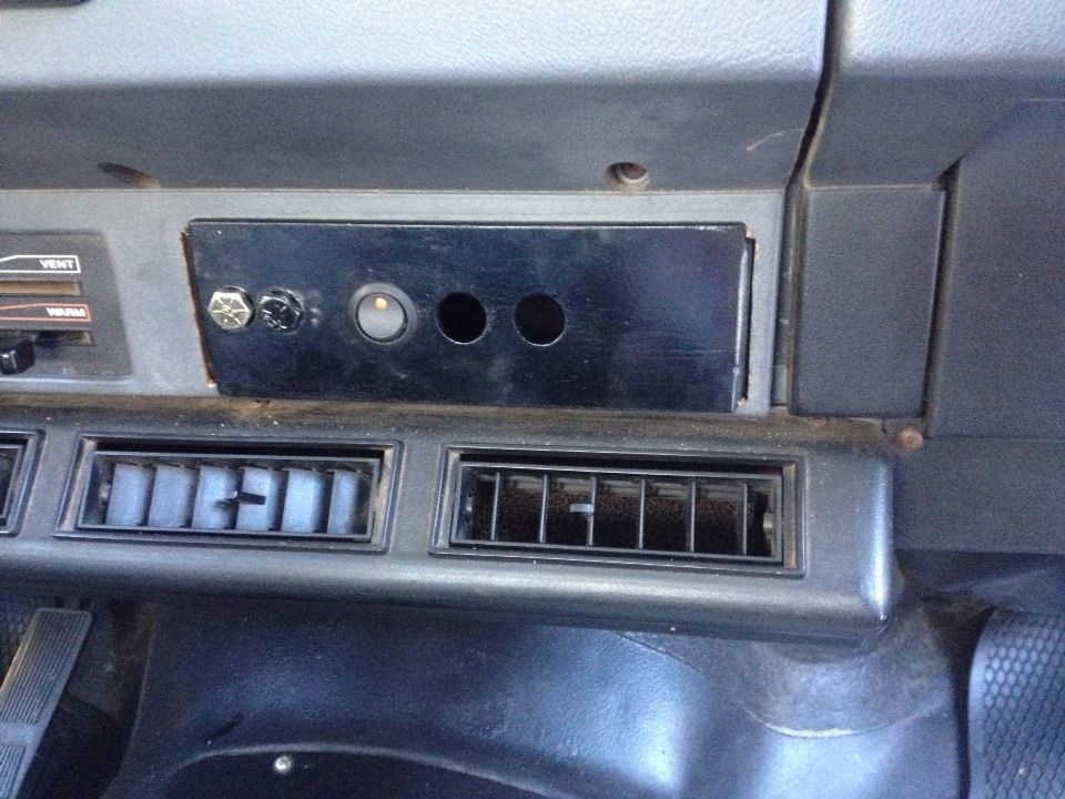

While I was at it, I decided to install the switch for the new lights in the spot where the factory radio went, which has been an open hole in the dash ever since we moved her radio to the console. This meant I finally had to build something to cover that hole. This is what I came up with to fill it. If she didn't have AC it would have been much easier, but I had to install and secure the plate all from the front w/ no access to the back of the plate.
The plate was a shim for a spring perch and already had the 3 holes. I can use the others in the future if we install other accessories.
So that side tracked me for Saturday. I also found some original interior floor lighting was in her Jeep (which didn't work), so I removed those and modded them to hold some old single round LEDs I had laying around. I wired all 3 lights to the switch I installed in the dash plate. It lights up the Jeep very well, and most importantly my wife approves.
Here's the dash plate installed.
Here is the modified original light that was under the dash on each side.
and the tag light mounted. It actually fit perfectly in the strap that came with the Rampage light.
