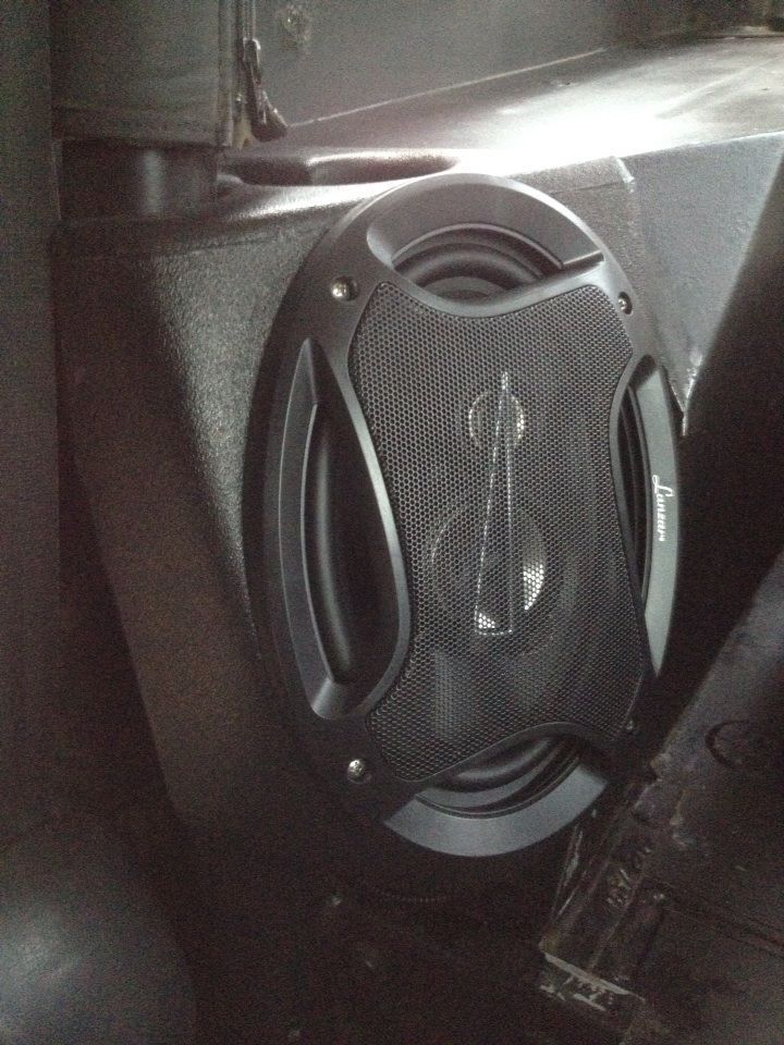

The Jeep came with a pair of the 6x9 boxes that mount around the base of the roll bar. For wiring I'm planning to use some wire loom and run it to the sides where there are existing tabs to hold some of the OE wiring. All that should be really visible when the seats are folded forward is 1 length of wire loom behind each seat frame running to the sides. From there it will be tucked under the door sill, at least that is the plan.

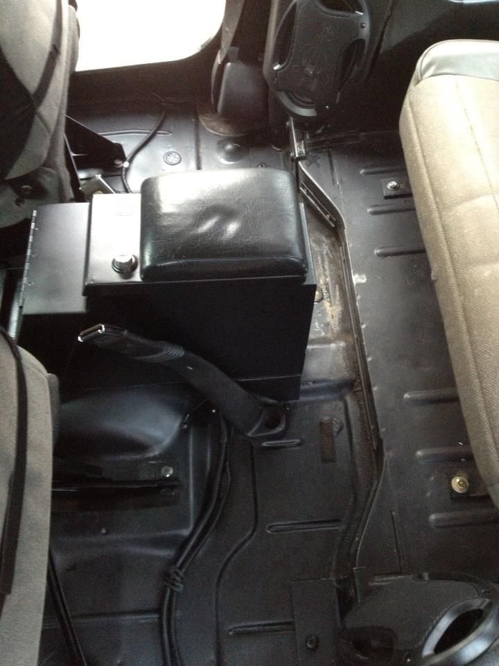

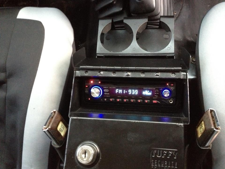

I finally got the stereo installed today. About 2 weeks ago I pulled the CD player out and found the hacked up harness. Today my buddy installed the stereo in the Tuffy console and wired in a new harness for me. All solder connections and new wire. Nothing hack about it.
I really wish I took before pics of the radio install when we got the Jeep to compare with now. Just imagine ~50' of various types of wire running all around the floor boards behind the seats. Here is how it looks today.
My wife told me not too, but I ordered her some speakers for the back anyways.

Everything looks great. I really like the console and the radio in it. Clean looking install. I have a similar console, made by Smittybuilt I believe... I will eventually get my stereo in there and it all wired up. For now the el cheapo radio is just in the dash. Havent even put the console in yet but these photos make me want to. Good looking jeep.

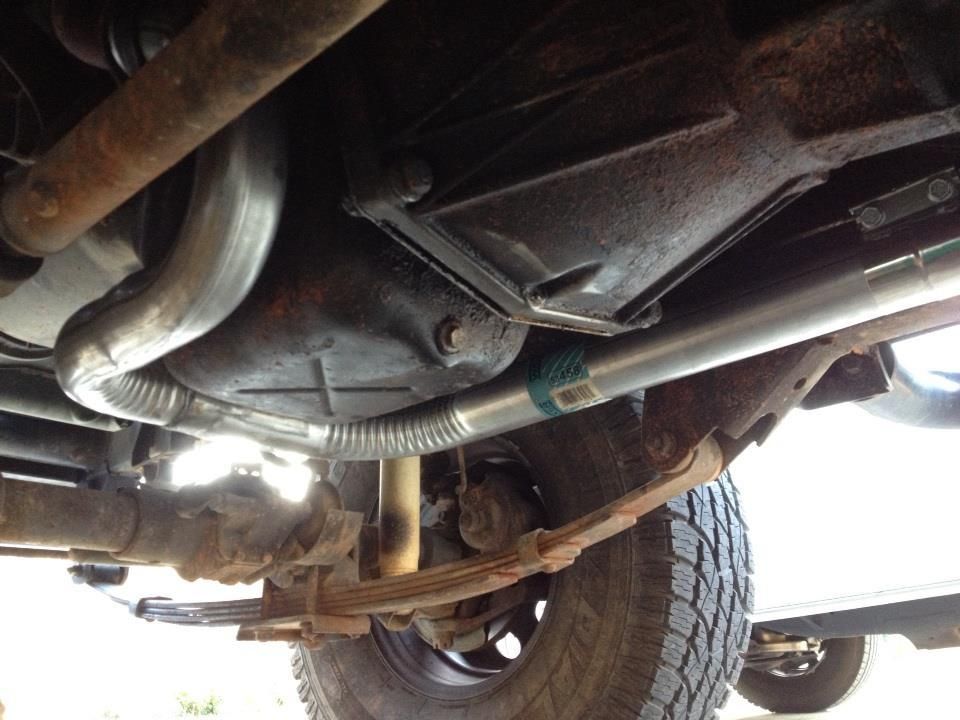

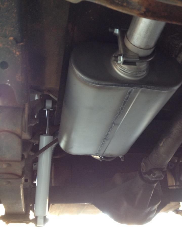

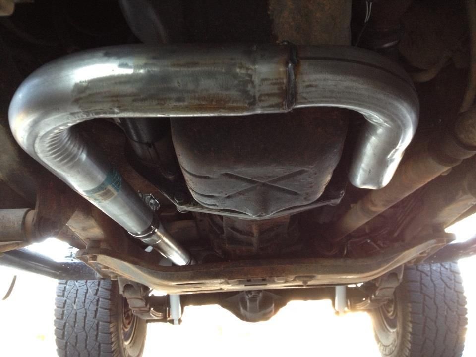

I replaced the exhaust today. It went pretty smoothly and everything bolted up without a hitch. Like I posted above, I installed a TJ exhaust pipe from the manifold. I was going to weld it all, but I don't have the right wire for my welder for such thin material so I clamped it. Everything fit pretty tight and no leaks that I can detect afterwards so we should be in good shape. I can always have it welded later if I see the need. I also wasn't sure about welding to the muffler as it is stainless.
Here is the muffler I pulled out. First, it's a glasspack which I hate, second, there is a big hole in the muffler, and third, the weld around the back of the muffler was cracked 1/2 way around (notice the black on the pipe just after the muffler). This old system was bent as well so we had to clearance the pipe for the longer shackles. No such issue with the new system.
And some shots after the install
